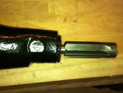

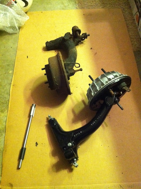

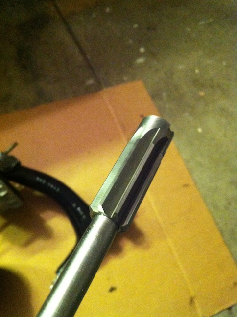

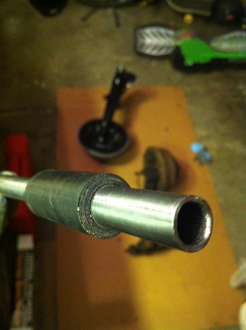

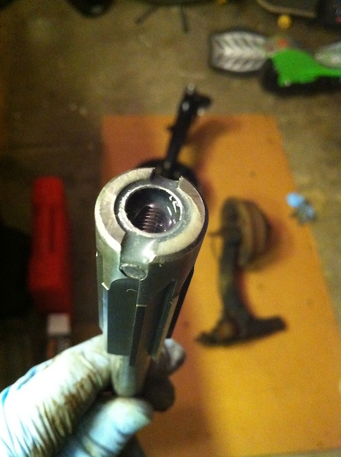

OK, here's my DIY reamer.
Got a 13/16" shell reamer (1/2" arbor, straight flute) on eBay.com for $12... http://www.ebay.com/...9#ht_1339wt_922
Went to my local hardware store (Home Depot... B&Q in the UK) and bought a 3' length of 1/2" diameter steel tube for $7 (tube not bar!). You'll find that tube is straight/true... bar is likely to have a bend in it.
Cut the tube to 12" long.
Having a 1/2" arbor size (inside diameter) I expected the reamer to slip straight onto the tube... not so. Turns out the arbor size tapers slightly at the cutting end, so I had to reduce the diameter of the tube. I could/should have taken it to the machine shop at my work but was lazy... instead I put the tube in the jaws of a hand drill, rested the tube in the partly open jaws of a vice (so it would spin without moving sideways), then while the tube was spinning use an angle grinder then files to reduce the size.
Then slip the reamer on the tube with the cutting end first (this tool will be pulled through the radius arm bush - not pushed through it like a drill).
The reamer has a slot in the rear end of it... I drilled a hole in the tube and knocked pin in to keep the reamer secure.
Then you need to centralize the reamer on the tube (i.e. make sure there is no run-out). Again this was a case of tube in drill resting on the vice jaws... and using a dial gauge to check how true the reamer was mounted. With a few gentle knocks I managed to get it to within 2thou of being true.
The apply some epoxy to hold it together.
Then I wrapped the other end with duct tape... just enough so it would fit snugly into the roller bearing end of the radius arm... i.e. keeps the reamer parallel with the axis of the radius arm shaft.
To use the tool you push the shaft into the radius arm "backwards", then ream the bush by pulling the tool into the arm with the drill.
Some pics...
