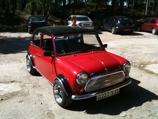

Here is Haggis...a very normal looking Mini...Its fitted with a self built 1380 and is producing a RELIABLE 98bhp...now the thing is I could fit a 7 port head and bump the power up to 140 or 150bhp and still be reliable. but any more power than that and you start to worry about how useable it becomes...I mean, in a mini with the small wheels and lack of weight 150bhp is a LOT of power to get down to the road.
So my point really is this...yes fit a 170-220bhp VTEC or red top or whatever..but will you actually gain any advantage over a 150bhp car..on the road..bearing in mind speed limits and the like..yes on a track the extra power would be needed, but on the road? Im not so sure.
