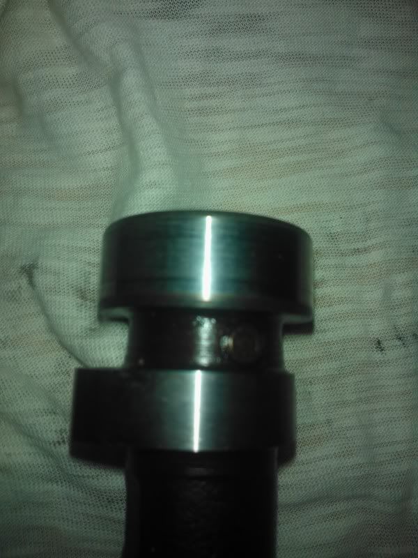

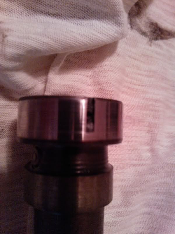

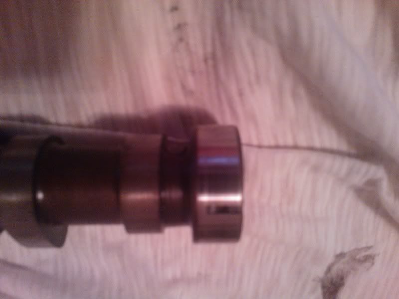

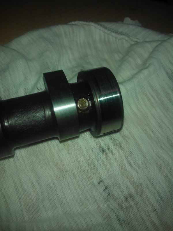

#11 booton
booton
  • 913 posts
Posted 12 March 2012 - 06:38 PM
ok well just took the camshaft out.
cant see any marking here some photos.
looks like a standard one to me.
this looks different to me theres a slot machined in with a hole in. ( not seen this on any of my slot drives.)
#12 03jkirk
03jkirk
  • 465 posts
  • Location: Nottinghamshire
Posted 12 March 2012 - 06:49 PM
those cam lobes look remarkable tall for a standard 998 engine have a look on this site and see what you think

#13 booton
booton
  • 913 posts
Posted 12 March 2012 - 07:02 PM
did some measuring and the inlet 5.81mm ( 0.225,5") lift
ex 5.65mm (0.222". )lift.
that was measuring the both sides 29.10mm on one half and 34.91 on top of lob. which gave me a 5.81mm lift on the inlet.
#14 03jkirk
03jkirk
  • 465 posts
Posted 12 March 2012 - 07:11 PM
what does it say on that web page about those sizes??? obviously you cant measure the duration unless u have it in the engine
#15 booton
booton
  • 913 posts
Posted 12 March 2012 - 07:28 PM
nothing.does match any. but it does't have a std 998 on it.
