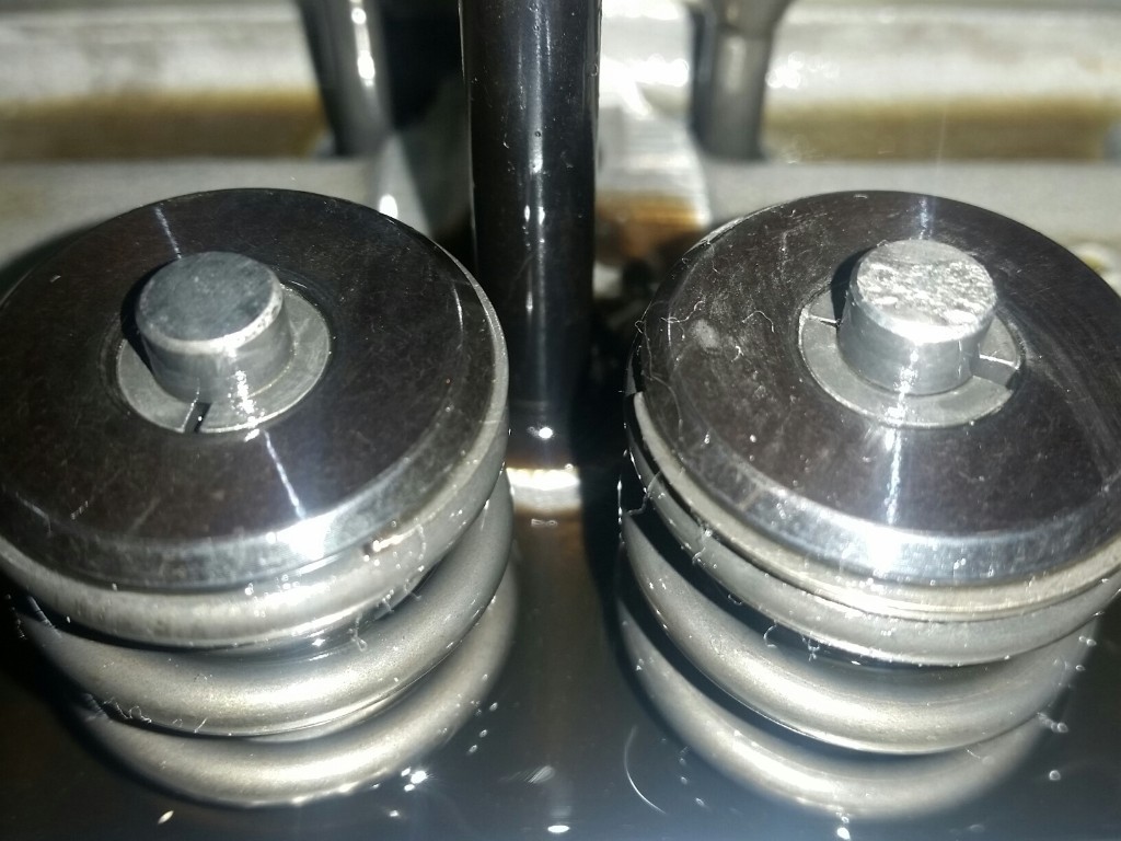

Mal I should've done that before, will get one of those, thanks.

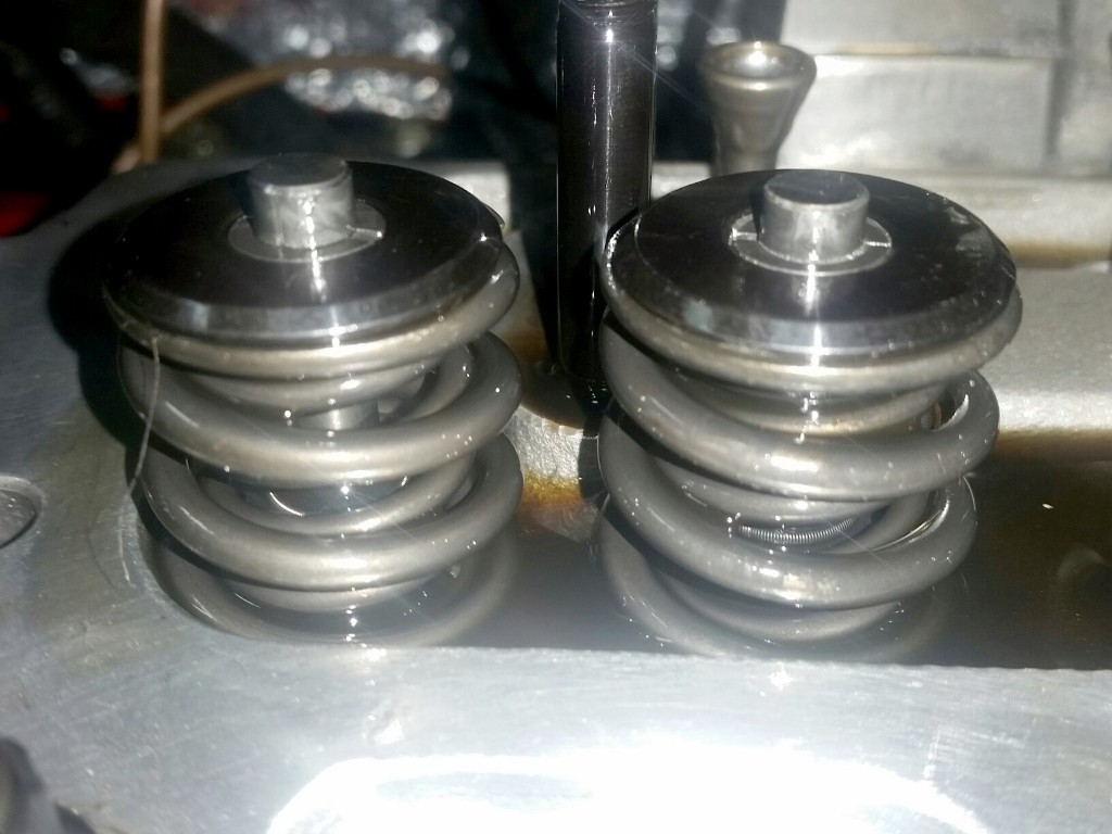

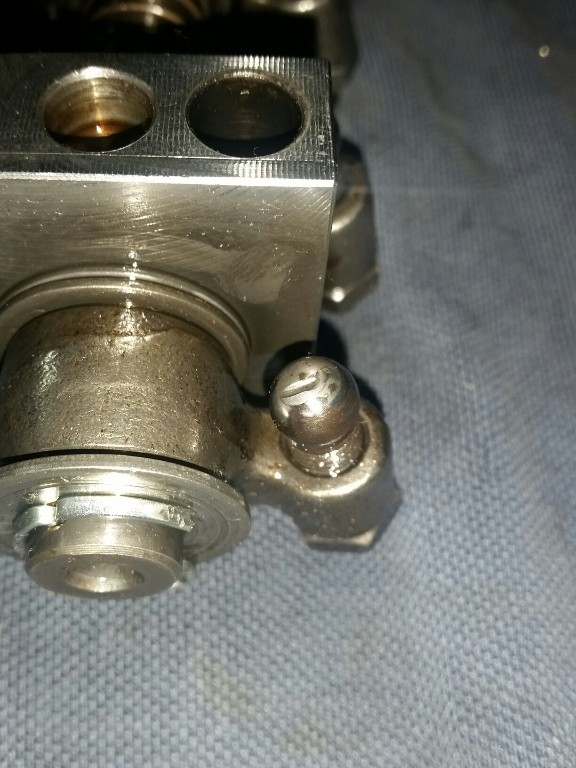

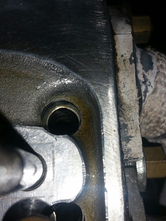

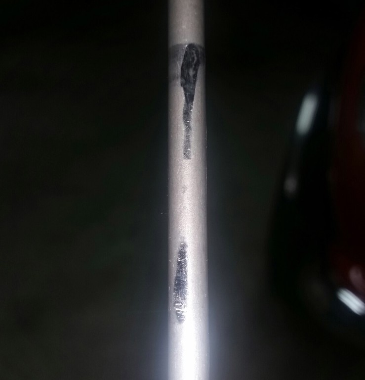

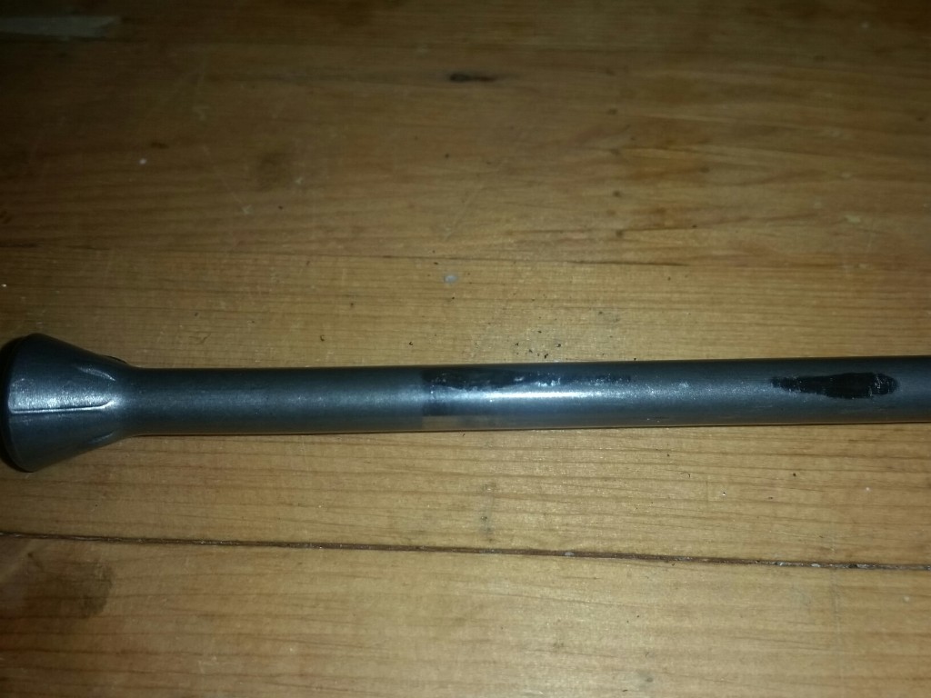

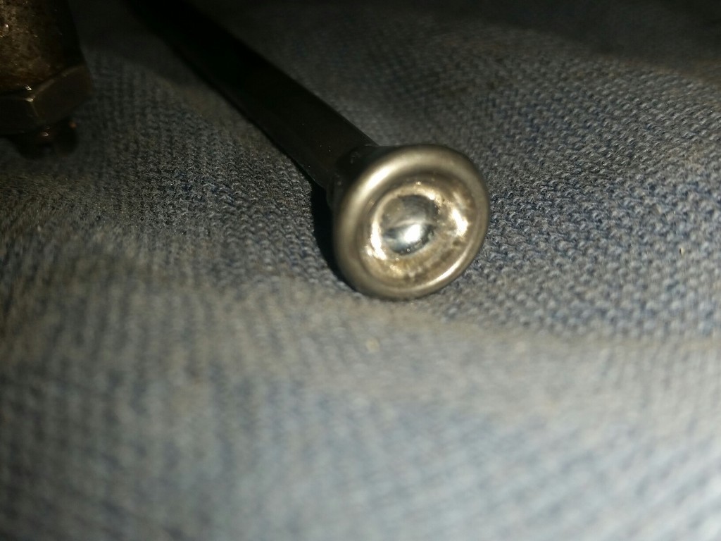

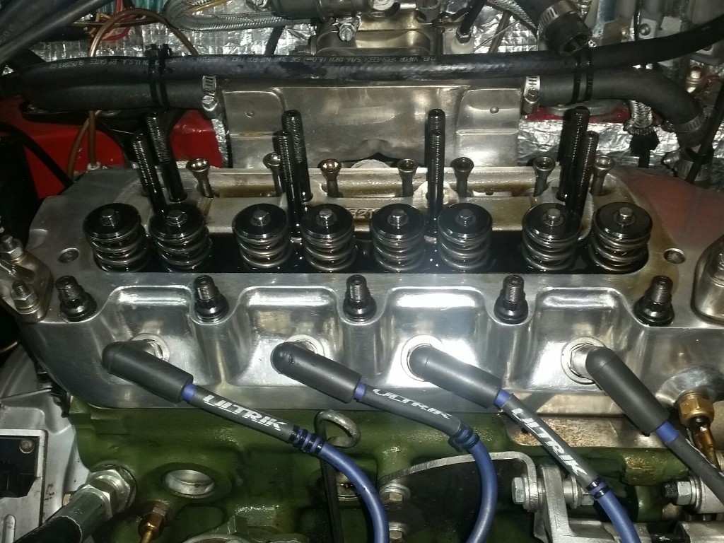

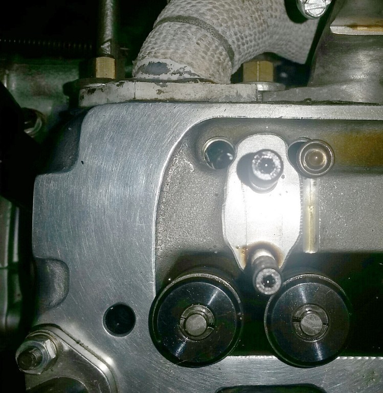

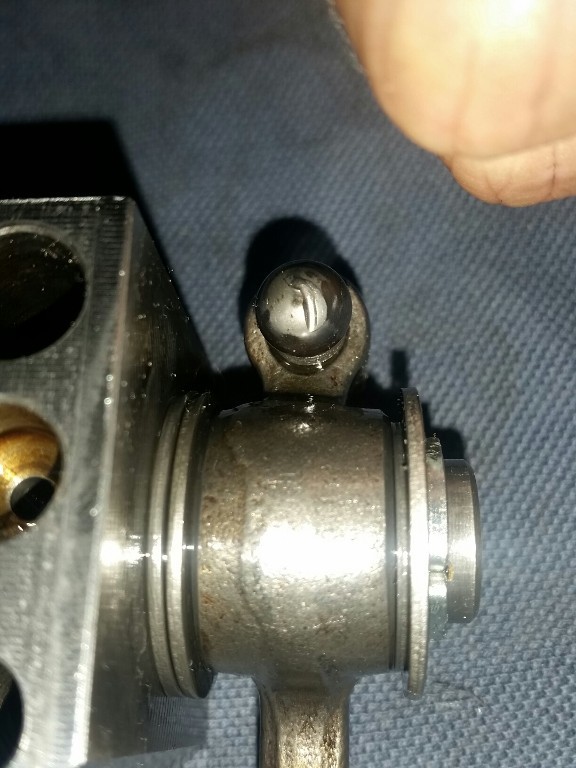

A friend told me to take off the rockers and look for big divits in the faces and stems.  There weren't any here, but we may have a smoking gun here at #8 pushrod.
  • Note the groove in the adjuster screw ball on #8, but can't tell if it was worn in, or a manufacturing defect.
  • The closeup pic looking down on the head, note the hole for #8 has a small wear groove on the side farthest from you.

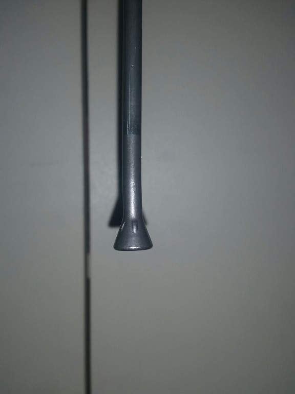

  • #8 pushrod's cone end is so bent it wouldn't stand up.  Note the polish marks on the side.  Couldn't see any damage around the cone.
  • Note the pitted stem face on #5 valve.  You guys tell me what that means.  The rocker face is clean - they all were.
8D911CB8-188B-34B5-0717E03A5F933FC3.jpg8D913AE2-188B-34B5-07496211A9EBEE30.jpg8D9197B1-188B-34B5-07A8F8454883E3D2.jpg8D91BBF3-188B-34B5-079F7ECDC138154F.jpg
#28 dklawson
dklawson
  • 10,923 posts
  • Name: Doug
  • Location: Durham, NC - USA
Posted 08 November 2014 - 12:01 PM
Yuck.  I wish this were not your daily driver.
The galling on the ball end could have been caused by several things but my gut feeling is that the particular arm became bound up perhaps from a valve spring that was fully collapsed at max lift.  The bent pushrod suggests this also.  That may have contributed to the damage on the end of the valve stem.  I doubt any of this was related to a manufacturing defect.  I believe you said this was a MM engine with 1.5 arms.  If you put the rocker gear back on (excluding the obviously terrible one and its pushrod) and turn the engine over by hand, how close are the valve springs coming to full compression?
I would still be hoping for a solution that involved less than a full rebuild.   As such, I would consider taking the head off and having a machine shop go through it completely.  Have them check all the valves and replace those that are suspect.  Perhaps the valve guides are also tight.  Prior to re-fitting the head, source a set of standard ratio arms.  You can buy standard length forged arms but they will be expensive.  If you can find a set of stamped arms they will serve you well until you decide you want to do something different.  Obviously get a new set of pushrods.  Any binding that may have caused the one pushrod to bend may have affected the others.  Hopefully that same damage has not been transferred to the cam lobes and lifters.  With the head off you may be able use a retrieval magnet to pull the lifters out to inspect them and the cam lobes.  (Paint mark the lifters so you put them back in exactly the same spot... don't mix up their order/location).

Posted 08 November 2014 - 05:49 PM
Hi Terry - thanks for the offer, it may be my only chance to make the Santa Cruz run tomorrow.
Doug, Lance pointed out an interesting theory last night, this is from my post at MM:
There are two things going on here:  First, the pushrod was running up against the side of the pushrod hole and second was whatever made it do that.
Lance noticed the offset in the Pierce head between #8 stem and the pushrod hole.  As you can see in the looking-down pic it's over .25".   His theory is that the shimming on the rocker was done to favor it to center on the valve, not on the pushrod.  This positioned the pushrod right up against the hole - towards the passenger side.  But if you shimmed the rocker to center the pushrod in the hole, then the valve stem would be off-center on the rocker.  Notice the two shims on the inside, positioning the rocker out towards the passenger side to do this.
So the outside shim wore slightly over time and the pushrod was already right up against the hole, and you can see the polish marks on it.  The pushrod's bend is only around the cup area.  I think it's because at max lift the cup/ball contact area was so offset it was squishing it even harder against the side of the hole.

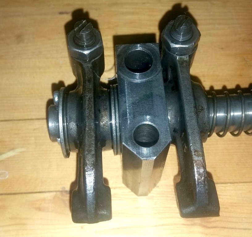

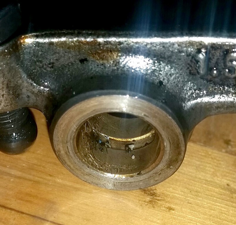

Notice the Dodds rocker (1 year old) bushing oil groove full of sand or glass bead that was left in there during assembly, and what a great job it did scoring the bushing.
