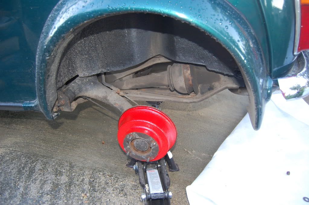

Took me about 2 hours to to the rears
Old stuff - with shock removed, (fuel tank out to do this bit)

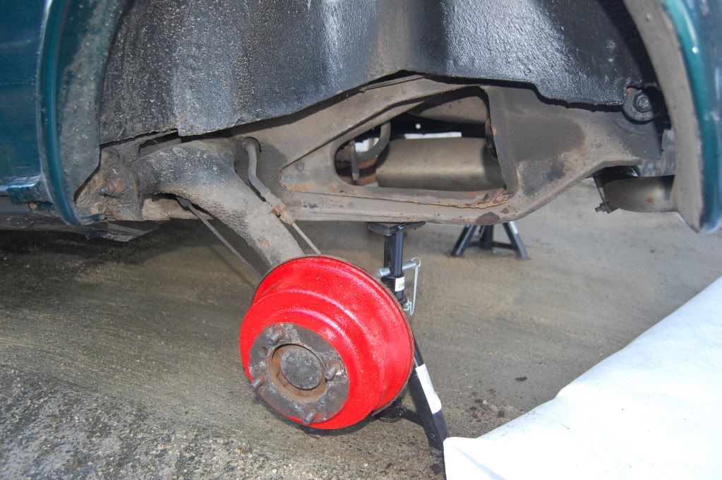

All off

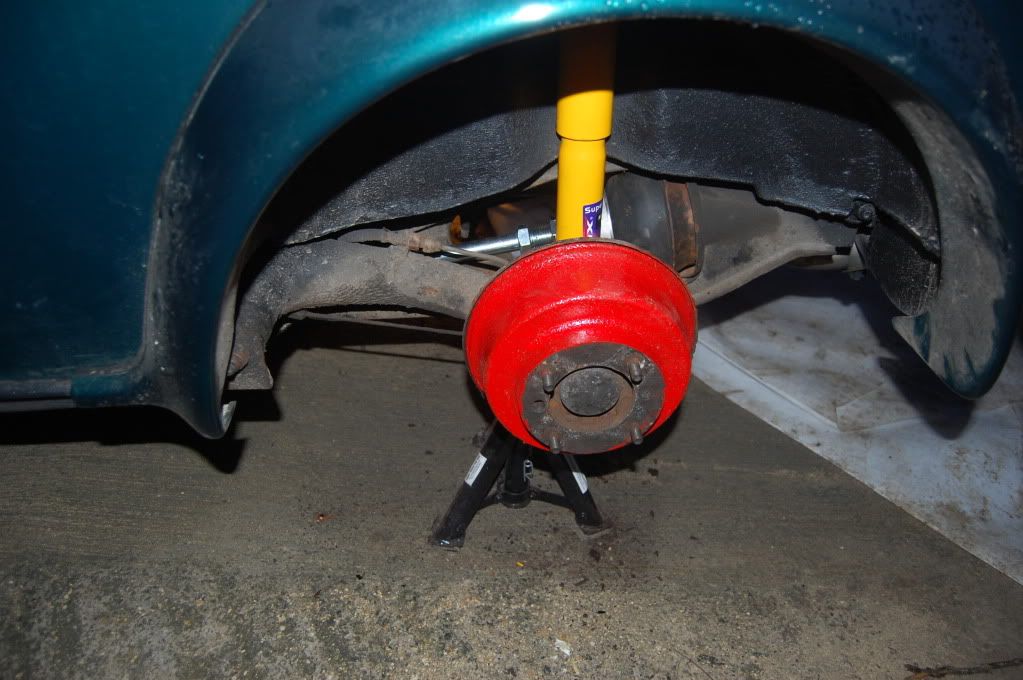

Back together - with new shocks fitted and fuel tank back in
If you have a haynes follow the guide in there or I am sure there are lots of threads on here, the hardest bit will be getting the seized nuts undone, start soaking in wd40 or similar as soos as you can. I would do it all together, cones and Hi lows, then you only have to do it once.

You can see from those pictures how the Hilo fits, cone shaped thing that is mounted in the subframe thats fitted to the rubber dohnut moves back and forwards as the radius arm moves up and down, the bottom pic you can see where the trumpet (cone thing) was a silver threaded bar and a nut, thats a hilo basically an adjustable trumpet, what you said attaches to the radius arm and mounts up into the wheel arch is a damper which damps the springiness of the car.

the spring comes from the rubber dohnut seen in the first pic as the black dome, the bar thats attatched that goes to the left where the radius arm is moves left to right pushing on the dohnut, the damper is what goes up and down from the radius arm into the upper wheel arch which does what it says on the tin, damps the spring, the ride height is controlled by the length of the trumpet or hi-lo which ever you have fitted
