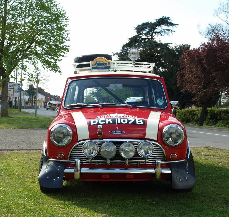

Or Dicky
......http://www.silverstoneauctions.com/1969-austin-mini-1000-mk2-to-cooper-s-monte-carlo-rally-spec
What do ya reckon Surf?

Most of my views on claimed Works replicas can not be published on the forum. Why not just say it's a rally car. That car looks OK and for the estimated price looks very good value for money as it probably cost a lot more to build. If I was in the market for something to use on rallies this could be worth buying, but the car would need to have the roof painted black and the bonnet stripes and roof rack removed.
