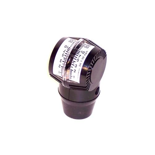

I have them sync'd using one pictured below. both carbs are at 5 at idle.

I'll tune that at idle first again first.
