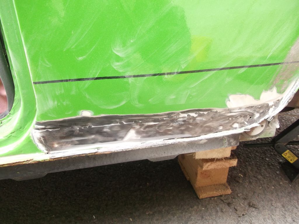

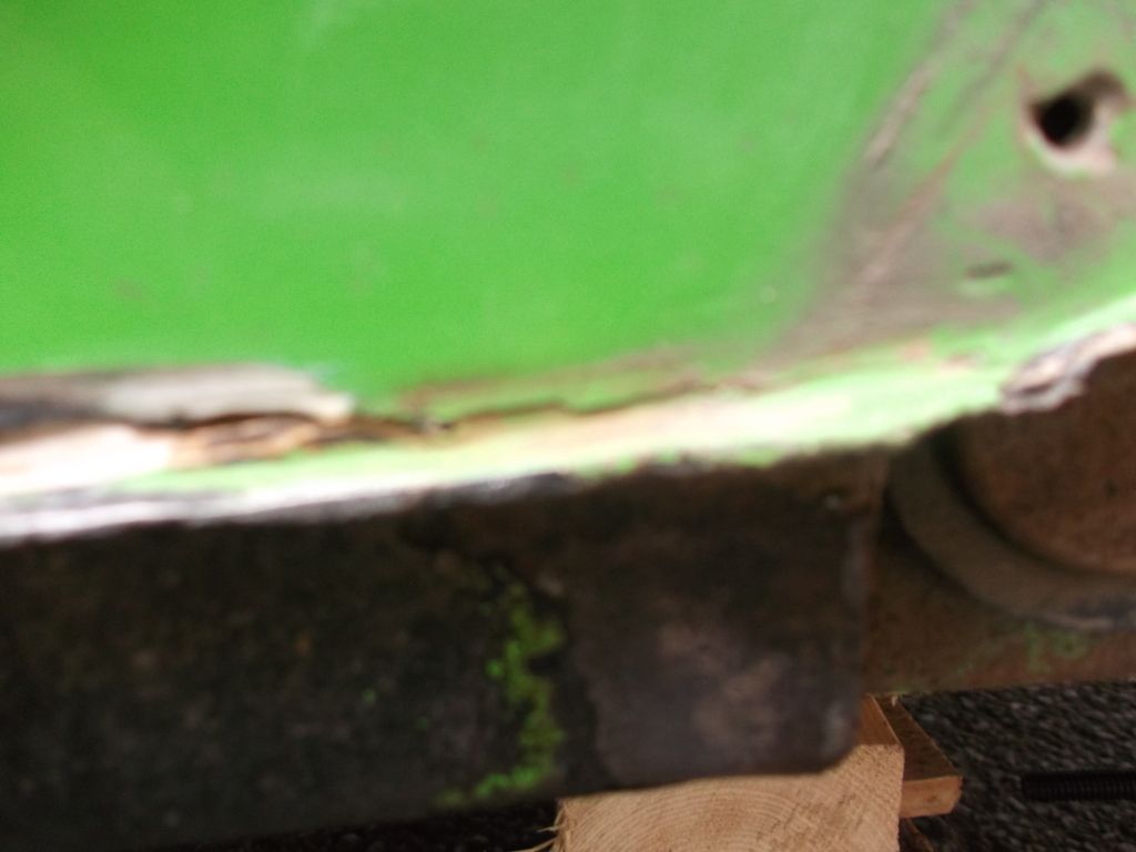

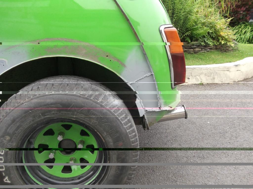

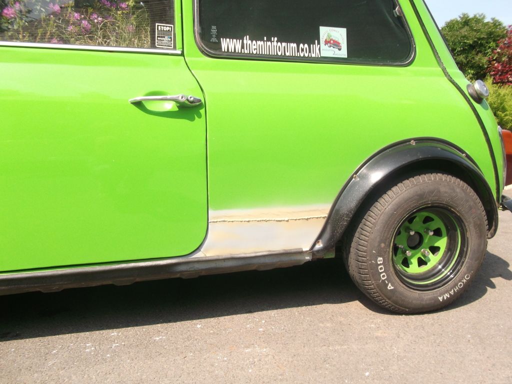

Hi people thought i would start up a thread for my car as i went at it with a grinder this afternoon :(. Its not really that bad just a few areas around the back of the car that are getting on my nerves so i decided to start with the passanger side rear quarter. It had cracked along the bottom were the sill trim sits and had had dodgy half inch thick filler repairs done by the previous owner :@.
So first thing i did was remove the wheel arch and sill trim then attack it with the wire wheel covering everything in white dust including my dads Porsche >_< Didnt need to worry about the interior as i have no rear seat :proud:.

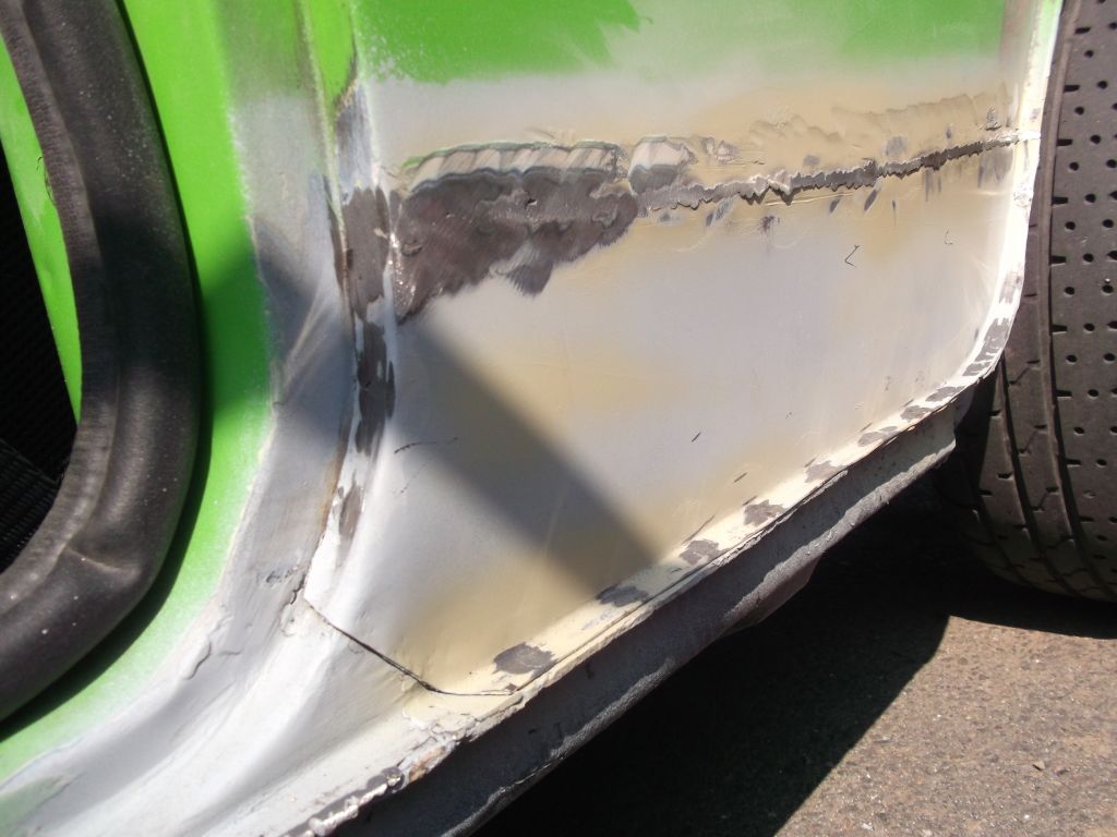

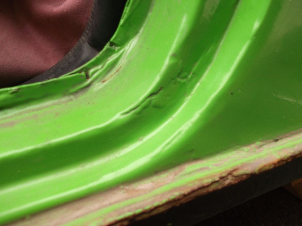

Here you can see the crappy plate welded over the top on the rusty original panel >_<

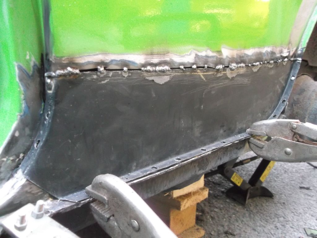

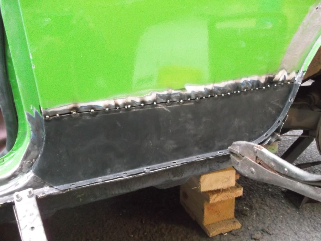

Cut it all out and welded a new piece on the corner

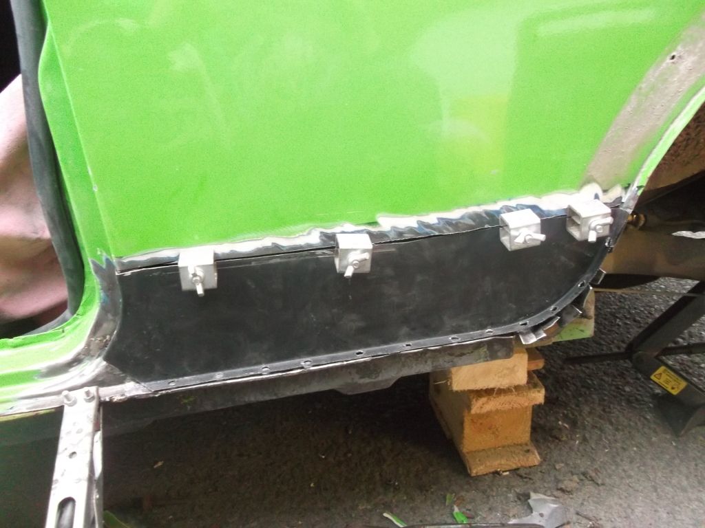

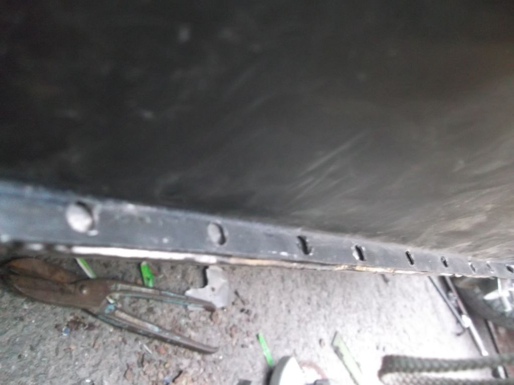

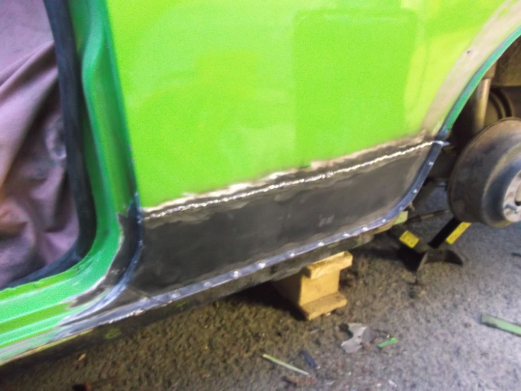

Clamped the new panel in place after drilling all the plug weld holes and making adjustments. then began tacking it in.
To avoid getting heat distortion tacking and allowing it to cool down was the best way to weld the join up but this dosent look as pretty :mmkay: but oh well its solid.

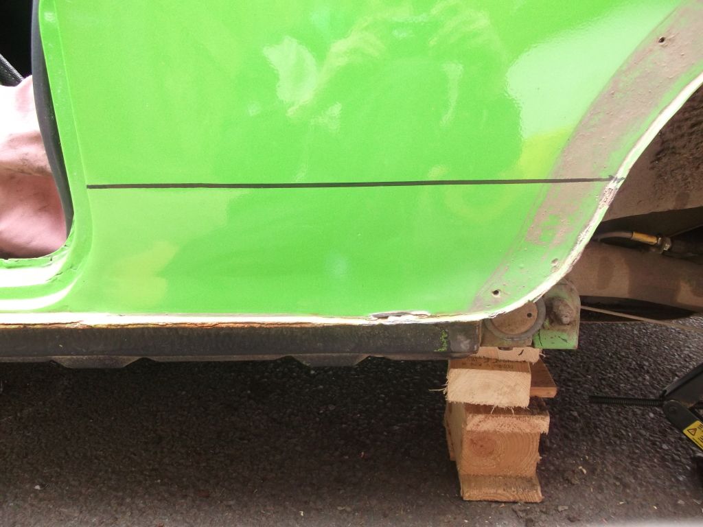

Got the area in primer and put the arch back on so i can still use the car while working on it. i will update this when i grind down the welds and skim the panel

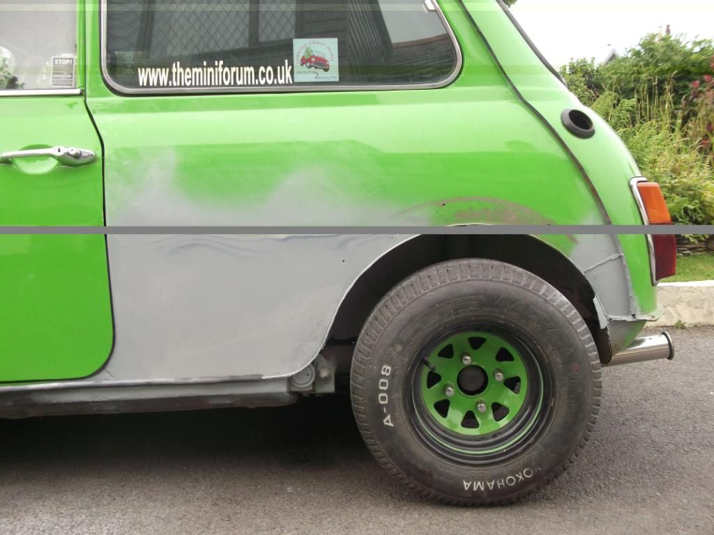

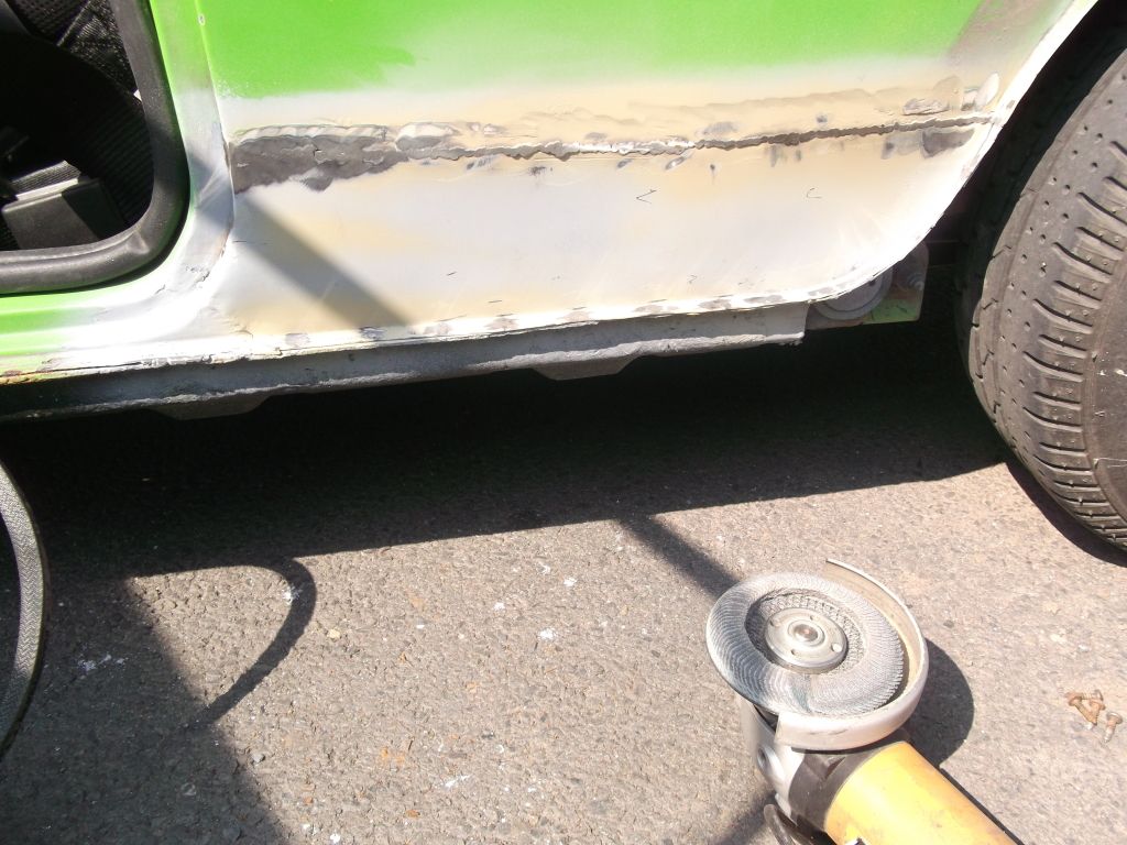

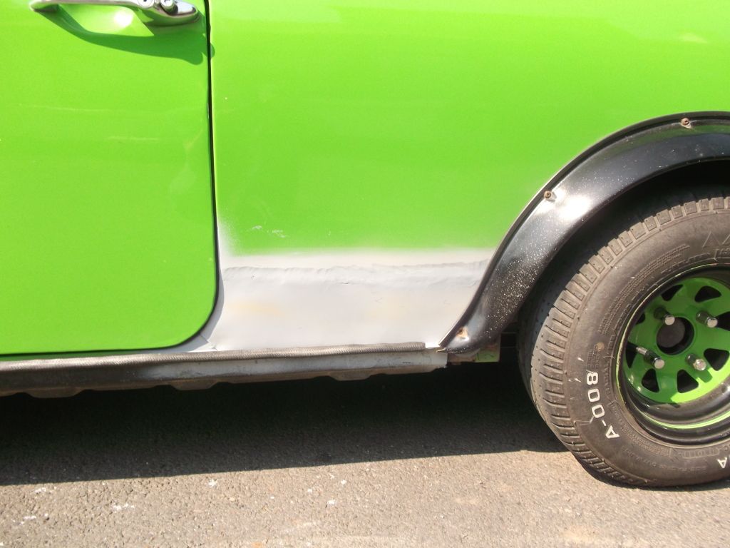

grinded all the welds down this afternoon took a while as i dont like to get it to hot as this can also cause distortion in the panel :lol:
pic of before i started
i was using the flap disc on the grinder as it is much faster than a grinding disc and dosent generate as much heat
And here it is primed untill i do the finish this side.

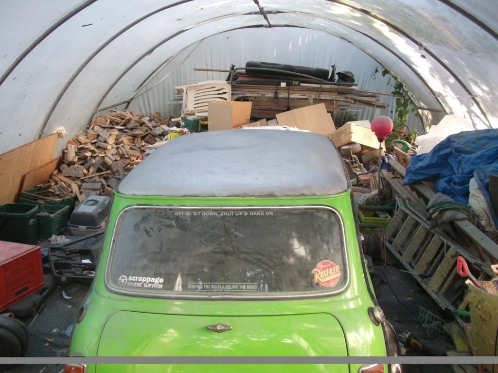

Right so i got the car round to the poly tunnel to begin bare metaling the roof. Had to take it over the garden wall with the aid of blocks of wood but it grounded out and ripped my brake line :( so that will need doing when it comes back round.

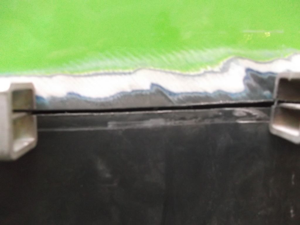

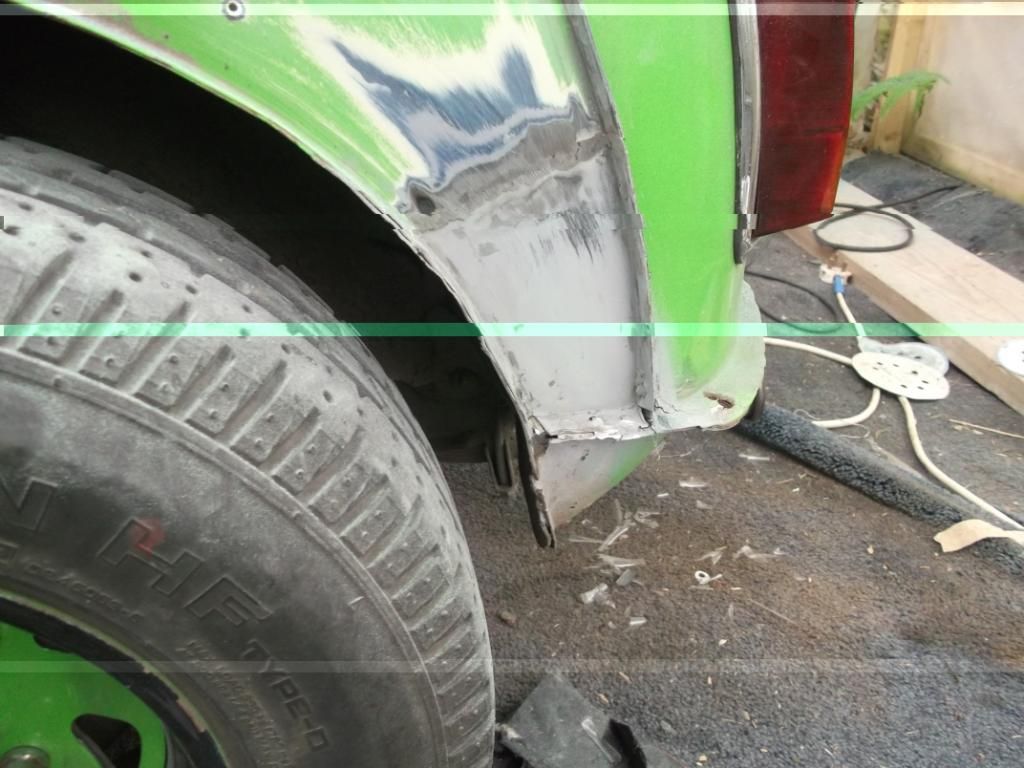

First thing i did was the repair to the rear of the quarter panel took a few days as i had to borrow a belt sander from college as the grinder dont fit :/
ground it down

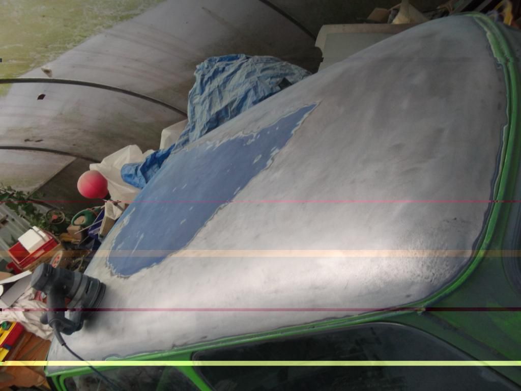

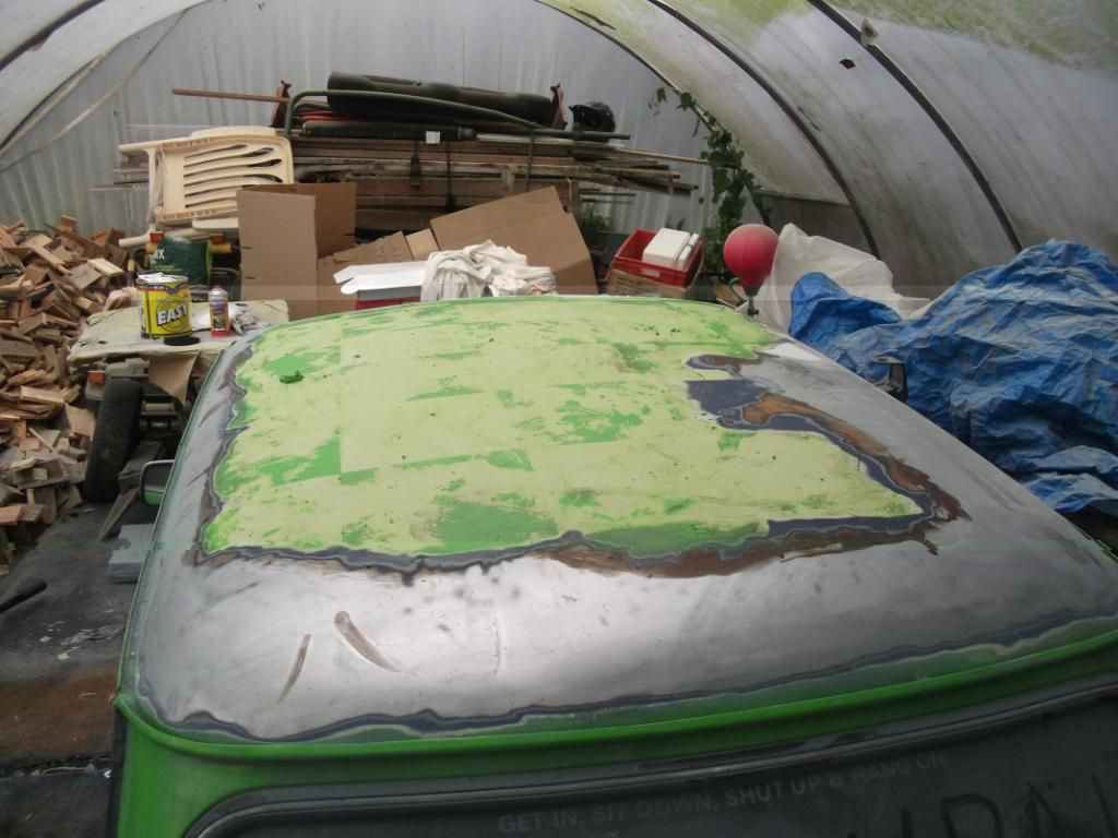

Then i started on the roof. It was quite fun peeling the checkers off along with the laqour. But it was not fun DAing the roof down as the centre vibrates qite alot making it harder. i worked my way from the outside-in and even tryed paintstripper but that only removed the green the blue is hard as rocks and thinners dont even touch it !!

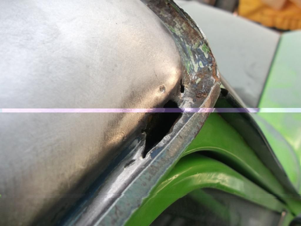

and here is the hole i need to weld up! already welded the Arial hole up

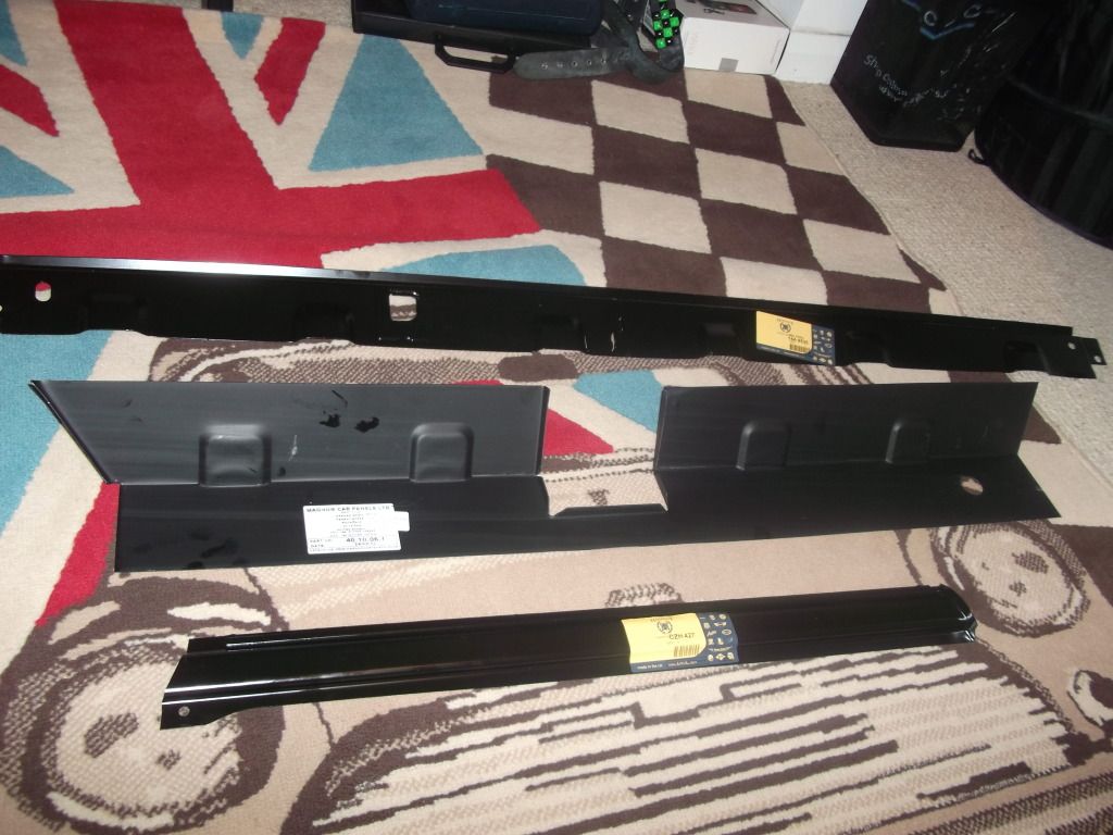

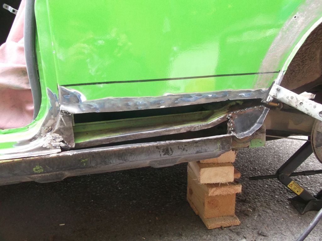

Got some panels through in the post today! passenger side genuine sill + inner sill to get rid of the nasty over sill and the passenger side window waist rail :D
