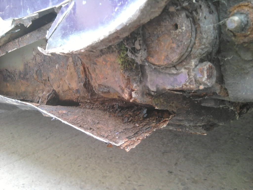

i peeled my oversills down by hand.... the welds were not connected at the top and the originals were totall gone and the inner sills ******* too..... i can only find a pic of the heelboard end.......

mini_in_progress
  • 641 posts
Posted 05 June 2012 - 09:04 PM
found one a bit better.....
