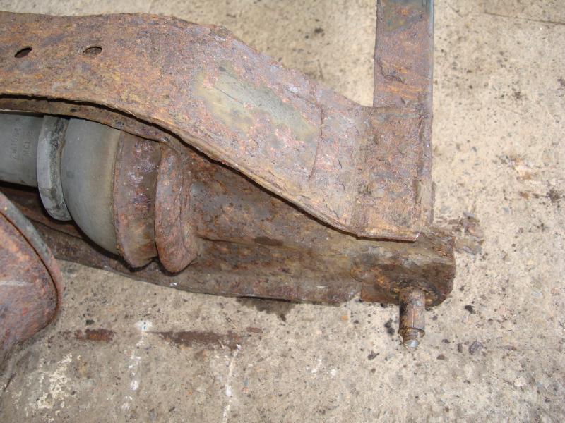

Rear subframe, fairly rusty but pretty solid....ish! O_O
Attached File  DSC04657.JPG   91.24K   16 downloads
Annoyingly i Sheared this nut of the end, whats the way round this?

Has anyone got any ideas on what to do with this sheared bolt on the rear subframe? Iam looking at a kit form minispares, but i dont think that bolt is included. Is the bolt welded in, and is there a way of replacing it?
Kind regards
Rob
#3 charie t
charie t
  • 3,153 posts
Posted 25 June 2012 - 06:19 PM
you want to use that subframe again but with 5 times the original power?
A new subframe would be the best option. If you must take the difficult option the cut it flush, drill it and tap it, zap it in with a decent weld.
There is no repair section available because a new subframe is the easier option

Good point, the subbys not too bad but i see what you mean about the repair. Would need to be dead centre aswell. Will look into a (better) second hand one. Thanks charlie!
