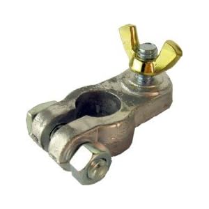

The type that James posted in his link work but of course... they are in the boot. The brass ones also have a reputation for falling apart after a while due to vibration. I don't mean unscrewing... I mean breaking. A less expensive alternative for a disconnect at the battery is to buy a marine battery cable clamp. They typically are small, made of lead, and have a threaded stud to receive the battery cable. A heavy wing nut secures the cable to the cable clamp.
The link below is for a marine battery terminal.
http://ecx.images-am...L500_AA300_.jpg

It seems a lot if hastle having to screw that on every time... I would have the key type in the boot or one like James has put forward, my only concern with this would be a bad connection. Would it be easy to put a key type in the boot.
