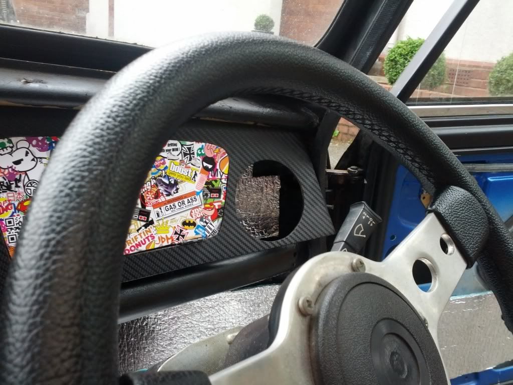

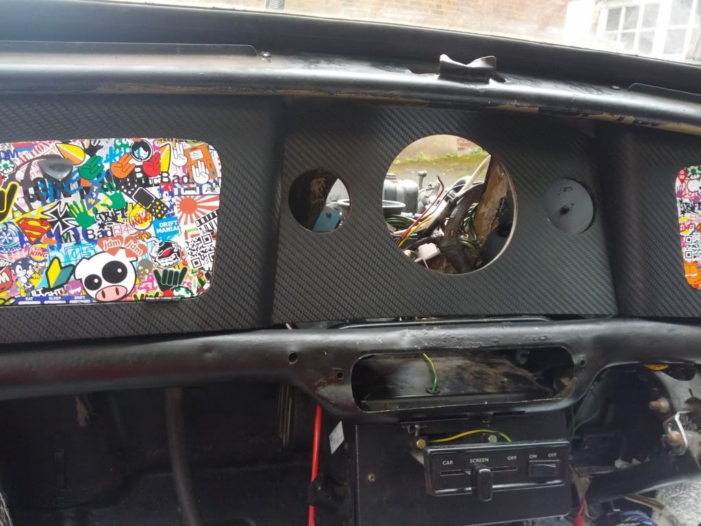

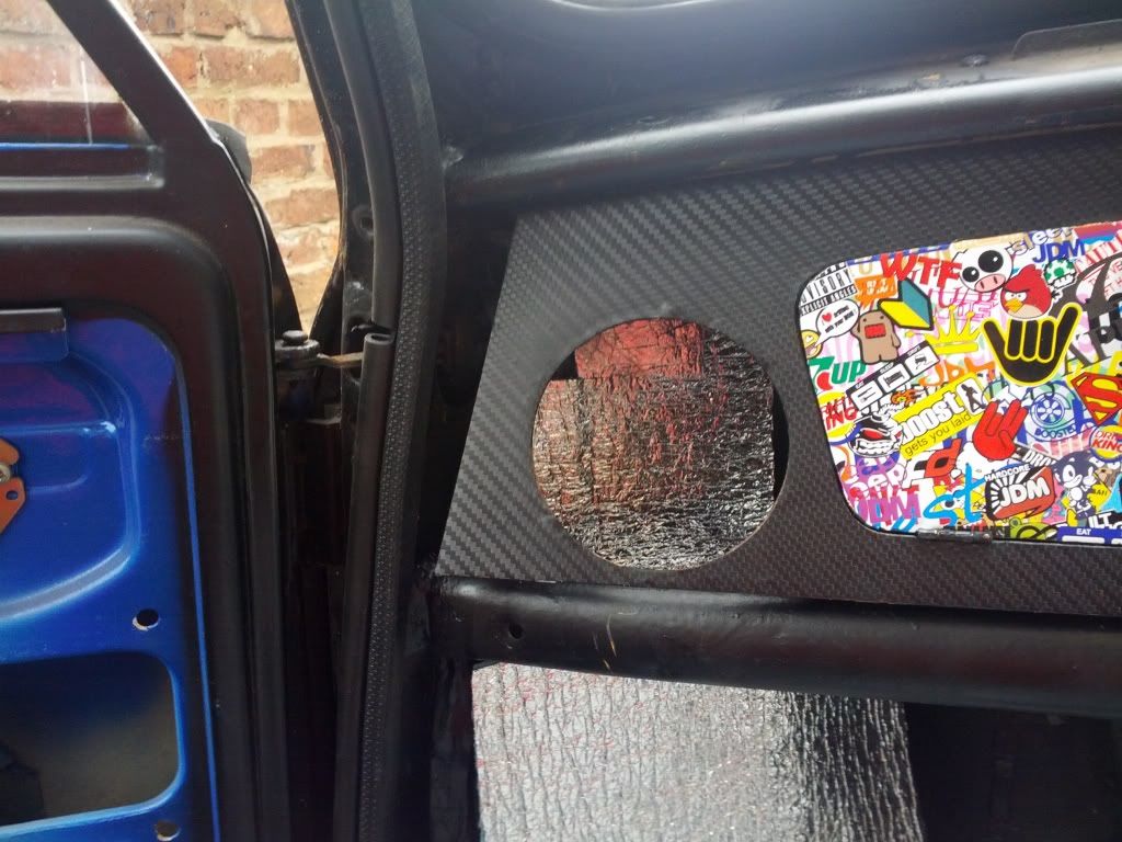

here's now it sits in mine at the moment
Obviously the speedo would be there but it comes through the hole from the back so its not really holding the dash in place at all. Was thinking maybe some 'L' brackets on the wings and securing to the pillars both sides??

sorry pal can't help you here...but it looks like the side parts may need to sit flush with the front of the dash rails ?

Yeahh i thought that, alomst like it needs to be angled more like this \ not | i will see again tomorrow :D

and shouldn't there be some finishing material at the ends to fold under the door rubbers to finish the ends off ? and maybe you have to wrap the dash rails first to close the gap at the bottom under the clocks ?

i think you need to create two flat surfaces running straight to the bulk head from the upper and lower rails...some black carpet should look tidy :D

Hope i am not missing the point, if i am, sorry, i have a stainles steel dash well skin on mdf, i had to trim with a small plane, but mine has bolts sticking out of the back, the dash sits on the lower dash rail and under the top dash so it fits from the front not behind, it has metal strips at the back that go behind the rails
and then butterfly nuts to tighten it back, as the photo above and the angle of the ends, this will put the angle right as from the photo it is to far back
