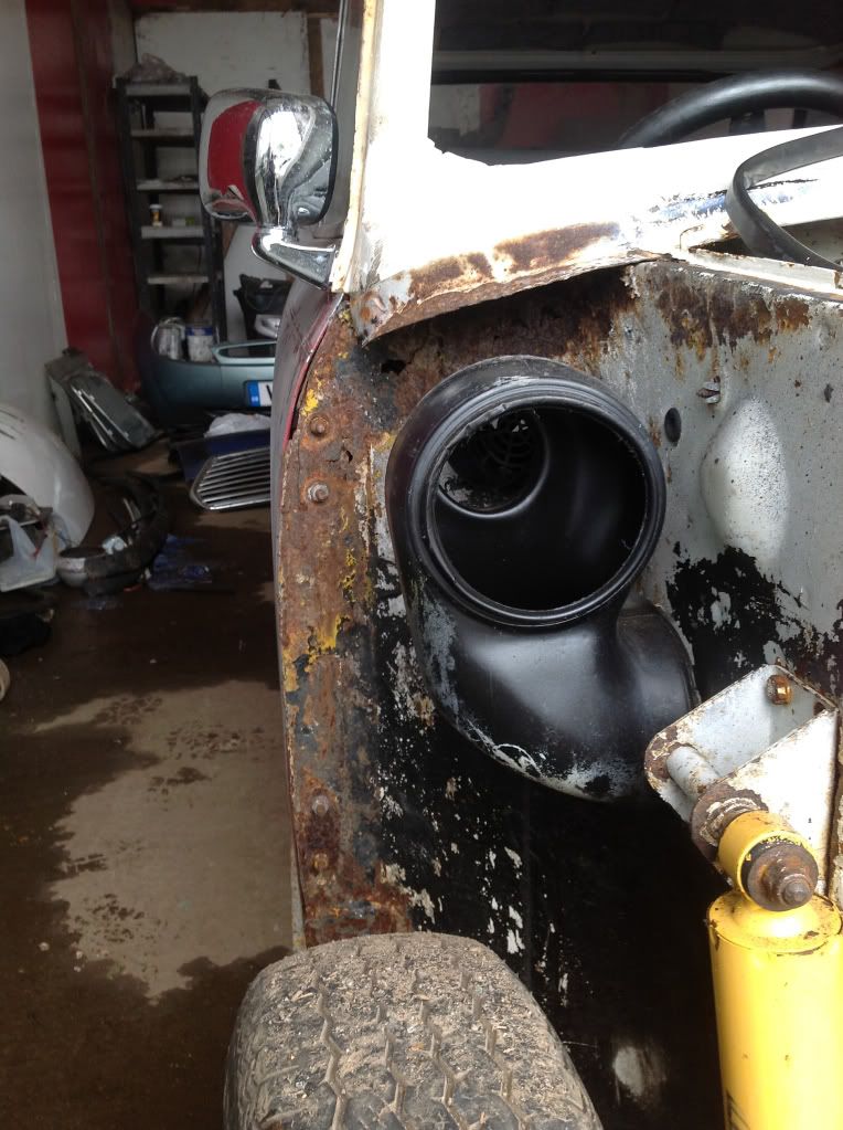

I would replace the A panel as a complete panel. That particular area will have rusted from behind the flange which invariably means there will be rust on the flitch flange that the A panels wraps around.

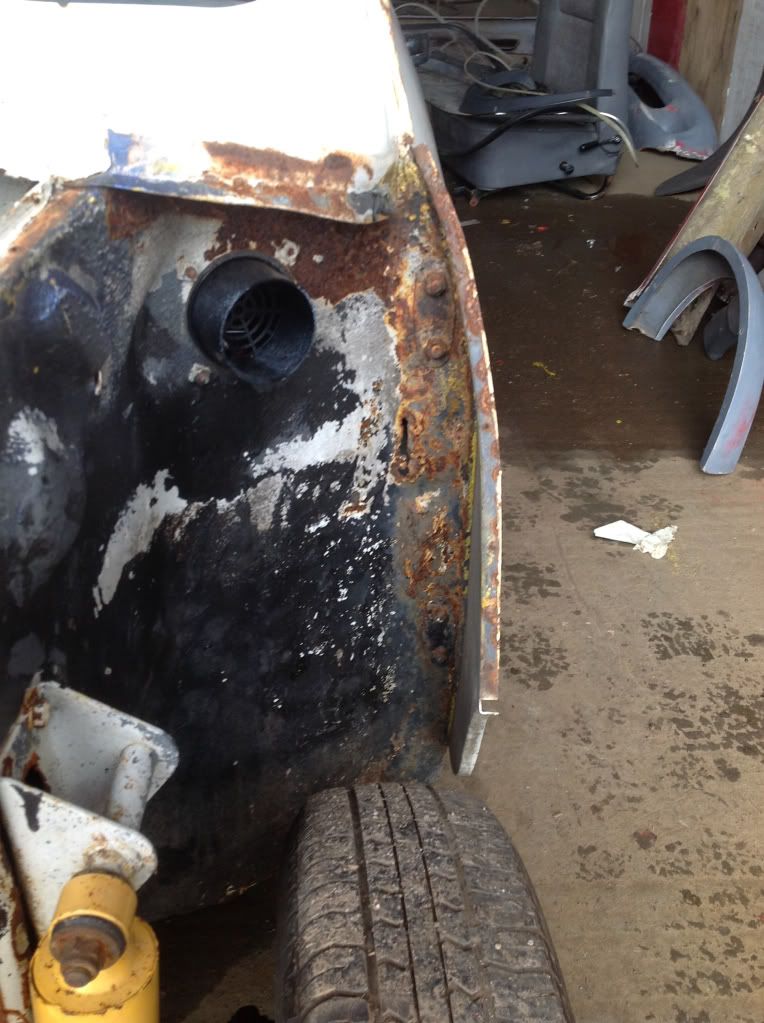

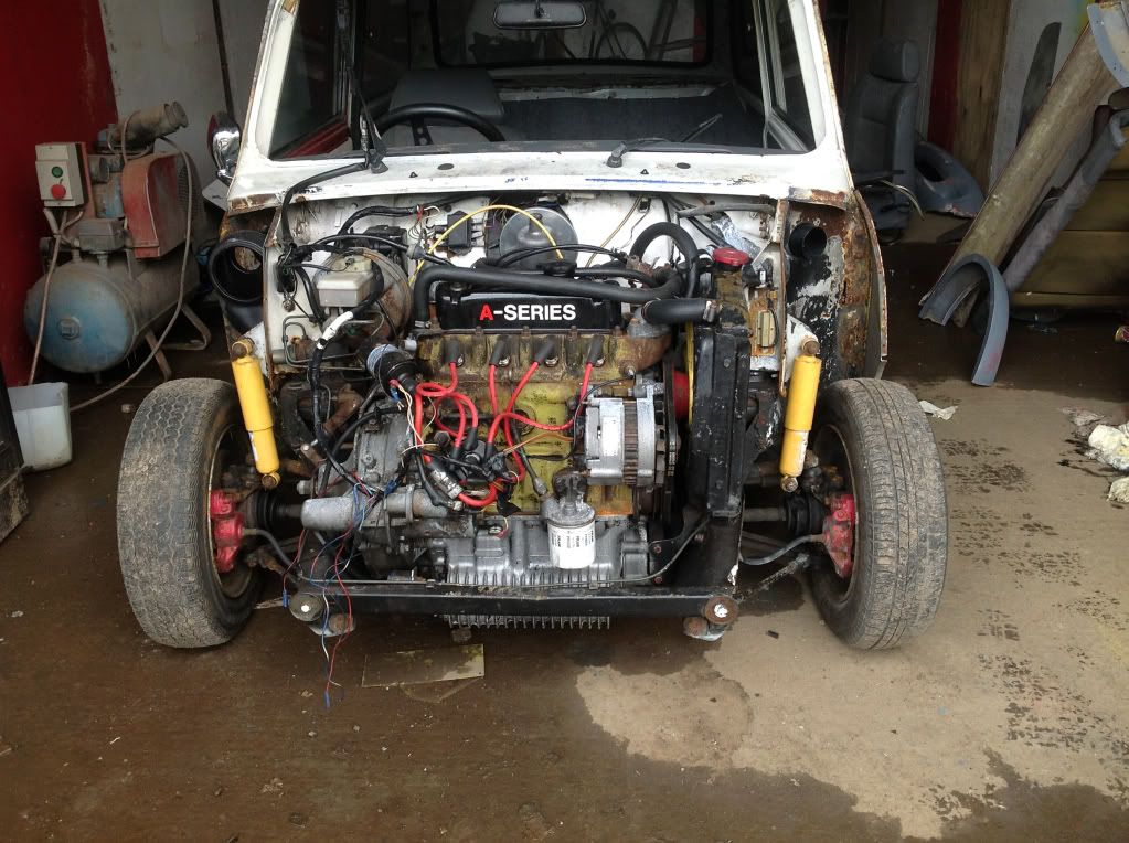

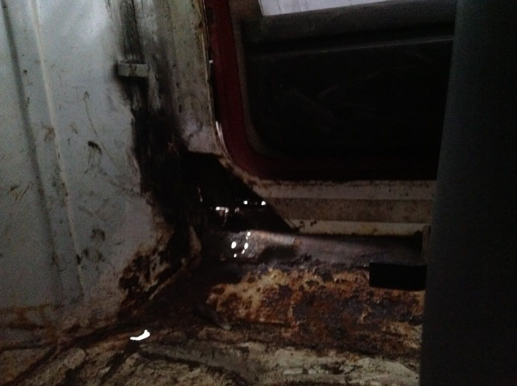

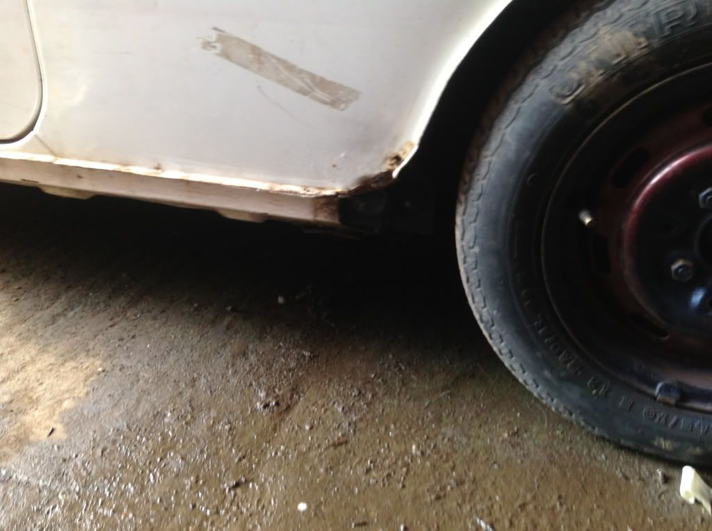

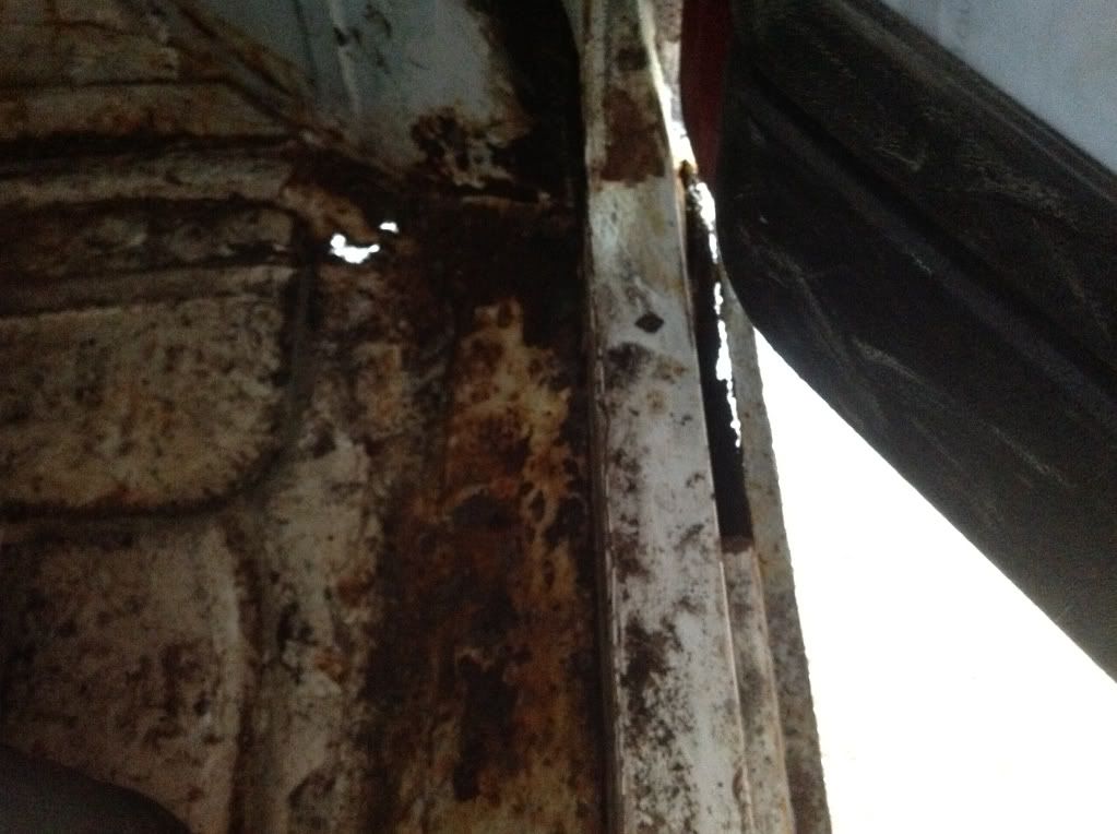

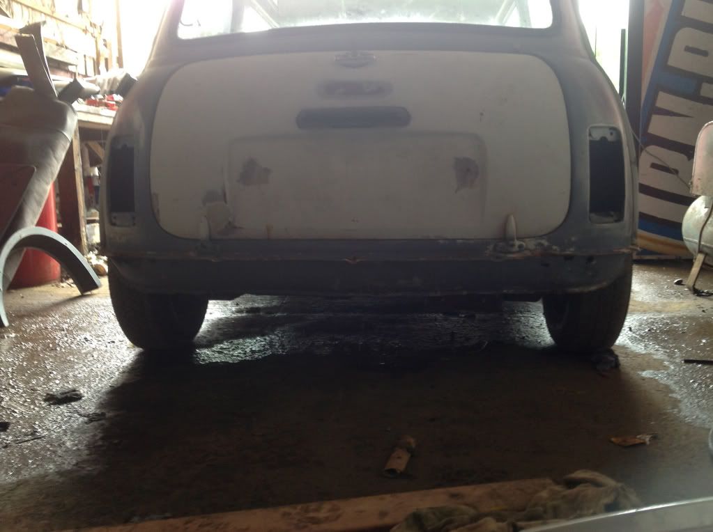

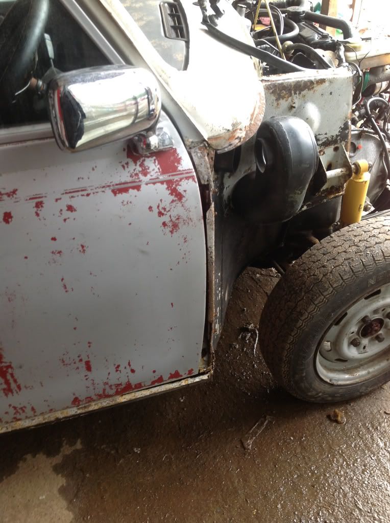

a post ? rather than me asking plain qustions shall i take pictures of all of the rust over the car tomorrow and then you will have detail on what needs doing
#21
Posted 17 July 2012 - 08:55 AM
Here are all of the photos around the car which has rust
On the last picture it is rusted on both sides.
If someone could tell me what I need to buy that would be brilliant.
Cheers
Cheers
Edited by crf150, 17 July 2012 - 09:23 AM.
#22
Posted 17 July 2012 - 08:12 PM
Ok starting at the front. You will need two flitch repair panels. The ends of the scuttle look crusty as well so they will need to be done as well. Underneath the ends will be two closeout panels one each side so that will need to be replaced as well. So both A panels will need to come off.
The inside next, you have issues with both sides with the inner sills. so they will need work. If there is any bitumen sound proofing on the floor that needs to be stripped off to see the extent of the damage.
The rear quarters look like some small localized repairs need doing so nothing too bad there.
The rear end looks like a new rear valance is required, have a look in the corners on the inside to see if the valance closeouts are crusty as well.

You may need this panel from M machine for the inner sill and floor pan, possibly on both sides

thanks for that. for the rear end i only think that i need the valance the holes that you can see is all of it. i thought that it was going to be a lot more than that to get the parts needed. i hopefully should get them in the next week or so, so i will put pictures up then but other than that i will still keep posting.
