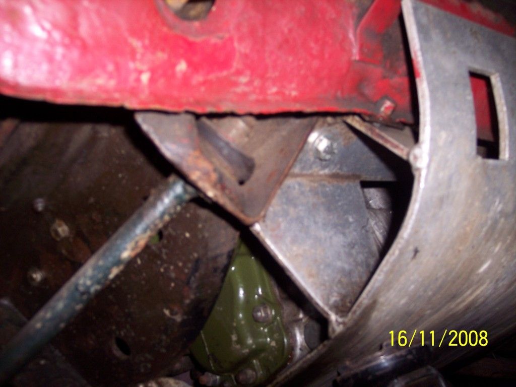

i would advise reinforcing the front tie bar mounts while the subframe is out
Like this:

Ya i was gonna do that as this subframe cracked there

That's a 4 mm thick piece of steel plate used to make a triangular reinforcing.
