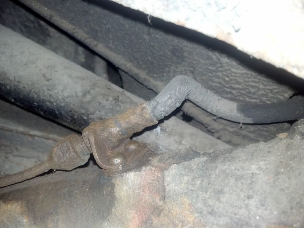

So, i was in the process of swapping the brakes from stock rear 1973 MINI 1000 brakes to MiniMania's big brake kit or whatever...
So, long story short'ish, i was try to separate the brake line where it hit the wheel cylinder/drum and since it is a bit rusty and i am unlucky instead of just the nut getting lose, the brake line twisted and it tore a small hole before i noticed :( It is just a small hole :D
I have two main questions...
What should I do short term? (patch the hole, disable rear brakes, or ________)
And what should i do long term? (Cut the end off and add a new flare, make/get a new brake line, or ________)
I am concerned that if/when i undo the connection from the rubber brake line to the metal one on the suspension it will give me troubles as well.
I do have a flaring tool kit (never used it though)
The nut is quite rounded, so it is a good idea to replace it. (Vise-grips work well)
Thanks for your time

Your good health depends upon your brakes working properly so don't mess around. If the brake pipes are rusty they are already overdue for replecement. Throw them all away and fit a new set of brake pipes immediately.

Brake lines are cheap, replace it.

Replace it all, dont drive it with a patched brake line, wont work and you'll end up in a wall or something similar. As above you may aswell replace everything if its rusted, better to have well maintained brakes as they do stop you lol!

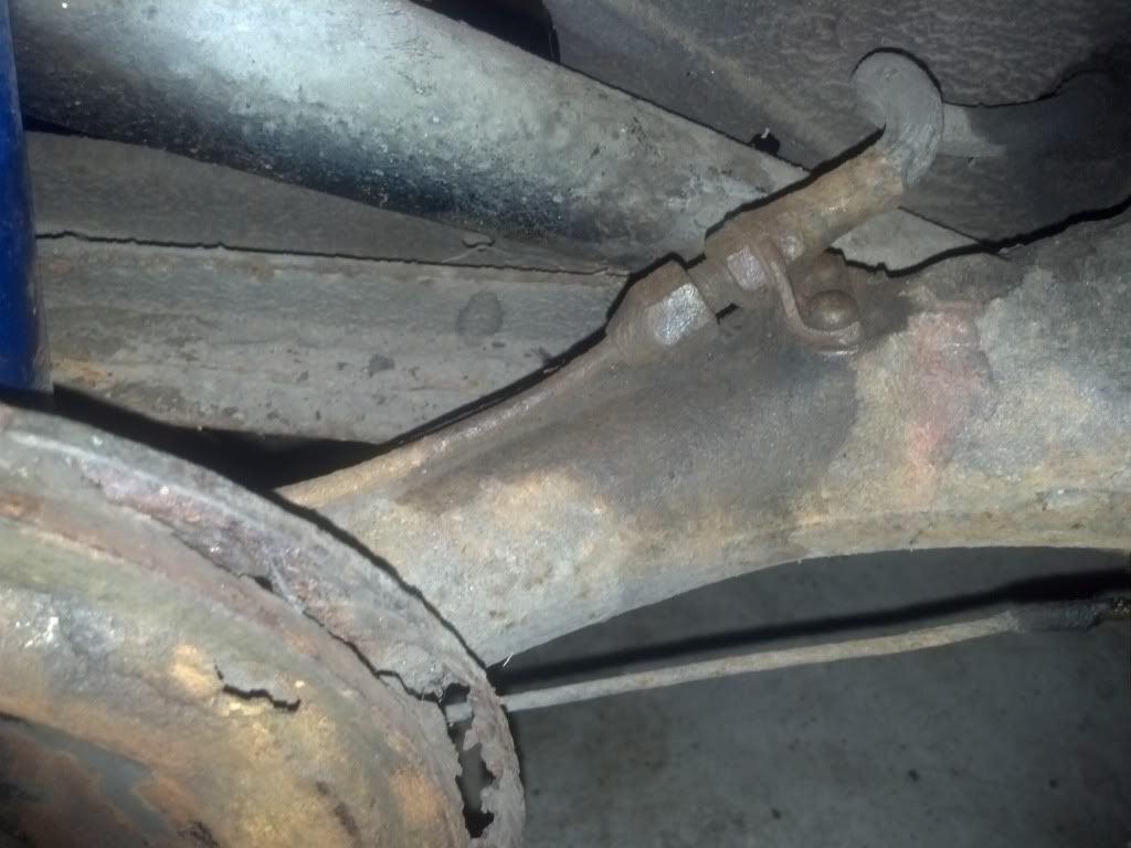

So i should replace the metal pipes on the suspension then. (both sides most likely) should i try to bend the pipes myself or hope a tractor store (i live in a farming area) can make some from me if i bring mine in?
Minimania does have the have the rubber lines for $14 USD (9 quid) each which isn't so bad, but then i have to wait on the post again :(
Also, how bad is it that the back plate is rusted through in spots?

The brake lines are completely rotten and you should replace the lot. The backplate also is scrap. I would expect that the wheel cylinders will be too far gone to be safe too.

I'll put back plate on the list to order. Most of it isn't that bad, but enough of it is. It mostly keeps water & dust out right? How bad would it be to drive with the back plate like that? Since it is just to keep stuff out can i just patch it for now?

I suppose it wouldn't be critical if they are solid between the slave cylinder, adjuster and the mounting bolts to the radius arm. That's a big "if" going by what we can see though. I would think you can get all pipes and hoses locally, they're not particularly Mini specific.

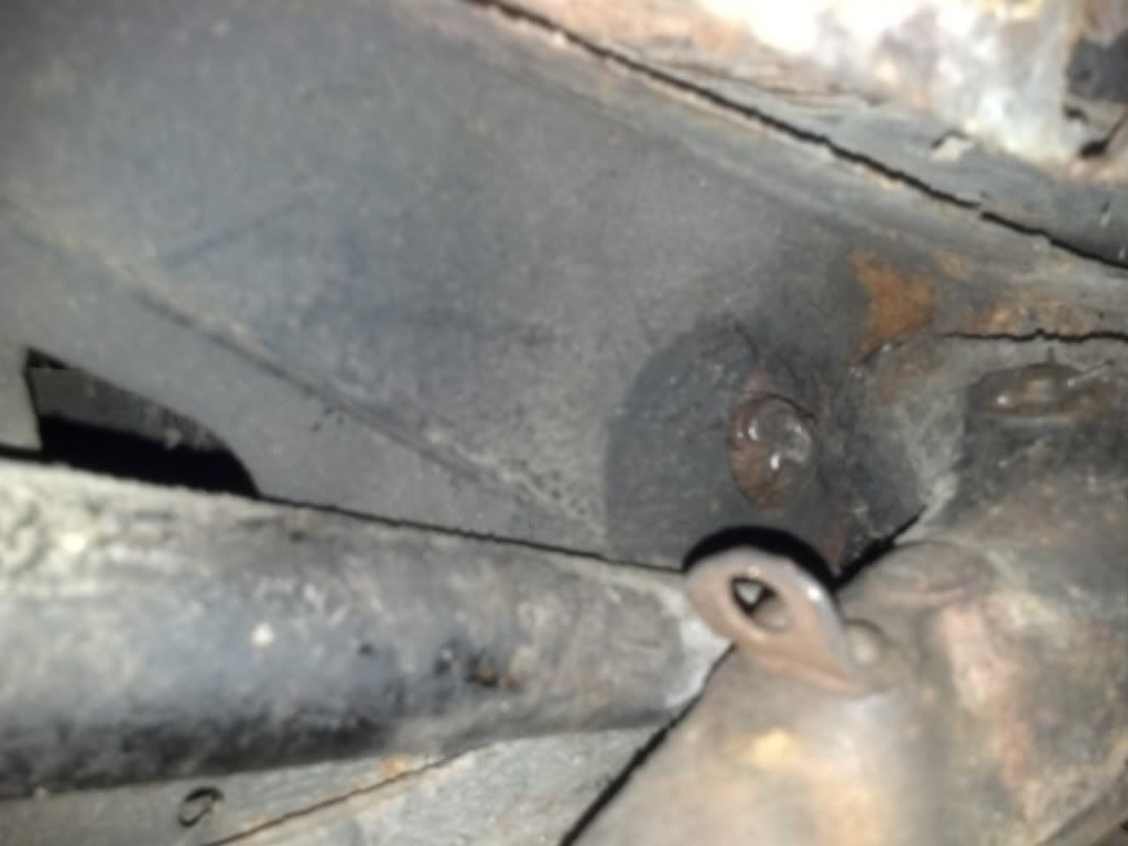

Ok, I was able to get the s/s braided ones for the rear locally for $29 USD each (18 quid) I bought the Copper/Nickel ally lines and fittings. I was about to make do the flaring when i dropped part of the tool (small black circle) in the kitchen and can't find it! Grrrr!
I am also having a LOT of trouble getting part of the rubber hose off the far side (not near the UK curb?) It seems as if someone gummed at that side, put some goop to seal it, and left it...
Any ideas on how to remove it? I can't get an opened end spanner/wrench to grip it b/c of surface rust or something. I can't get a socket on it b/c of the body work to the aft of it. I'm trying to use a screw extractor on it, but not having luck yet because it hasn't gripped the inner brake tube of the fitting i think. My vise-grips are to big to get a good grip on it :(
