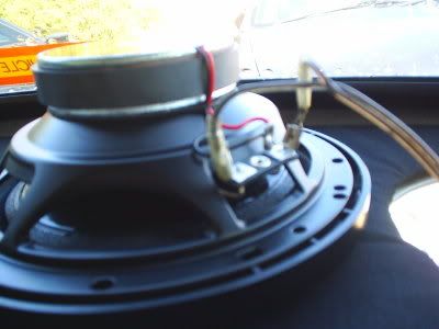

k, spent a bit of time this morning tryin to fit the new speakers, but the only sound i can seem to get is a crackly sound coming out of one of the speakers?? heres some pictures of how i've put them in....
thats the one on the drivers side, that thing in the above picture did have the old speakers wire in it so iv jus put the new wire into it, this is the speaker that is crackling

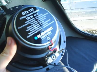

this is the other one! the lil thing with the four wires going into it isnt there on this side so iv just slided those lil bits on to speaker, like the old one was?

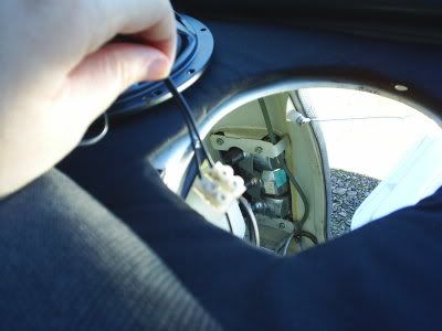

for starter, i found this.......on the passengers side speaker there is a wire that i've ben connecting to the speakers, and the today i managed to dig this out...so it's not actually been fully connected.....(it's the wrong way rond tho! imagine it rotated 90 degrees clockwise ;D )
and then, does anyone know how i can get inside here to 'reconnect' the wires?

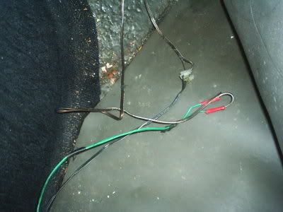

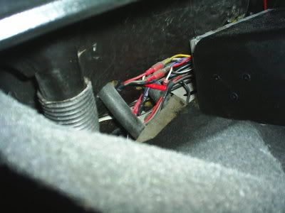

then, i followed the wires through the car, lifting up various bits of carpet, to find this little lot.......

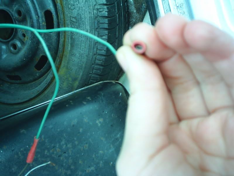

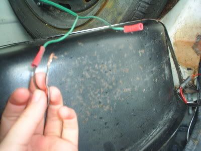

there two different types of 'wire connectors' do u think this would make any difference? tempted to change one of them just so i know they're both the same! also i noticed that this foot well is quite damp, so they've been damp aswell (hoping the dampness will be the residue of the leaking windows, which are now fixed)
do u think, if i went round all the 'connections' of different wires, trimed some of the plastic casing off and reconnected with a fresh 'middle' bit of wire it might fix my problem??

Sian, Don't know much my self but first of all the water would have caused buzzing and crackling and the connection is a simple spade connection. however with all the different wire connections you may wish to buy new cable and reconect the head unit and speakers as this will improve the quality anyway!!

From personal experience with Mini wiring (the silver Cooper in particular) - I would say it would be easier to replace the whole run of speaker wire from front to rear. If you can get the HU out you can see which wires go where, and locating the rear speaker wires on an ISO lead (which the JVC will have) isn't hard.
Halfords do some good quality lead for £4.99 (I've got about 30 foot of the stuff if you need any) which'll allow you to just re-wire the lot and get good sound quality, losing all of those nasty choccie-blocks and dodgy connections in the process.
If you want a hand doing it (takes about half an hour), I can pop up and help, I'm only in Ripley now. Up to you though.

Posted 02 April 2006 - 05:58 PM
ah, and those bits of wire you got with the speakers are what you've connected into the choccie-block?
In which case I'd definitely repace the wiring - those plugs (the big and little'un) are easy to buy and speaker wire is cheap (you can get everything you need from that yellow motor spares place in Eastwood). Running the wire through the car is a piece of cake, and I would lose those bits of wire that came with the speakers, just fit new connectors to the new speaker wires and bobs your uncle.
