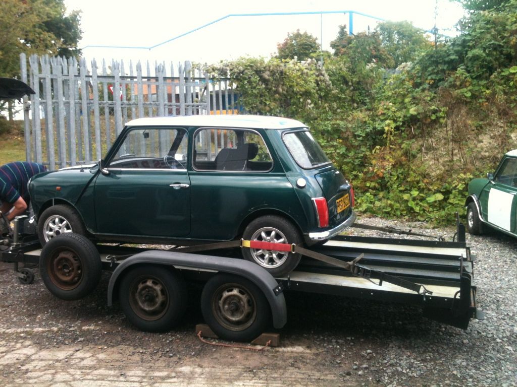

Then got the car trailered to Spot-On Minis in buntingford (cracking mini garage) and he re-rebuilt the engine (properly this time) and it was decided to run the engine in N/A, just to make things simpler and to give me a chance to modify some of the turbo bits.

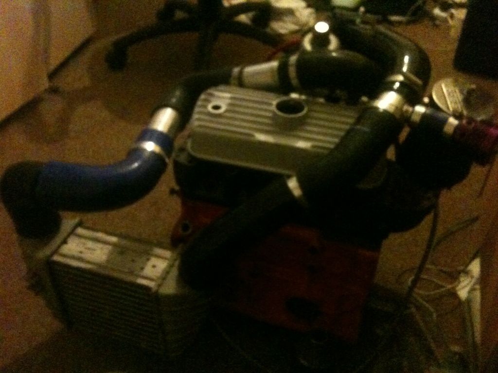

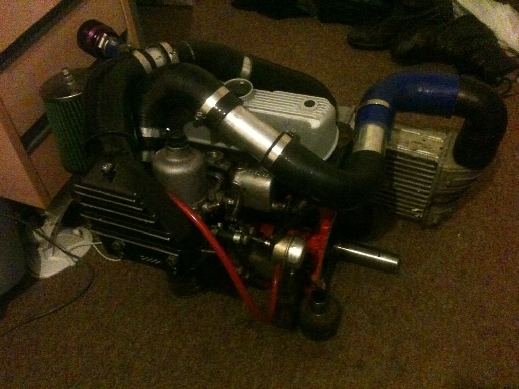

Currently got the turbo parts mounted on a spare short engine so I can tinker..

So currently 1000 miles into the running in process, just a case of waiting for it to stop smoking and me to finish some of the bits needed for the conversion and it can all go on! hopefully February time when I have not much uni work.

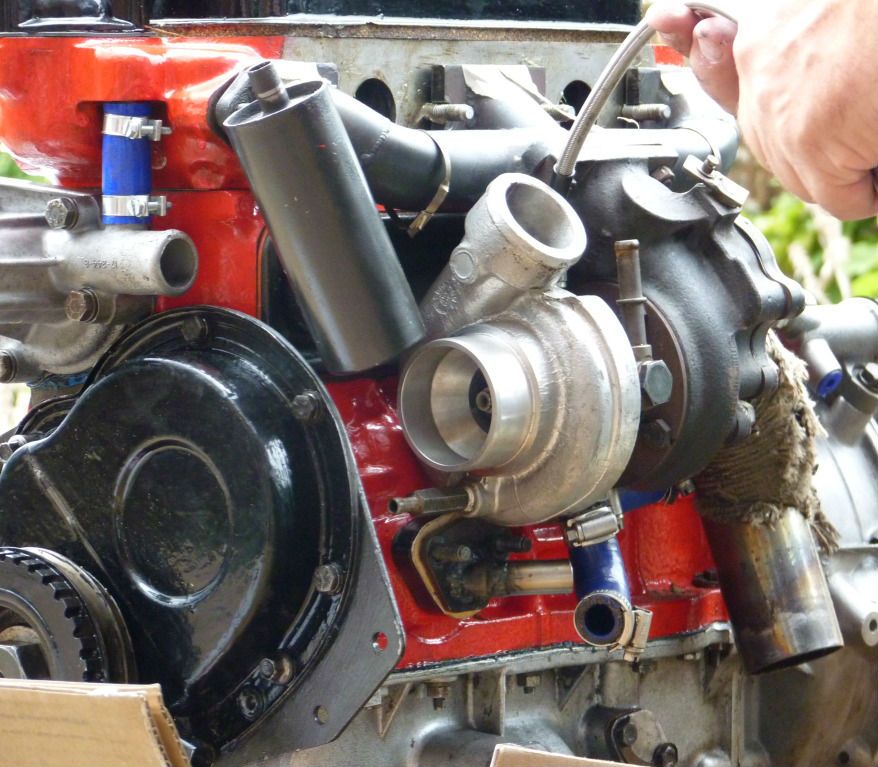

I have read up on your build thread on TM.
Your manifold sparks my interest as I see you have left your bulkhead in tack which is something I want to retain on my project.
Is that manifold a home made item? I initially thought it was a mirage unit but the bend in it looks a little different?
#5 BritishRacingGreen
BritishRacingGreen
  • 433 posts
  • Location: Hertfordshire
Posted 31 December 2012 - 12:25 AM
It was bought from another member of TM, who assures me it's a genuine Mirage kit. But you're right, it is slightly different to the one pictured on their website (the only other picture of one i've seen). However they are hand made items, and made individually (to order I believe) and are only constructed on a jig, so it may well be that it's a slightly different shape to some.
It does the job though, and I didn't have to put a bulkhead box in, and the downpipe fits perfectly

Looks like a mirage to me, there are a few copies around, but all the ones Ive seen are as good, if not better in some cases.
I'd be worried about the smoking, this won't go away. When is it smoking? What colour is the smoke? Have you had it setup? what can happen is an over-rich mixture can cause borewash. this smoothes the bores and causes smoking.
