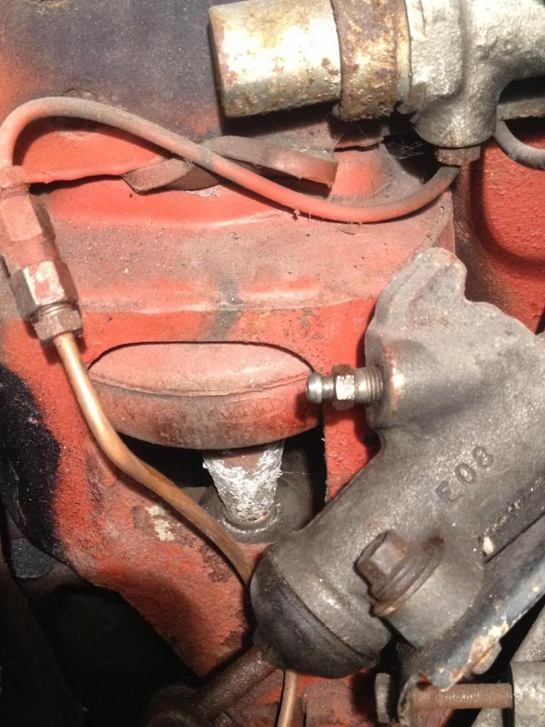

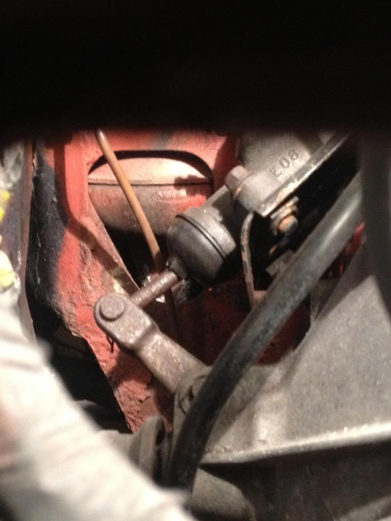

Posted 09 January 2013 - 08:51 PM
these are the front cones not very good pics but they look like they have caved in about an inch? am i right?
#21 charie t
charie t
  • 3,153 posts
Posted 09 January 2013 - 09:00 PM
Subframe bushes need sorting
and the clutch slave has the sleeve missing from the lower bolt too

#23 stocky
stocky
  • 338 posts
Posted 09 January 2013 - 09:08 PM
yup those front cones look past it. the knuckle joints need the dust cover over them or else it'll let in dust and also expose the knuckle to the elements. there's at least 2 that need attention

#25 Cerberus
Cerberus
  • 989 posts
  • Location: near Leicester
Posted 09 January 2013 - 10:21 PM
The rears look all right to me from those pics. But yes, the fronts look a bit worn, but there is more weight on the front so I think they squish a bit more than the rears.
What I can't understand is why your sump is so low, but the suspension looks quite high. Might be the amount of material removed from the wings, but I can't quite tell.

#26 joewf10
joewf10
  • 382 posts
  • Location: shropshire
  • Local Club: on lookout
Posted 09 January 2013 - 10:52 PM
thats why i was so confused hahha i think its the wings mate
