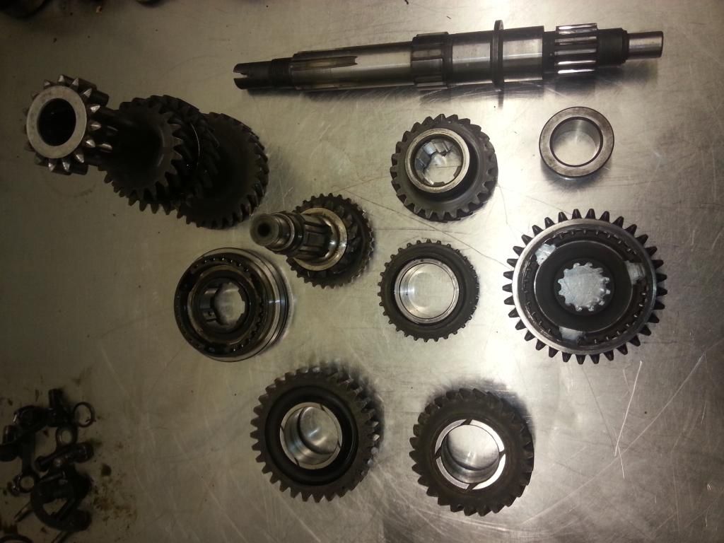

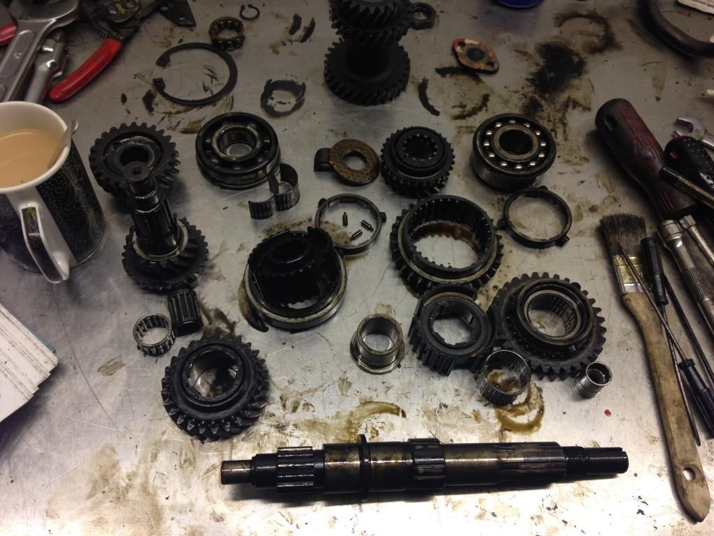

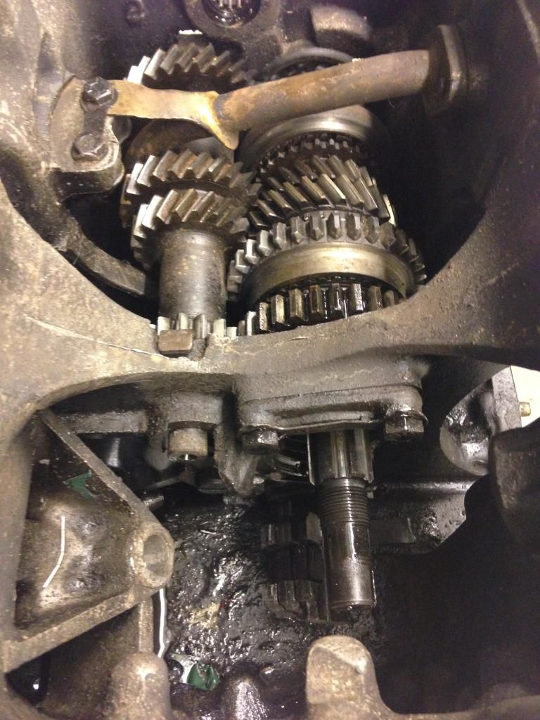

I managed to finish work early today, and I was home by 3.30 even though I had a two hour drive from Telford!!  :D So I thought I'd make the most of this and do something on the mini :-)

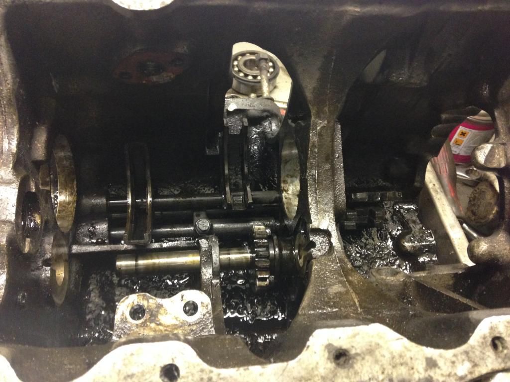

I decided to strip the gearbox down so I can check everything and rebuild with new bearings etc. Here are some of my dirty bits ;P
D38F4FB3-2438-4713-81C5-2E9BED182497_zps
4C7D6770-728C-4D04-B365-9FD4745F0E00_zps
The diff had already been taken off, I think I will replace it with pot type output shafts, instead of the rubber coupling type.
60224636-4039-4006-98E6-FD727E69BE2F_zps
All the gearbox stripped, mains shaft disassembled etc. I might strip the original box from the car because some of the gears don't look too clever  :-|
08D36AE4-41C2-4B86-AEA8-42549307C674_zps
I've put it all in a container of degreaser and stale petrol to soak for a couple of days.

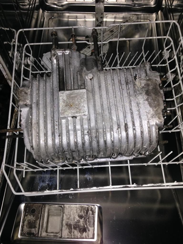

Next task is to rig up the dishwasher that was kindly donated by my dad so I can clean the casing :D

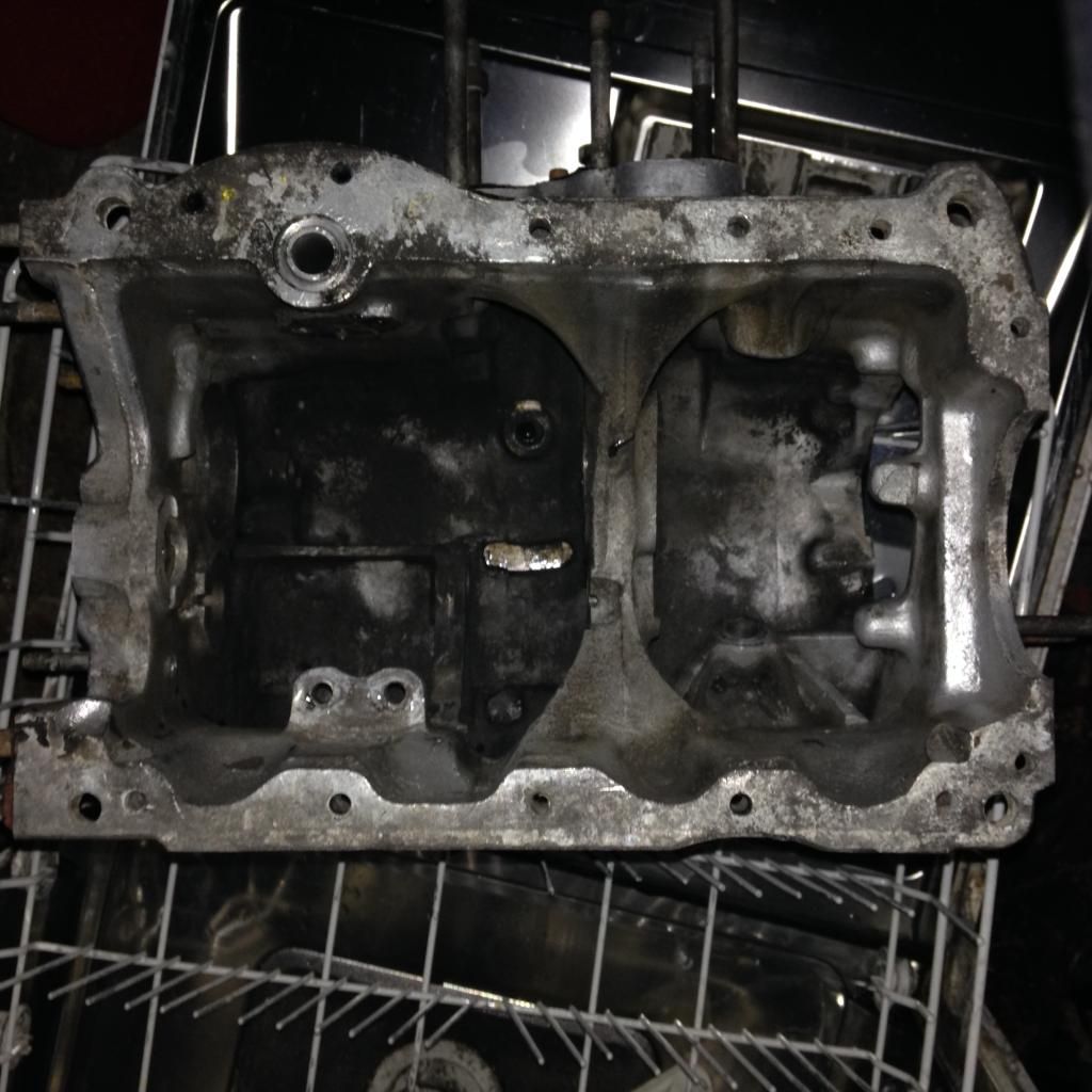

I've been finishing off stripping the gearbox this evening, and I got the casing in the industrial cleaning cabinet, otherwise known as a dishwasher.. ha. It's worked pretty well, I'll put it on another cycle next time and hopefully it will be clean enough. I didn't clean the loose stuff off because my pressure washer is broken, but it has still come up pretty well.
78AE7152-02A0-45B5-A644-B009BDF671E3_zps
50E72DDB-AC0F-40A6-B972-CB470F282022_zps
Doesn't look as clean here, it wasn't very good light :P
Cleaned gears etc, I'm looking forward to rebuilding this :-)

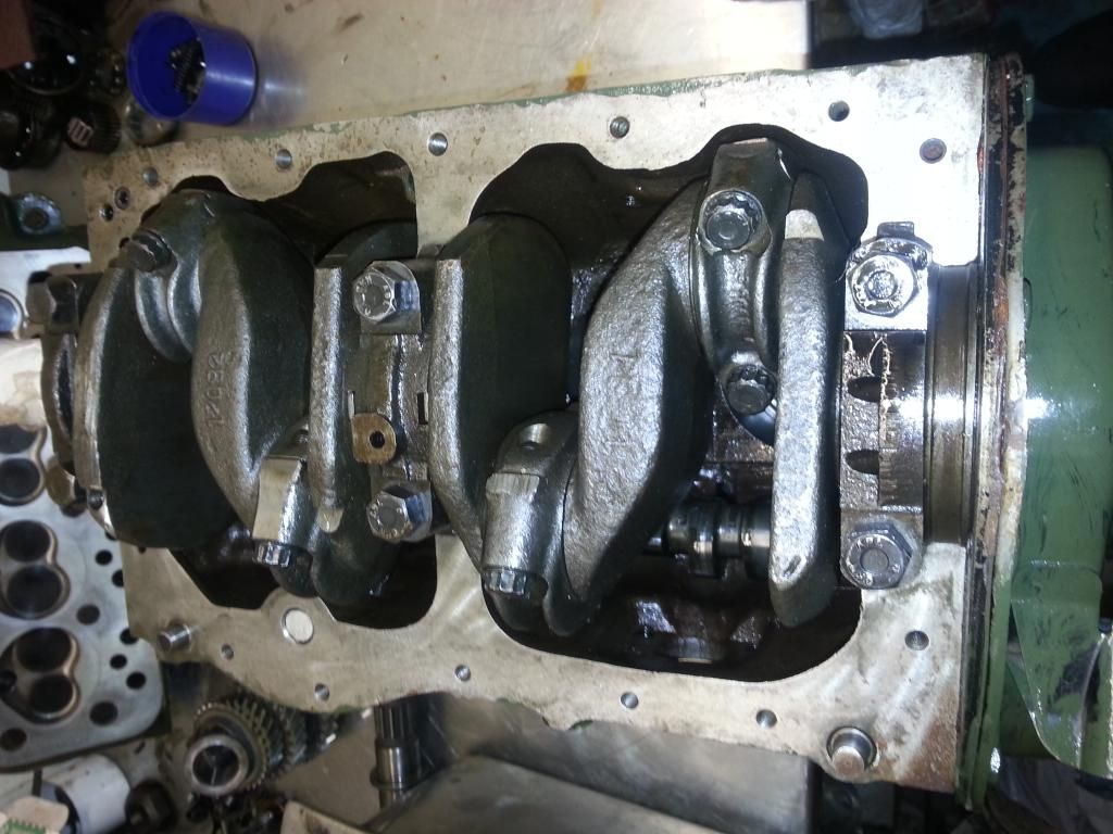

I've given it another clean tonight :)
Also the engine has arrived!! :D
BF026590-857F-456D-A4E7-8FA033F970BD_zps
A20B7322-CF04-4BD8-AA45-B5671B86362A_zps
7E751009-85E2-470C-A98B-70560CAD662D_zps
7DF45B06-764C-4FD6-9249-E97E22075881_zps
94A2617A-E267-4179-8F7B-77D2946144D4_zps
33EBEA37-769C-4F3B-A60C-C13BFD81348B_zps
Spec is -
Cylinder head
12G295 10.1:1 compression rasio.  Oversize (approx. 31mm and 27mm) plasma nitrided race quality valves, 3 angle valve seats. Hi-flow silicon bronze valve guides. The ports and combustion chambers have all been worked and smoothed. Dual rate kent double valve springs for 266 cam.
Cylinder block
Bored to 1120cc. Steel backed mini spares oil pump. Decked to piston height.
Cam
Kent 266 with new followers, bearings and kent vernier duplex timing set.
So I've gone for a slightly larger engine than the 1040cc I had planned, but its pretty much the same spec other than that. I've just got to rebuild the gearbox! So I can get it in :D
