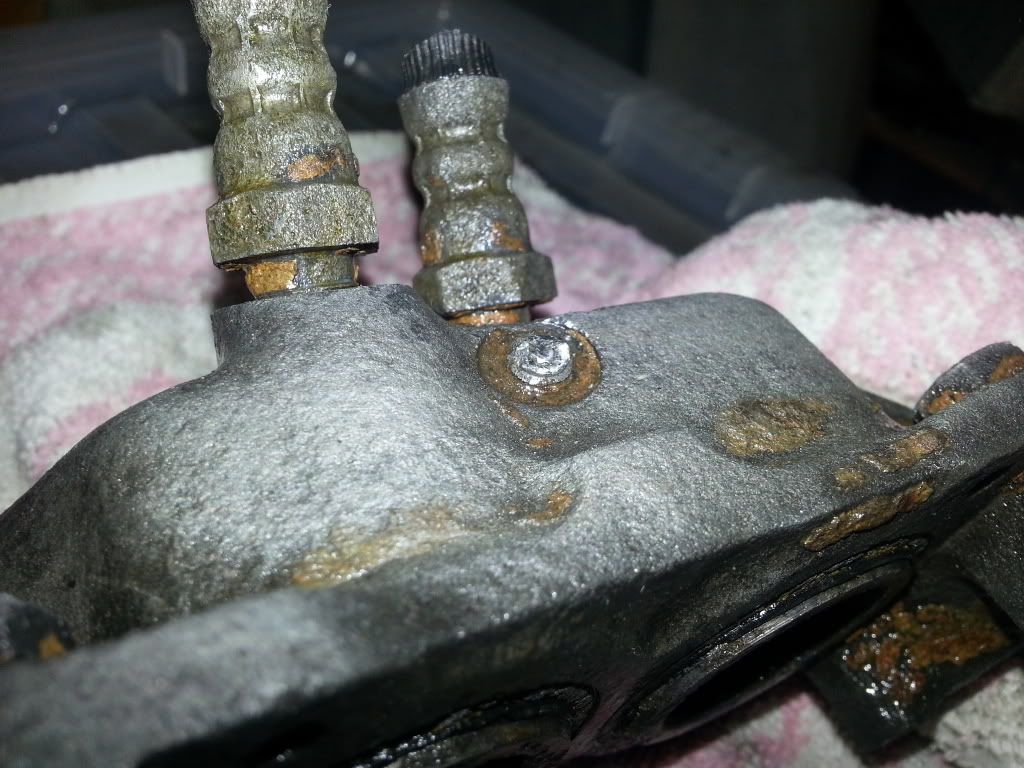

As above. Ive acid dipped some metro 4 pots and I got all the hoses out and all the nipples till the last one :* it snapped.... any ideas on the best way of removing? Should I drill it buy easy out and try them or try drilling it and folding the bolt in on itself?

DO NOT TRY AN EASYOUT! Easy outs work great when there is no load, but in this case they simply will not work. They will snap inside and make the job 100 times worse (guess how i know).
Get some LEFT HAND drill bits, and carefully drill out the nipple, making sure you do not reach the bottom of the hole. When the walls of the nipple are thin enough, the twisting action of the drill should grab the nipple and pull it out if you're lucky.
If this doesn't work you need a pillar drill (or milling machine) to make sure the hole you drill remains central and possibly re-cut the taper on the bottom if necessary. then tap and fit a helicoil to finish the job

This is one more vote against EZ-Outs of any size, type, make, or quality. Consider for a moment that you have soaked these calipers in acid long enough to soften/remove most the rust and some of that acid should have wicked into the threads. The bleed nipple is well and truly stuck. If it was going to come out easily it would be out now.
This is also another vote for left-hand drill bits in progressively larger diameters right down the center of the bleed hole. If anyone tells you to use a drill press (pillar drill) DON'T. The idea with left-hand bits is that they will spin the nipple up and out when they catch in the broken part. Up and out will cause the bit to break if held rigidly. Use a hand drill and steady hand.
If you cannot get left-hand bits, still try progressively larger regular bits. Stop as soon as you think you are close to the minor diameter of the thread. Then collapse and pick out what is left of the threads. Try to NOT have to re-tap the hole. Bleed nipples often do not seal in re-tapped holes (not because of damage to the seat but from a loose fit on the threads).
There are two repair methods to use if the threads become damaged. One is a repair kit that includes a special bushing and new nipple. You re-tap the caliper for the bushing and simply install it. They work OK. The other fix is to take a brand new nipple and grind the conical tip off so it is shorter and flat faced. Drop a clean ball bearing into the hole (2/3 the diameter of the hole) and then fit the flat faced nipple. The nipple will push the ball into the seat to close it off securely in place of the original conical tip.
