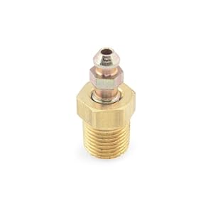

If you are planning on a thread insert, skip that and go straight for the nipple repair kit (insert). The conical seat has to be "just right" as far as fit and concentricity if you hope to get a seal. Or... review my first post where I mentioned the "ball" fix.
http://www.fraserbro...t&product_id=51

I see what your all saying. As for the force involve in snapping it i was using a 1/4 inch rachet and it snapped straight away with barely any force at all.... the repair Looks nice mate but for that price I can buy a brand spanking new caliper..... ill go for theleft hand drill route first and see where it takes me.

That was the only U.K. kit I could find. In the U.S. the repair kits are sold individually in blister packs "out front" in the parts stores. They use 1/8" NPT pipe taps for mounting and the kits do not include the tap. In the end, those kits cost about $10 (6 GBP or so) but... they expect you to already have the tap and tap drill.

http://www.tracytool...&product_id=707
http://www.ebay.co.u...2747#vi-content

http://www.tracytools.com/index.php?route=product/product&path=46&product_id=707
http://www.ebay.co.uk/itm/Caliper-Bleeder-Screw-Repair-Kit-Harley-Davidson-/221188532747#vi-content
Cheers for the link mate. I just bought a small set of left handed drills yesterday 12 quid from the states. If I cant get it out that bleed screw looks like the answer..
