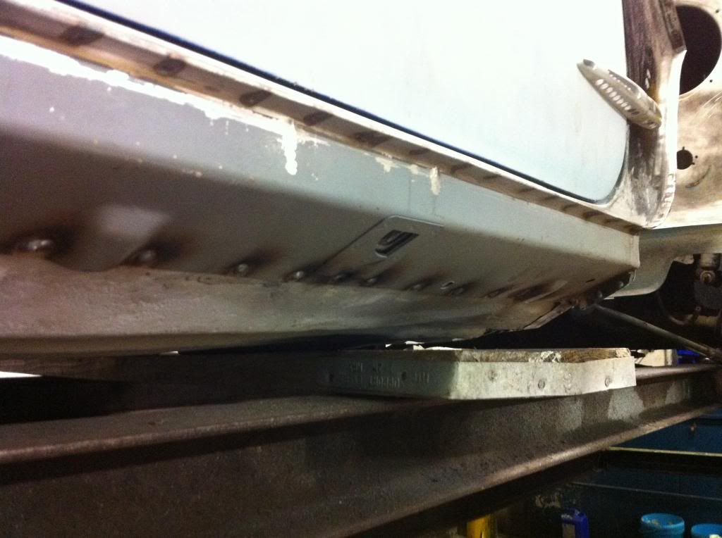

becjuase originally they were spot welded. if they are stiched on it doesnt look original. with plug welds you can dress them to look like spot welds.
spot welded door step and sill and plugged the lower edge becuase i didnt have the right arms for the spot welder!
