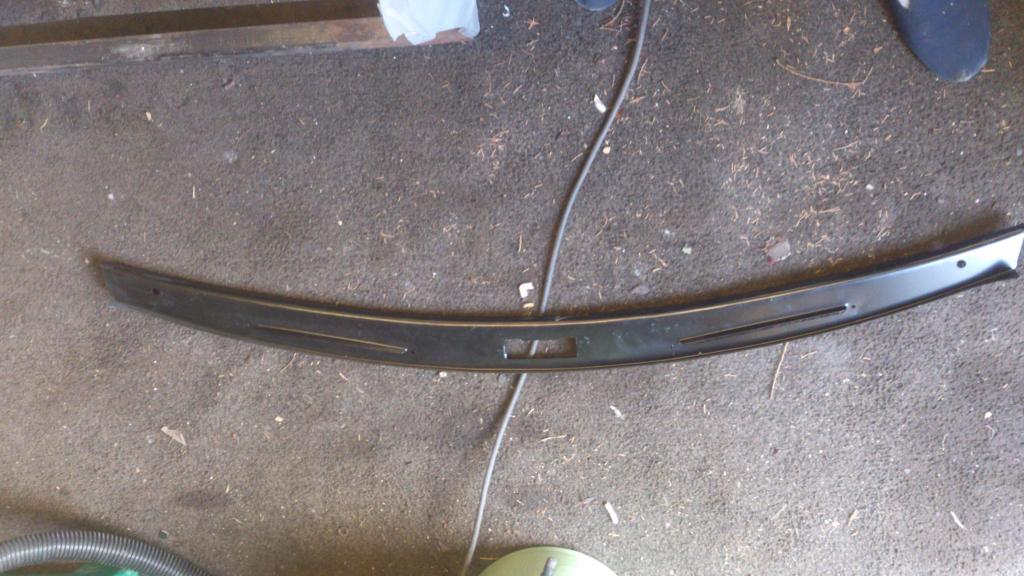

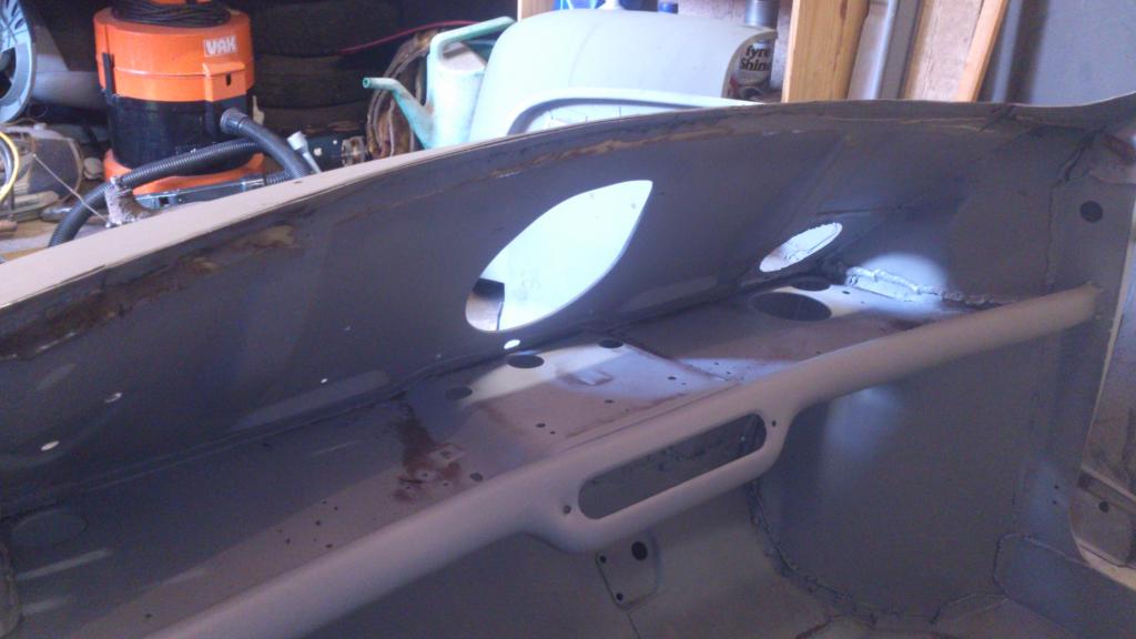

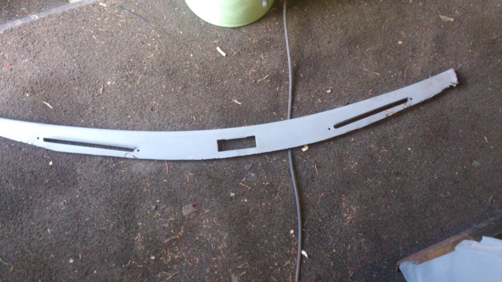

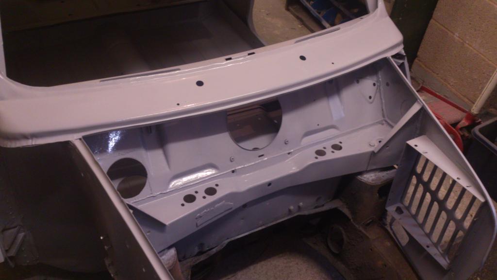

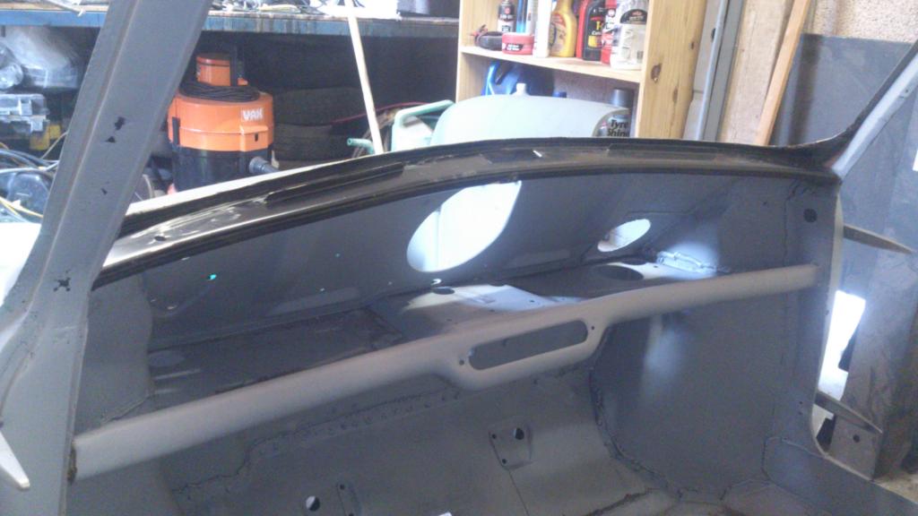

just got the top dash rail fitted my old one was shot around the edges i could of repaired it but its a lot quicker to put a new one in. another job to tick of the list. tomorrow and Wednesday i will be cleaning up around the shell from what i have done so far and getting set up for the back panel that's coming Thursday here is some pictures thanks for looking.

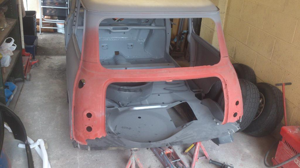

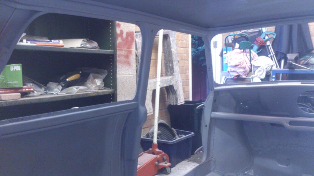

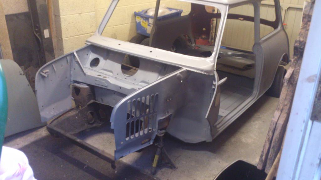

hi all seam sealed all welding joins and etch primered bare metal areas also gave it a clean up in the garage as i couldnt move much i am pritty much waiting for the panels to turn up now just got a few welding patches to do on the passenger door edging and some patches on the inside of the door frame thanks for looking here is some pics thanks tom

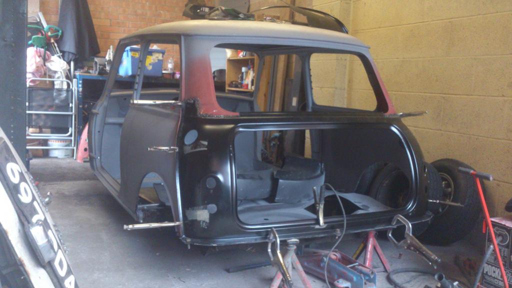

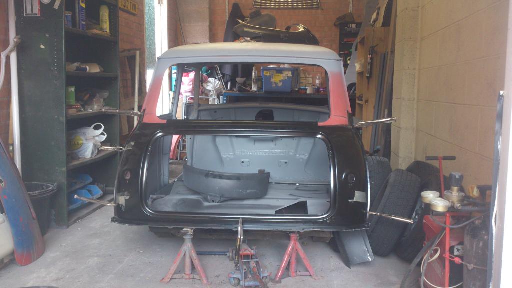

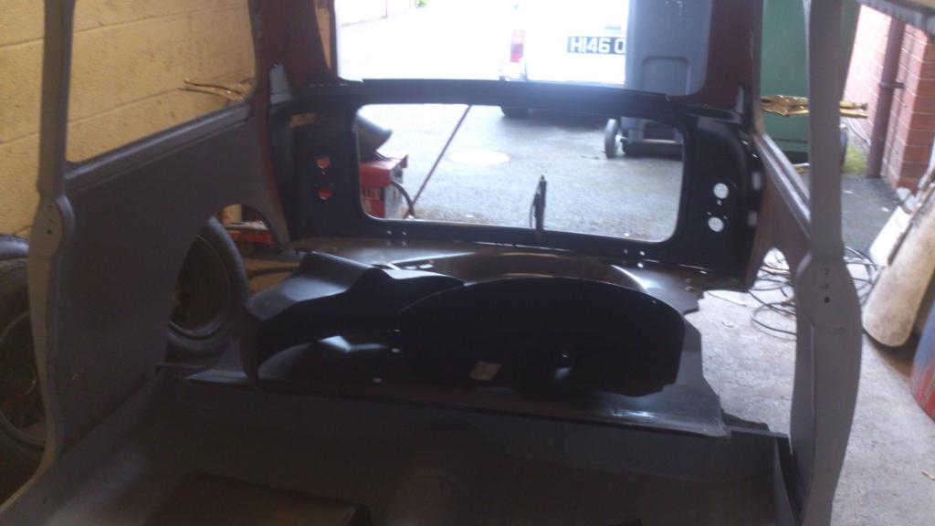

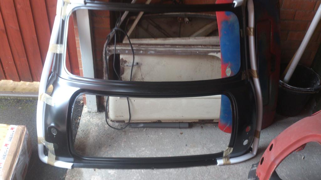

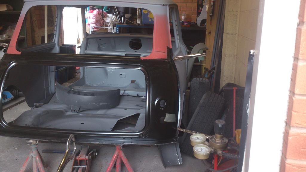

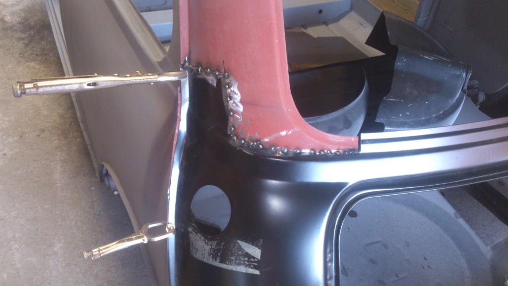

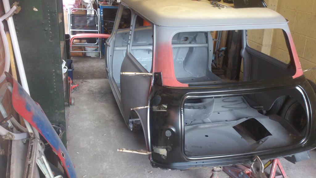

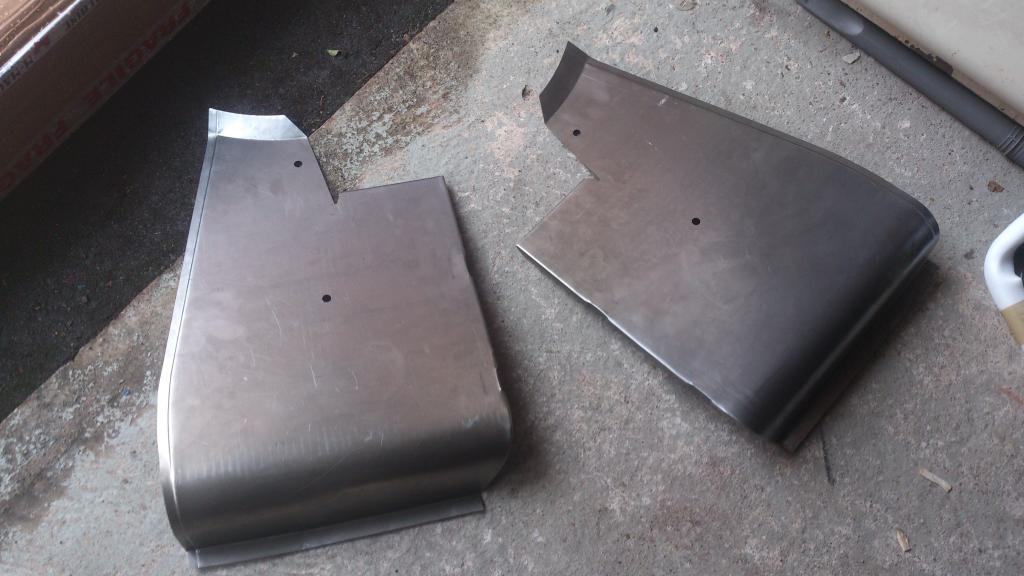

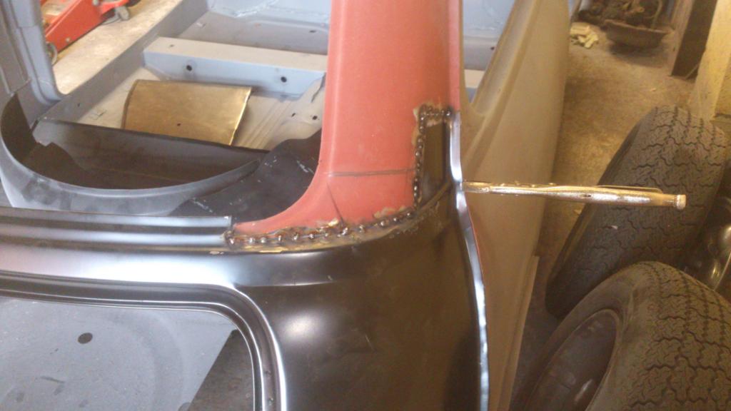

hi all parcel came this morning so as soon as i got home i made a start. i test fitted the rear bins and they seem a good fit. and i have cut down the rear panel and spot welded it in place for now untill fully welded tomorrow night. i tryed the rear arches and they are going to be a pain to do i can see it happening. any advise on geting them in or if i am missing anything before i weld the rear panel in just say here is some pictures thanks tom =]
