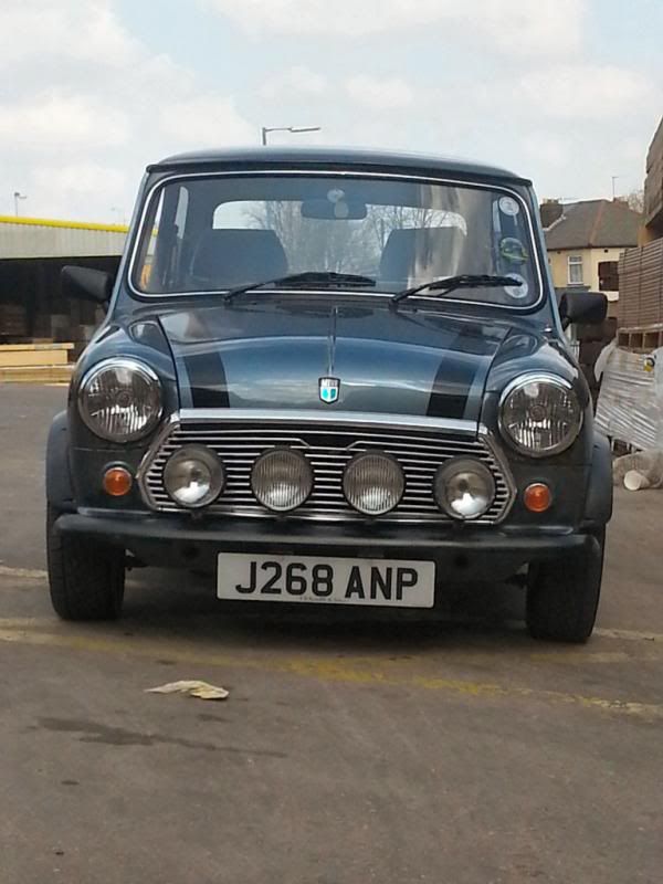

OK here is what the front camber was like last year
Drove perfect. No pulling, tyre wear (excessive or uneven), steering self centred fine. Then a couple of months back before its MOT we replaced both track rod ends, all ball joints, and the bottom arm bushes.
I noticed after a couple of weeks the tyres moreso the n/s one was wearing funny on the very edge.To it done to my dads work and checked the tracking and sure enough it was a little too much toe in on the n/s so this was adjusted. No when i took it back outside i took a picture of the front and noticed it seems to have loads more positive camber than it did before. I have no idea what could of caused this as the suspension is all standard stuff bar the adjustable tie rods which are set to standard length. . It doesnt self centre as well as it used to either but i think this may be to the camber needing adjusting. If you compare the pic below to the one above you will see what i mean
Anyone got any ideas what has gone awry here as i am at a loss.

Were the springs relatively new in the top photo? It looks like it's settled by over 1" to me. The camber increases as the suspension travels.

No springs are the orginal ones theres about 8 months between the two photos. Could the springs be starting to collapse?
Dont you gain negative camber the lower the ride height of the car?
#8 freshairmini
freshairmini
  • 1,718 posts
  • Location: Alresford, Hampshire
Posted 21 April 2013 - 08:41 PM
yes, the springs settling or collapsing would cause negative camber. maybe the combination of bushes, track rod ends and ball joints made it back to how it was factory, and that is positive camber.
#9 Dan
Dan
    On Sabbatical
  • 21,354 posts
Posted 21 April 2013 - 08:42 PM
Oh you've got me wondering now! You're right of course, I've been confusing myself. Sorry.

Could it be the way the car is parked in the photo that is exagerrating the camber. Where it is parked runs downhill in two different directions, it is not flat at all.
No I'd say there is definitely a change there. Although if you have all standard parts it should be a little positive to start with which is odd because the top photo definitely looks negative. It is hard to say anything for definite without measurements and just looking at photos though.
