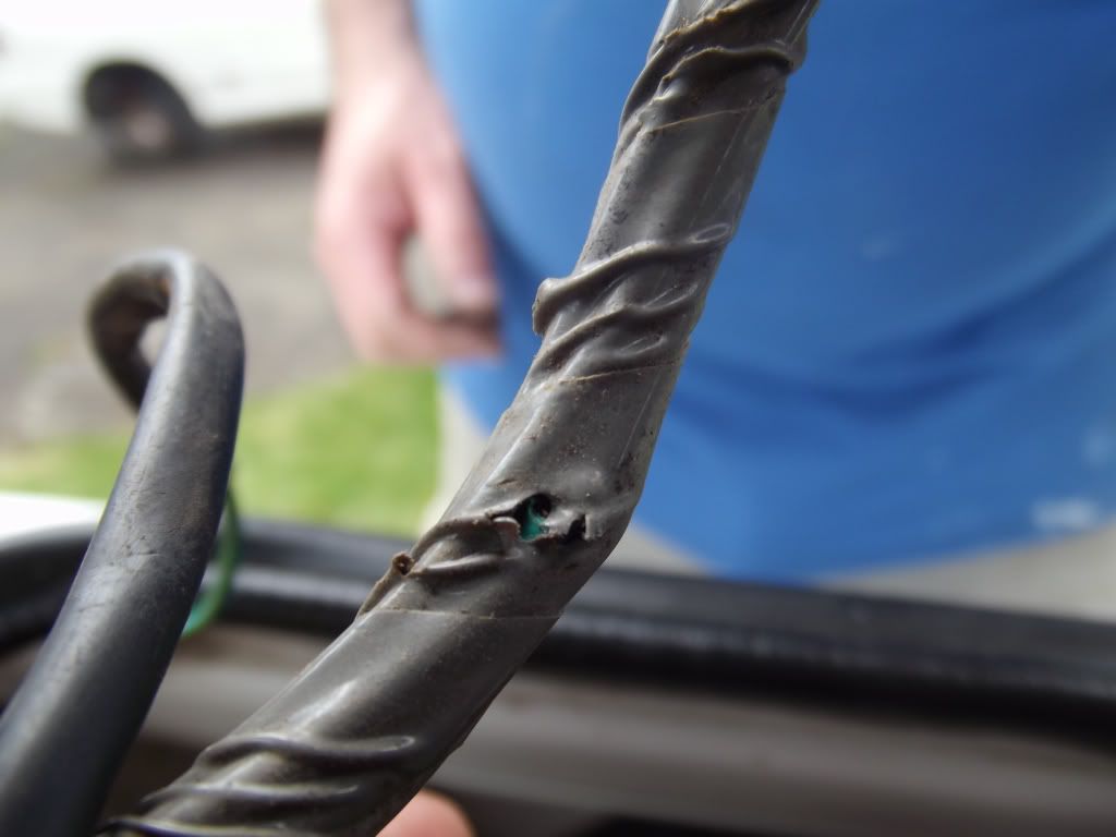

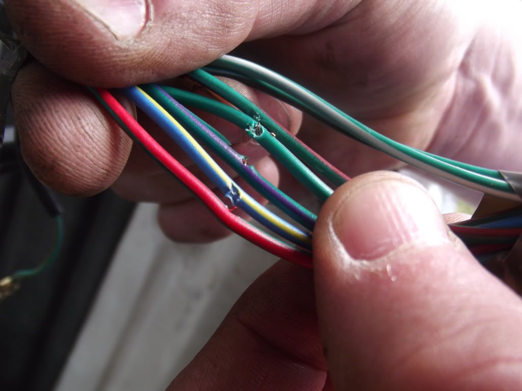

I had sliced 4 out of the six wires in the loom, typical. Now properly fixed and all lights work! Even had chance to rub down and paint the fuel tank!

980d452454fb767b4b27a09e694555ad_zps2d64
I feel like an idiot
953f80e179d1882acfaf0a1abb07fb50_zps01b2
