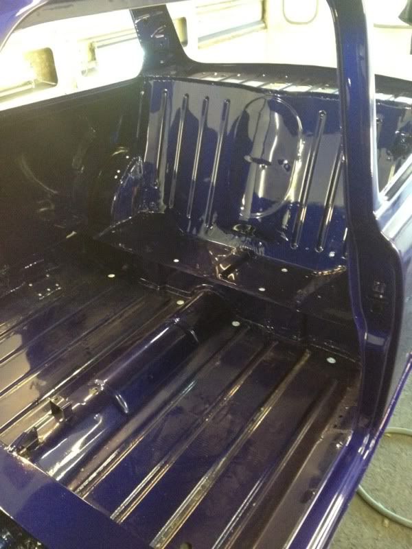

It can be done, so I've been told. Minisport told me the best way was to ratchet the legs to pull them in past the pillar, then bring it in flat into the front and tilt back into the bins. They also told me best to take out the windows just in case! Mine has the bins out and that was headache enough though! Can take some pics later to show what's left.

Saw this in clivemk1mini's thread
you can see the cage holes too.

Thanks that's really helpful!
