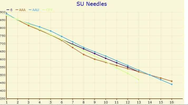

Hi again Kevin -  here is an SU needle comparison using a couple of the needles recommended by me and jaydee
The ones i suggested are the 13 stage fixed needles  , to be honest i am not sure if the 15 stage needles are also fixed or the swinging variety - but they are pretty similar  - i think the CAUTION from both replies so far is don't go too rich for run in
I am not suggesting a needle as i said have a good look and compare for yourself. ( i only run mine based on my spec in my conditions with me monitoring the AFR ) cheers

Thanks for the replies guys.  I've seen that program but honestly it's greek to me.  Can someone give a quick overview on how to read it?  Also difference between fixed vs swinging type.  Why does it appear the "6" starts at 6 along the abscissa?  I certainly take full responsibility but need to order today.  So 6 maybe?

there are 4 lines all overlapping in the diagram. so 6 does indeed go all the way.   The bottom numbers represent the 'stations of the needle - from memory they are just reference points every eight of an inch as the needle tapers from top to bottom. The y axis numbers represent the diameter the needle - so in this chart 900 (which is .090 type needle) is the top of the needle and it tapers to richer end.  There are plenty of 'versions of what happens at the various stations or more to the point zones (eg stations 1- 4 idle) station 10-13 wide open throttle). Minty lamb charts inverse the chart but still show the taper.   Fixed needles look just like a needle, swinging needles have a base plate sort of attachment. all the HS4 s i have seen are fixed. I would think a pair of sixes wont get you in trouble for running in  BUT   try and get a local to confirm . Cheers

Sorry Kevin if i led you astray , again the profile chart of 6 and aau is mighty similar - you just need to get the right type of needle to match your carb

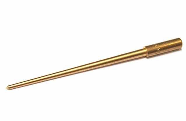

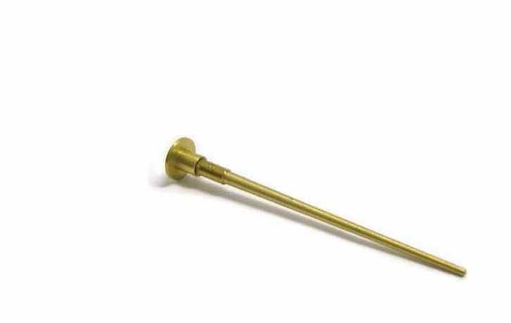

Before you order the correct one , check the carb piston   for which type of needle you have
the fixed needle  eg (6)
is held in place by a grub screw on the side
the swinging needle (eg AAU)
has a spring arrangement
both are for .90 needles

Well I got the fixed needles and as Murphy would dictate they aren't the right ones.  In my experience, in  any 50/50 proposition there's 90% chance I'm going to get screwed :lol: .  Looks like it's time to order swinging ones.  Interestingly, my mechanic said he fabricated something to put around the fixed needle hub so that it can fit in the piston and can be held in place with the set screw and the car actually starts and runs,  but I'm sure they can't be centered like that so might cause damage so I better get the swinging type.  Ian, can you elaborate on the red piston springs you mentioned?
