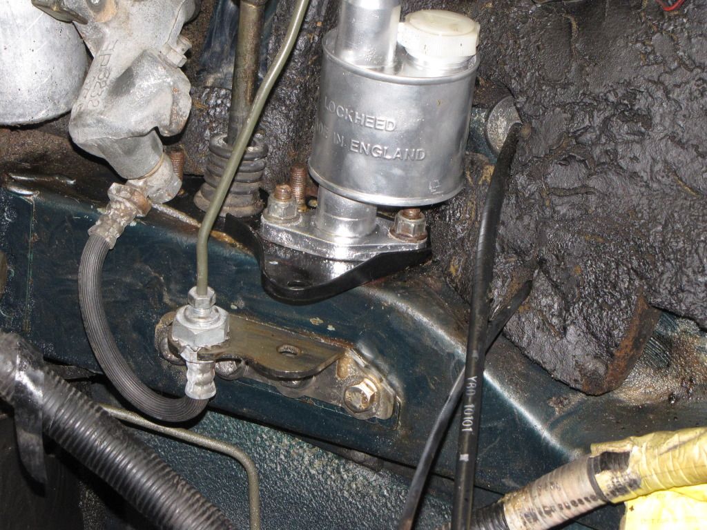

Heres a few pictures from my current build:
This is what he will need to remove:

I would say not to the dash coming out as its welded to the bulkhead crossmember which has a hollow area within which is seperate from the cabin (bar two 4-5 inch holes).
Labour costs might exceed whats being done work wise as mearly stripping it all down to get to that area will take alot of time.
 The brake/clutch systems will have to be re-bled back up also.
Its an awkard repair to have to do, could you not strip it down yourself ?

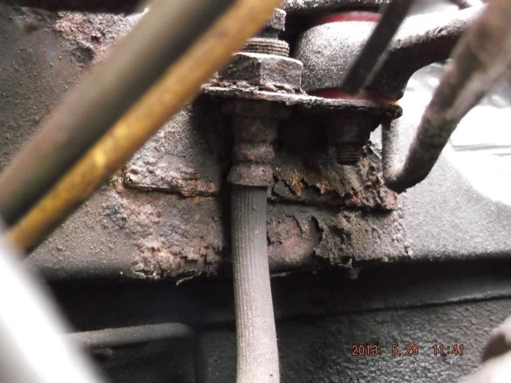

Any chance of a picture of the damage calderwood ?
#8 Calderwood

Posted 30 May 2013 - 05:58 PM
Yeh its on the bulkhead. No pictures yet, as it is still with mechanic as we speak, I'll be going down to have a look later, so will post some after that. I could probably strip it myself, but I'm currently at Uni where I don't have a garage (and all my tools, ramps etc), so can't do it at the moment really. I'm getting the feeling this is going to be expensive :ohno:
