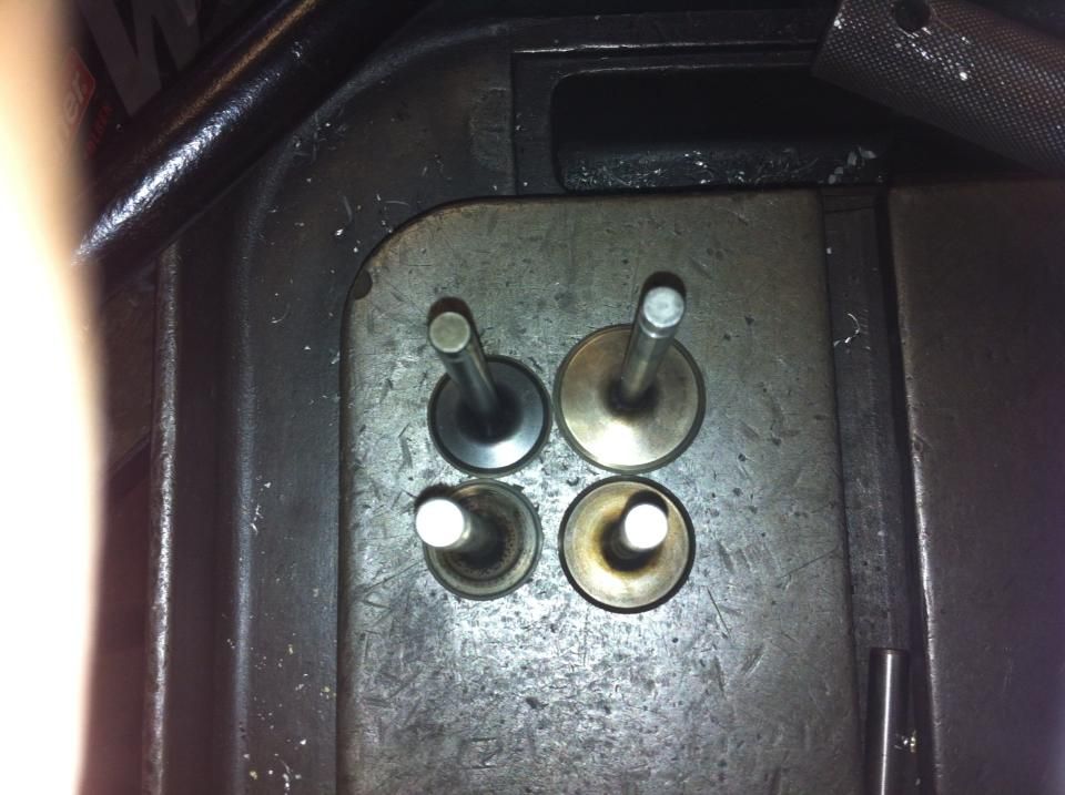

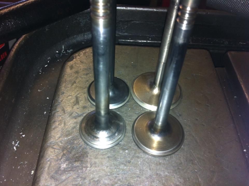

Not much happening at the moment should do some engine work this week , i did source some 7 x 13 mambas not to shabby for 60 quid need new tyres though,  IMG_0591_zps6b91d7c8.jpg , i did source some stainless one piece big valves out a old slark racing head, they are 38 inlet and 32 exhaust,1620808_10151833424172443_193507276_n_zp,
1622603_10151833423982443_644264503_n_zp, 1526933_10151833424092443_1430218061_n_z
the inlets are actually two big i have been told, so going to use some 36 mm inlets out a big valve metro head, and also may have to make some offset exhaust valve guides which could be interesting :) more updates soon.

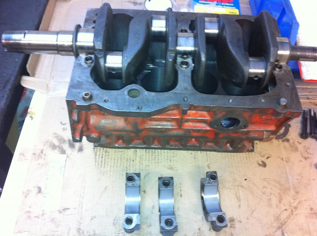

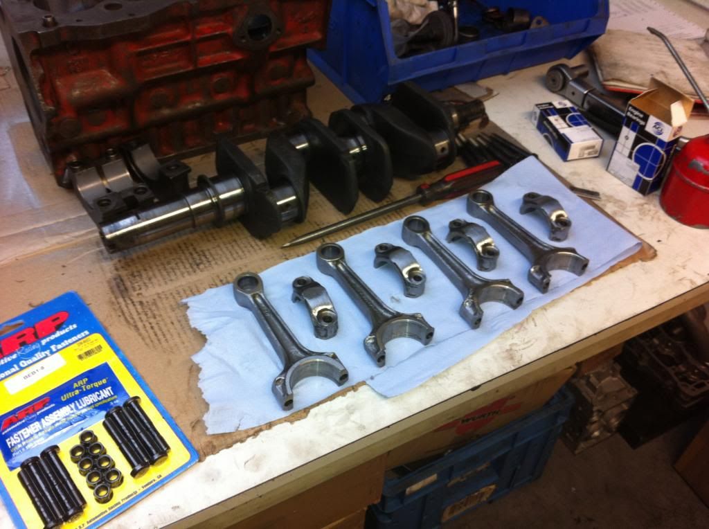

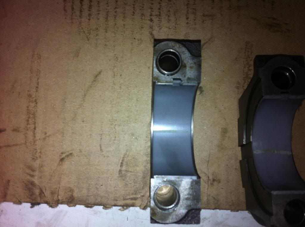

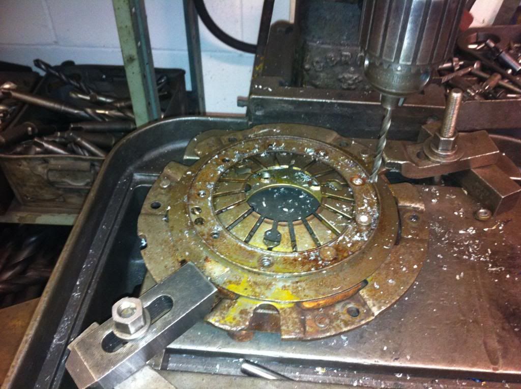

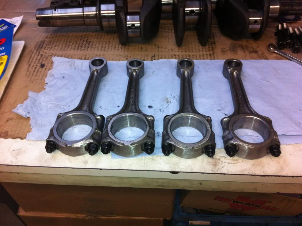

Did some engine work today, stripped the clutch down as im converting it to a RTS clutch,, tapped out the holes were the old rivets go IMG_0624_zpsbdb0715b.jpg, IMG_0625_zpscda25836.jpg, goodies arrived :) IMG_0628_zps41af5730.jpg , fitted the turbo crank with the new bearings and used plastigauges to check the clearances,  IMG_0629_zps89edf80d.jpg, the clearances were perfect,  IMG_0630_zps57c43ca5.jpg, IMG_0632_zpsbad1b820.jpg, fitted the rod bolts , IMG_0633_zps30b13e5d.jpg, and fitted the omegas :) IMG_0634_zpsb5c32de4.jpg.i also checked the endfloat with the dti and that checked out fine ,
over and out

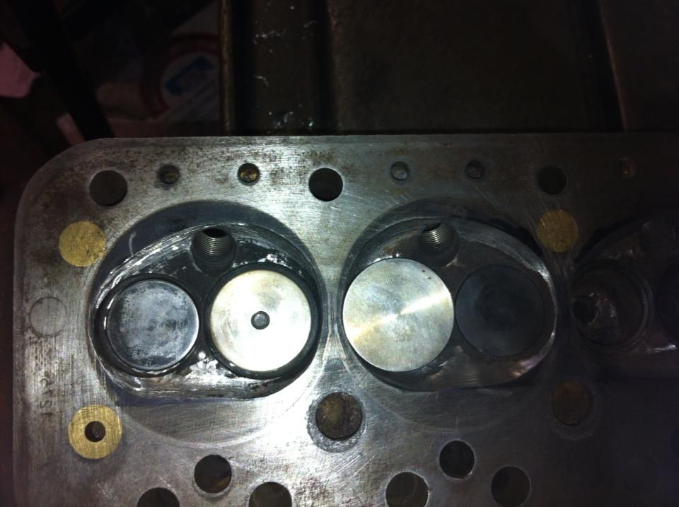

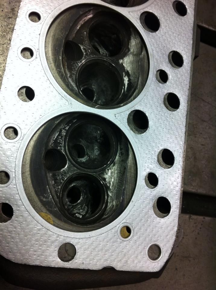

done some more, removed the vale guides, and done abit more work on the cylinder head , 1620955_10151860570902443_964349441_n_zp
