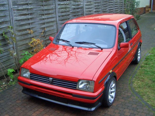

#87 Mini-Mad-Craig
Posted 28 January 2014 - 08:49 PM
This is Rita! :P

what are the wheels on the metro?
will they fit a mini?
