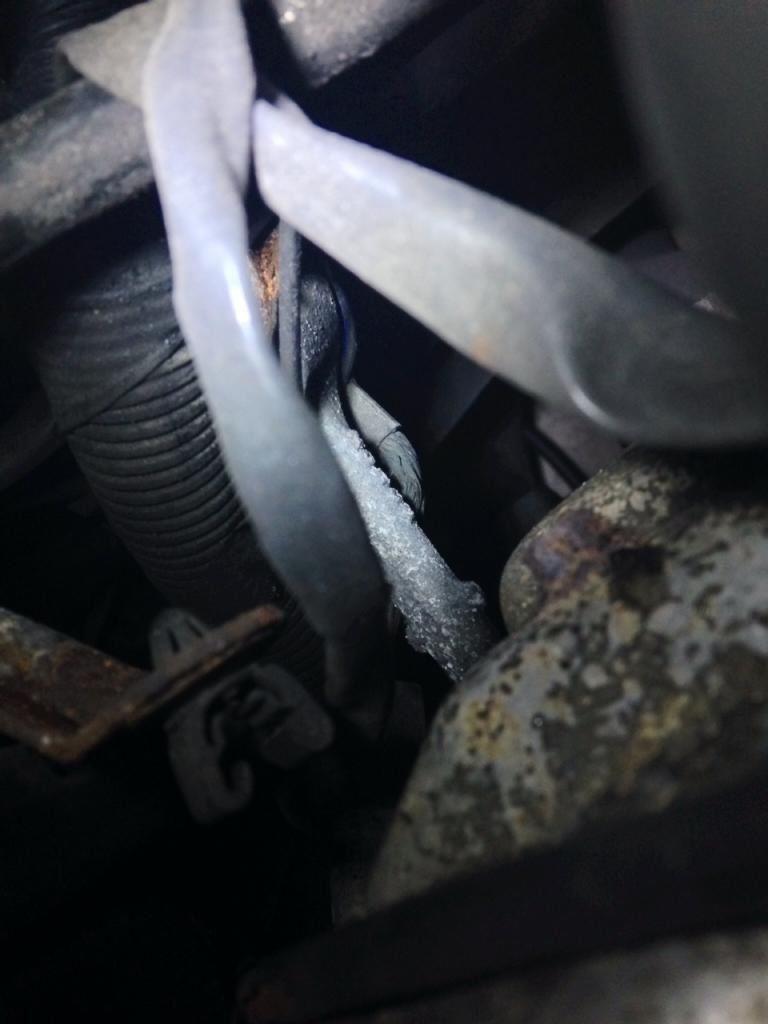

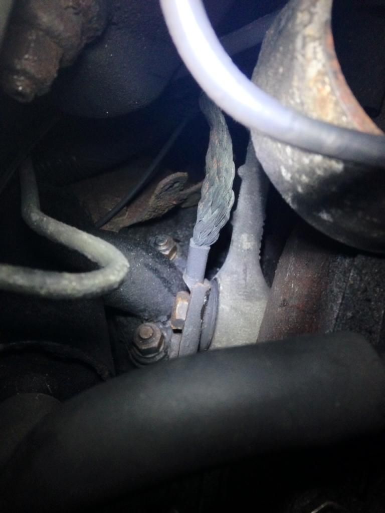

Also a question - I have seen it recommended to check the earth strap (something I had not heard of previously!) - is this it, in my engine bay?
The braided cable from gearbox
and you can just just about see it running underneath there
if so, it looks a bugger to get to..!! The one in rear boot is fine, connected solidly. Arrrgghh this is annoying  >_<  any help appreciated!! thank you!

Yes thats the engine earth cable, get the car running and put the multimeter on volts and red on + and black on - on the battery run engine at 2000rpm battery volts  should raise to 13.7-14.2v after 4 hrs + standing the batery voltage should be 12.65v = 100% charged.
