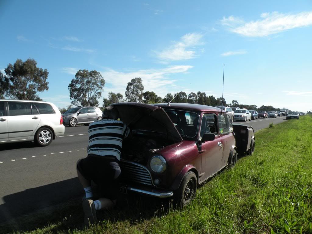

Yes Captain a thermostatic switch could be installed but my view is that it is less likely to be a problem tuning the fan on or off with a simple mechanical switch.
For example, driving towards Melbourne from the Great Ocean Road in OZ our running mate's "automatic" electric fan malfunctioned and his engine temps soared in the Sunday afternoon bumper to bumper traffic.  Pull over, bonnet up and start digging into the wiring etc. to see what was amiss.
<a href="http://s100.photobuc...228da6.jpg.html" target="_blank"><img src="http://i100.photobuc...zps51228da6.jpg" border="0" alt=" photo DSCN3888_zps51228da6.jpg"/></a>
Being someone who designs control systems I like to stick with properly designed automatic systems (if you can call a thermostat "automatic" ).
it's quite interesting to watch people in hot or cold weather - first hint of a bit of snow and they go for the central heating thermostat "oooh turn the heating up....it's cold out there" - why? if it was comfortable in the house at 18C before, it will continue to be so, even if there is 3' of snow outside... anyhow I digress.....
By the look of it, your mate didn't have thermostat trouble, (if he did, then he was looking in the wrong place).... :-)
