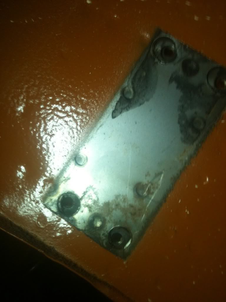

Just to show that even a new bodychell needs close attention:

Blimey!!!
That certainly would be a good rust trap!!!!

Yep, now zinc primed, top coated and it will have liberal amounts of copper grease between surfaces.
