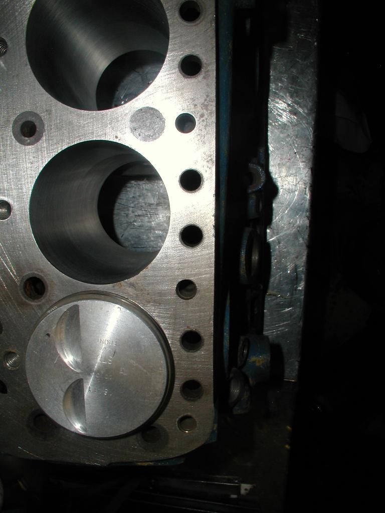

you can fit hillman imp pistons this will take you out to +135 if i remember correctly, you need to have the bores offset machined and you need the pistons which might be hard to find.

Ive heard about these imp piston conversions, but for all that trouble, i'd just rather fit the imp engine
