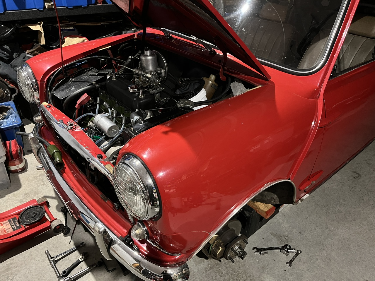

I pulled out the radiator again so I could install the 1100/1275 lower radiator shroud & change the radiator hoses
When I got the radiator out there was definitely signs of interference between the crank pulley and the lower rad shroud bolt!
You can really tell the offset difference between the 850/998 type bracket on the top and the 1100/1275 type on the bottom. There's now loads of clearance.
And a "while you're there" job was to replace the thermostat housing as the old one was getting a bit crusty and I wanted to go to a hotter 88 degree thermostat
I bought a pair of new radiator hoses to try and get a decent one. The one on the left is a Kevlar one from minispares, the middle one is a Gates brand and the right is Mackay. The minispares one has leaked since installation in August 2024, the Gates brand one is smaller in diameter and it's a much nicer fit, the Mackay one is similar to the minispares in size. I had a matching top hose to swap at the same time.
All back together again

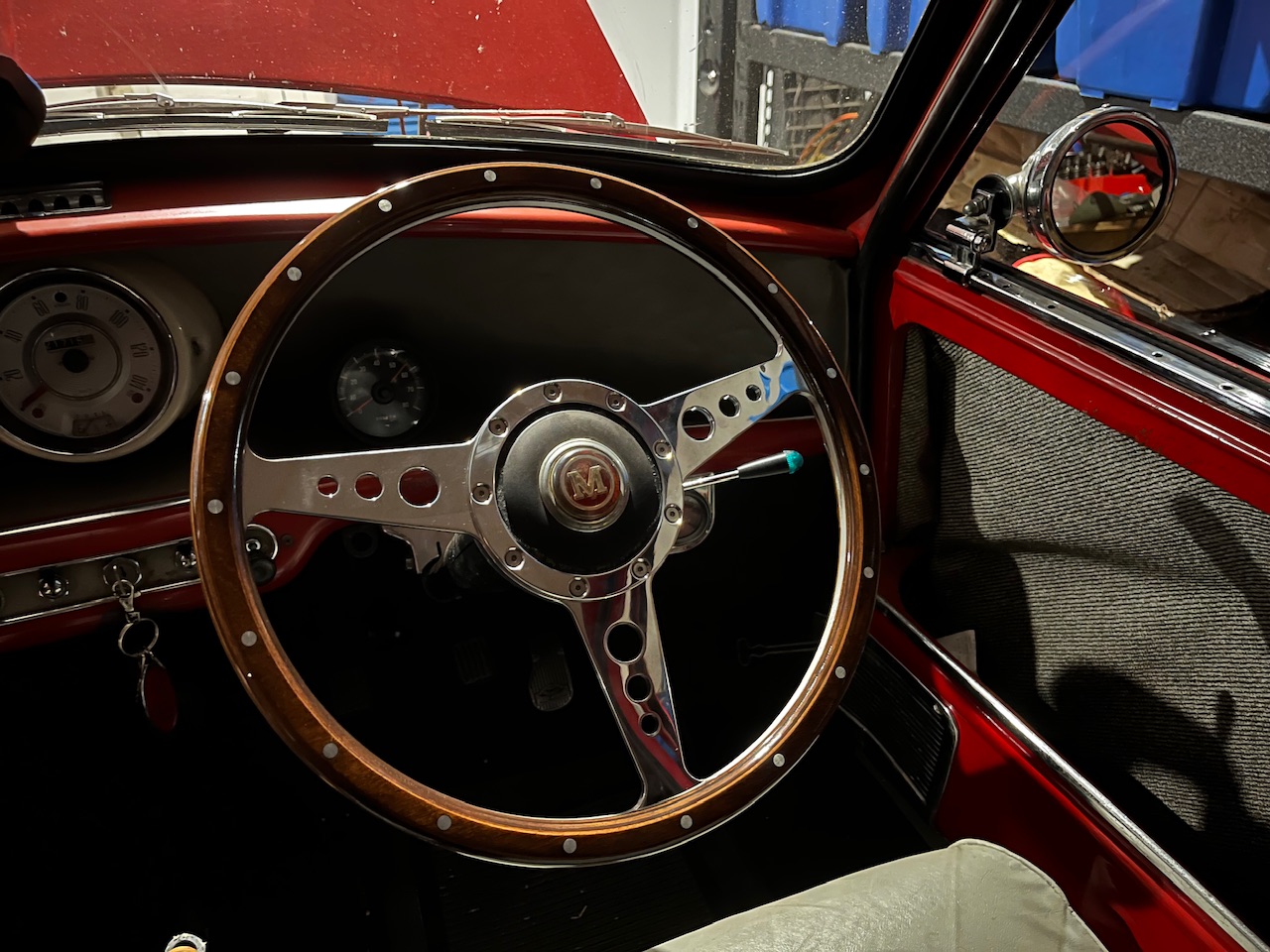

I’d started to get a bit of a weird binding feeling in the steering, on some slight right curves it’d get stuck and not want to return to centre. I had a similar binding feeling on a lot of lock on the left side too. I started by checking out the steering column as I’d replaced the upper and lower bushes a few years ago. There was a bit of the carpet that’d detached and wound itself around the bottom of the column - I cleared this out but this didn’t help.
I also tried a different steering column and had the same issue. Next up I removed the rack ends from the steering arms to rule out the hub ball joints, but they were all OK
The next thing to try was loosening the backing plate for the rack damper, and loosening it half a turn stopped the binding altogether. I’m not sure if this means it needs an extra shim or if there’s a slight misalignment or some crud in somewhere it shouldn’t be. I removed the backing plate and gave the damper a clean but it started binding up again once I’d tightened it back up. I think the next thing will be to remove this rack (Aussie AYA rack that I’d refurbed) and put the original rack back in again while I get this one sorted again. Obviously I’m not in a hurry to do this as it’s a huge job

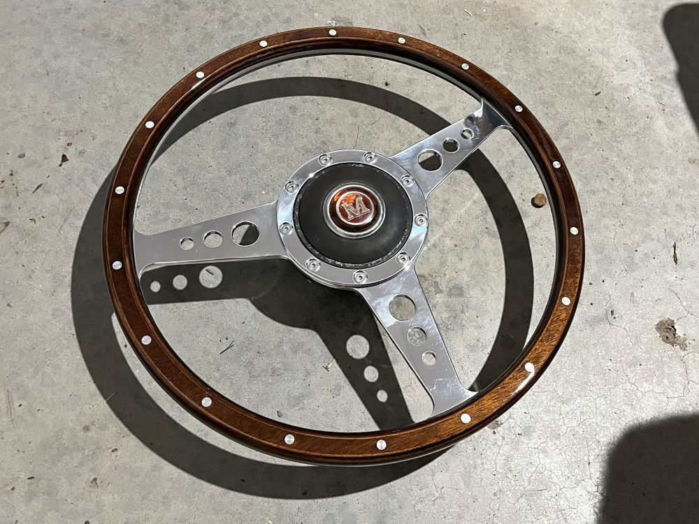

Buying a new steering wheel didn’t help either, but it does look nice :D

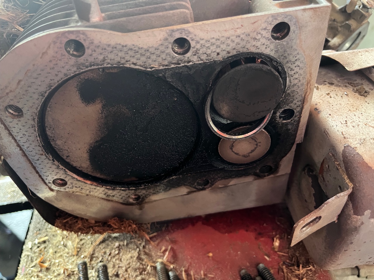

My next mechanical problem was the ride on mower wouldn’t start. Apparently having the valve seat fall out is a common issue on these engines, so I carefully hammered it back in, reused the old head gasket and it started right up and has been fine for a few months!

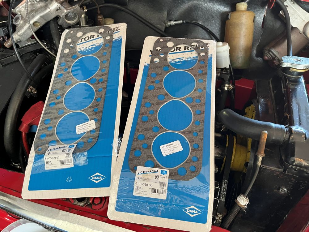

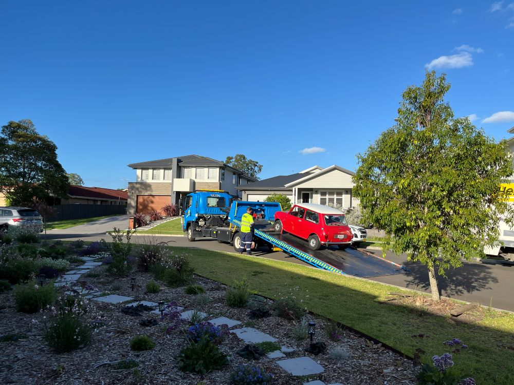

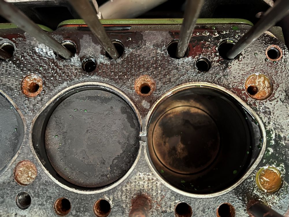

At the end of January I had another unexpected trip home on a tow truck. It was similar to the last few failures, it was idling OK but running on a few cylinders under load
I didn't have a compression tester that I could use by myself, but it was pretty obvious one I removed the first spark plug and I was getting 2 compression cycles per revolution. With the head off it'd definitely blown the gasket between cylinders 1 & 2. One thing I did notice when I was taking the head off was that the head nuts weren't super tight. I don't know if this had contributed to the gasket failure, or if I'd forgotten to check the torque after a few heat cycles
After thinking about a few long term options (get the head machined, get the pistons machined, use a decompression plate, stick to the 2 head gaskets and upgrade to ARP head studs) I was running out of time to get it back together before rego was due, so I decided to stick to the previous setup of 2 x Victor Reinz head gaskets.
I bought a 9 stud ARP kit ( Part number 206-4201 ) from a non-mini parts shop as they're about half the price. I can only assume being made in the US, then shipped to the UK, then back to a mini shop in Aus isn't the most economical method!
All back together again & running fine after the head gasket swap. I remembered this time to re-torque the head studs after the first heat cycle and I was a bit shocked at how much more I needed to tighten them up. Perhaps the 2 head gaskets mean there's a bit more settling after the heat cycle. I reset the tappet clearances at the same time and changed the oil to Pentrite Mini Classic oil from HPR30. So far the oil pressure has been pretty consistent, I decided to try this from now on as it has a lower detergent additive in the oil. I watched some oil wear testing videos on flat tappet engines, and the result was that higher detergent additives can compete with the ZDDP (zinc) and end up causing more wear. After checking the mini classic oil it was specified to have high ZDDP, but a lower detergent level.

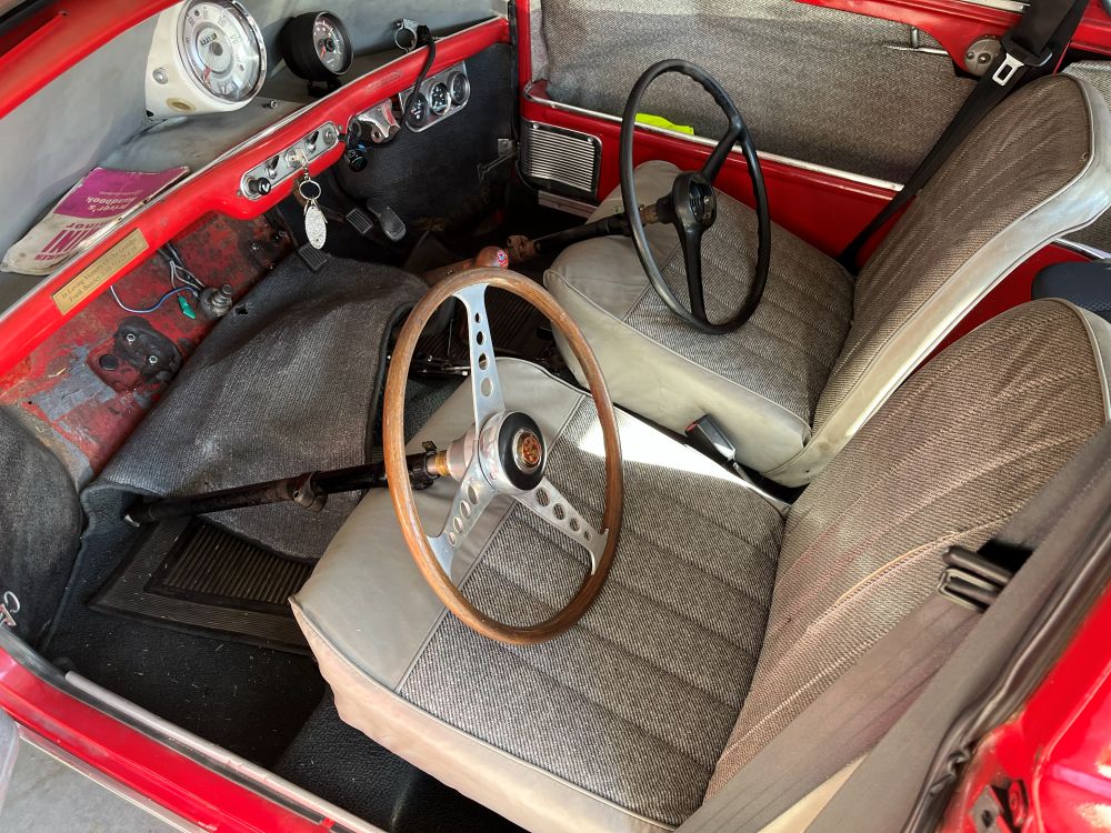

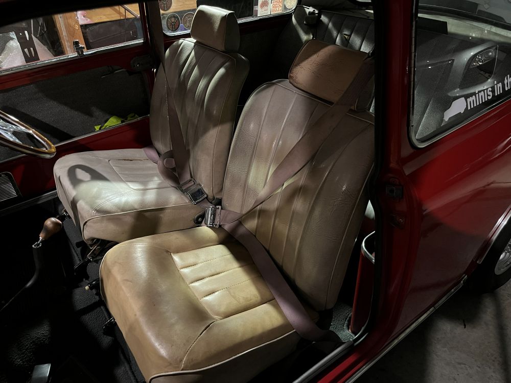

If you've been following along for a while, I've been trying to get the front seats sorted. I'd bought a pair of the black vinyl bucket seats years ago and finally fitted them last year, but I just never felt comfortable in them. I thought the best option was to sell them while they were still as-new and find something else.
And while the original seats are my preference, unfortunately the original upright trim sections are well past their best and tearing further every time I use them. The plan is to track down some original trim and get the seat back either retrimmed or find some good original trims. While they are apart I needed another temporary set
I managed to find a set of later Clubman seats which were pretty grubby, but overall they were in decent condition and they had nice padding on the seat and back and still had decent rubber diaphragms. They were a bargain at $50 and weren't far from home
After a bit of a scrub, and swapping back to the Britax fixed seatbelts they were fitted. They are much more comfortable than my 850 seats, so while the 850 seats are apart I'll try and get some new foam and upholstery webbing to try and get a similar feel as the clubman seats. I also don't feel so bad driving the mini to work and getting back in with dirty clothes

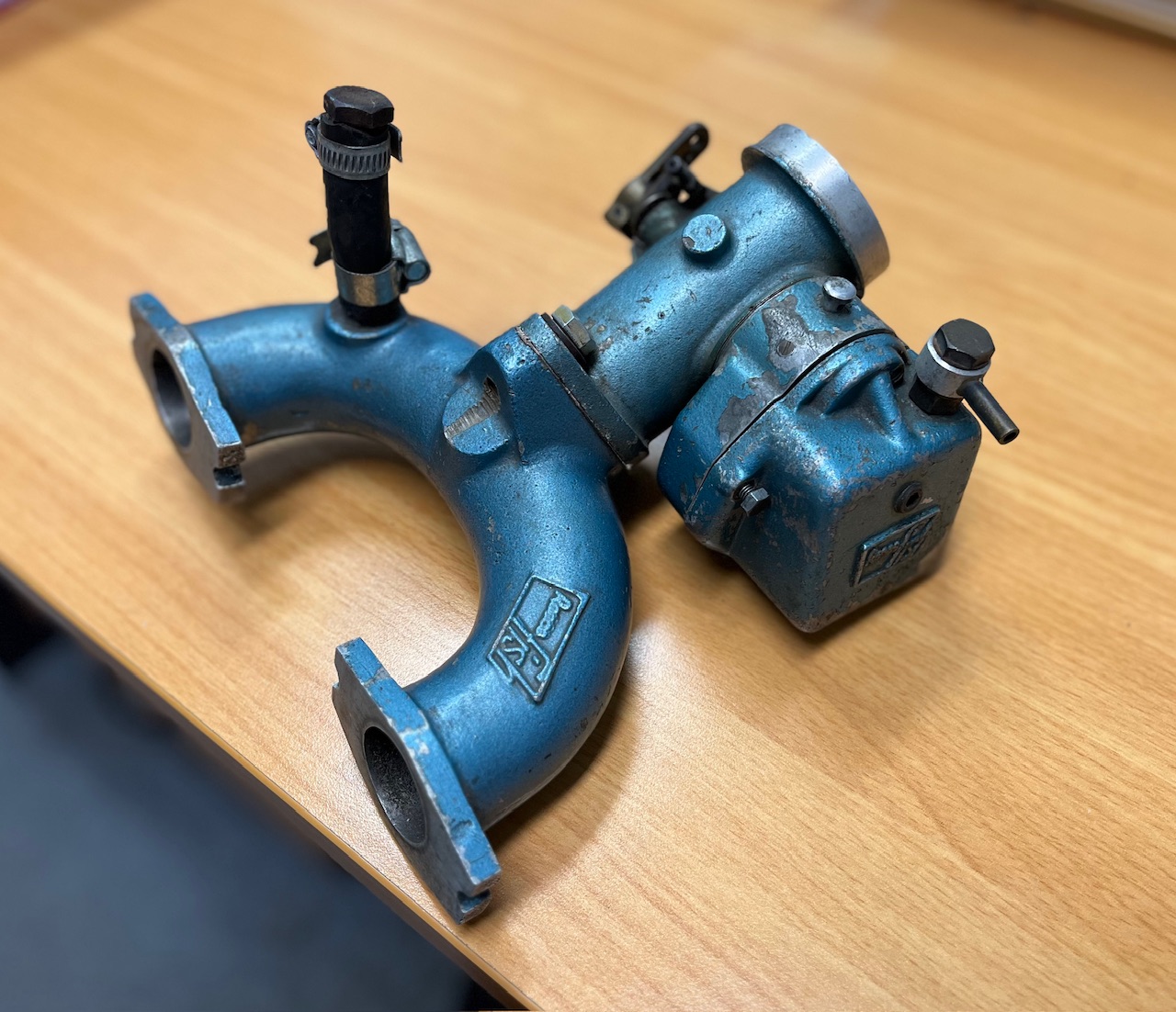

Lastly I found an unusual carb for sale on facebook marketplace for a great deal. I've never seen one of these Reece Fish carbs in Australia before and I was always a bit curious after seeing them in the David Vizard book. Doug (winabbey) has kindly sent me some of Clive Trickey’s mini books which also give a good guide to setting them up. They are supposed to be pretty simple to tune, with no interchangeable parts like jets or needles. There is an Allen grub screw that adjusts the amount of fuel flow under load, an idle mixture screw which allows air to bypass the throttle blade, and the throttle blade is adjustable on the throttle spindle
It's a unique design, as the fuel is sucked up from the fuel bowl via a metering arm (the arm collects fuel from a groove that gets wider the more it opens, allowing more fuel), and the fuel then goes to the holes in the hollow throttle shaft. At idle the fuel goes through the top holes of the shaft, mixes with fuel and them comes out the bottom holes in the throttle shaft. Under hard acceleration the "pump jet" equivalent shoots fuel out of all 6 holes in the throttle shaft. I've pulled it all apart and cleaned it and replaced the one gasket and it looks like it's ready to use. I don't expect it to be as economical and smooth to drive as the current single SU HIF44 but it looked like a bit of fun.

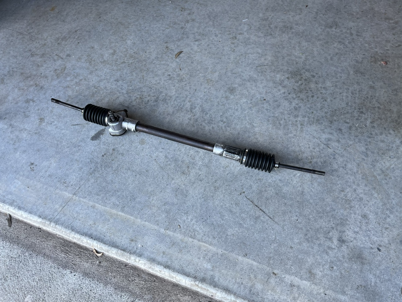

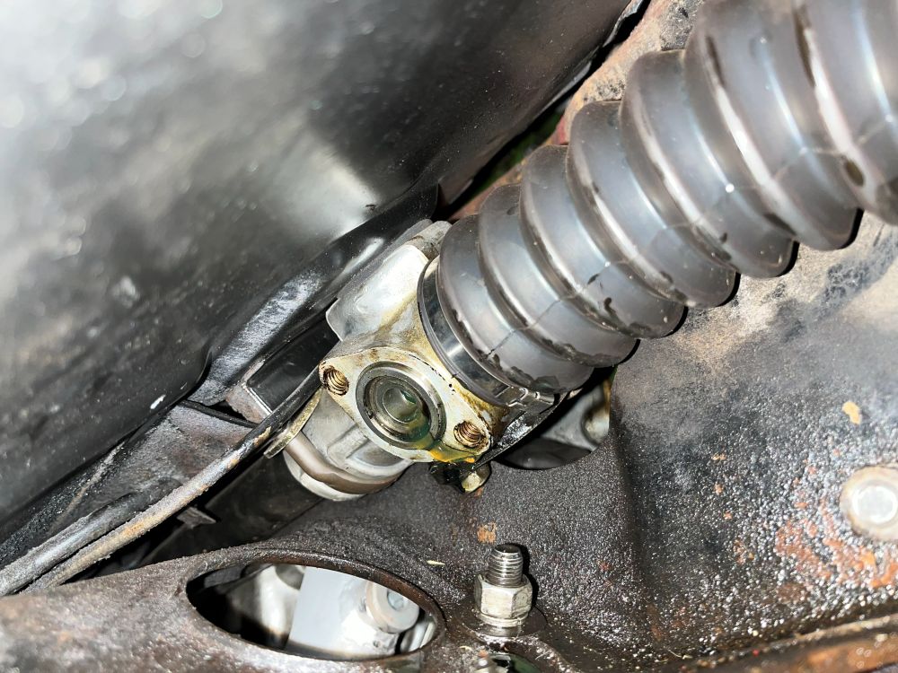

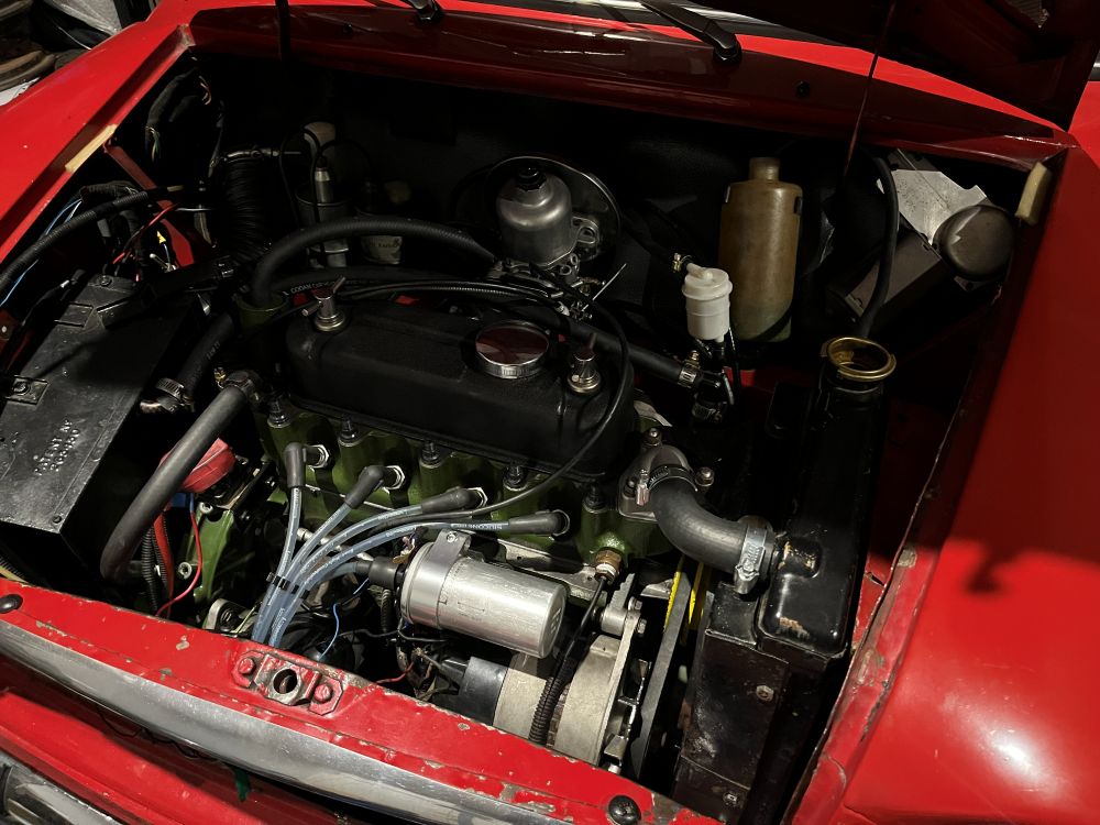

After a few months I’ve finally got the steering rack sorted. The first job was to clean and reassemble the original Mk1 rack with new boots and oil. I left it on the floor before I installed it and the boots started leaking after the first night. I stripped the boots off again, cleaned it all up again and reassembled with sealant again, although this time I left the rack oil off the boots until the sealant had set. It holds the oil now with no leaks!
The original rack is date stamped week 46 of 1963 which seems right for the age of my mini

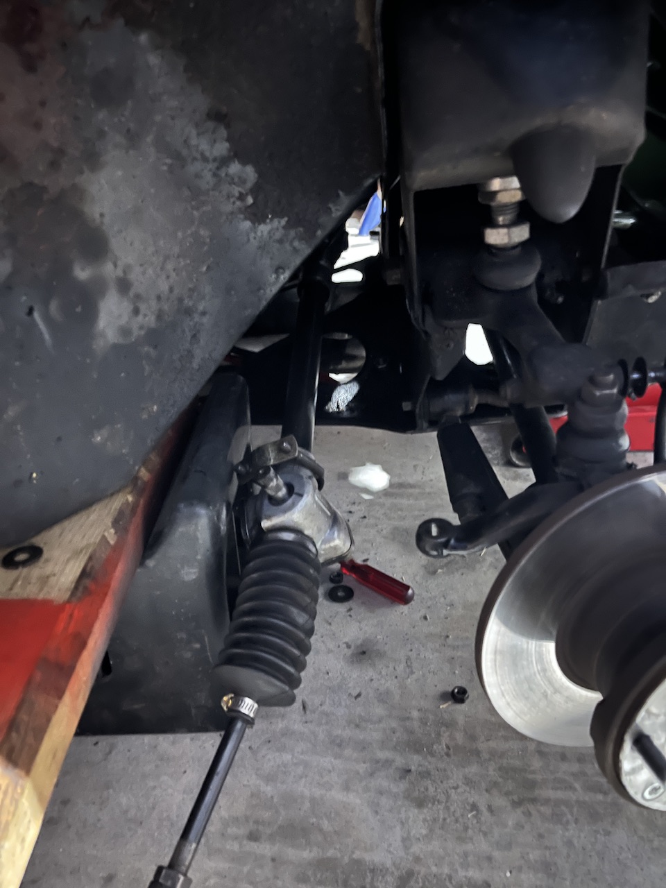

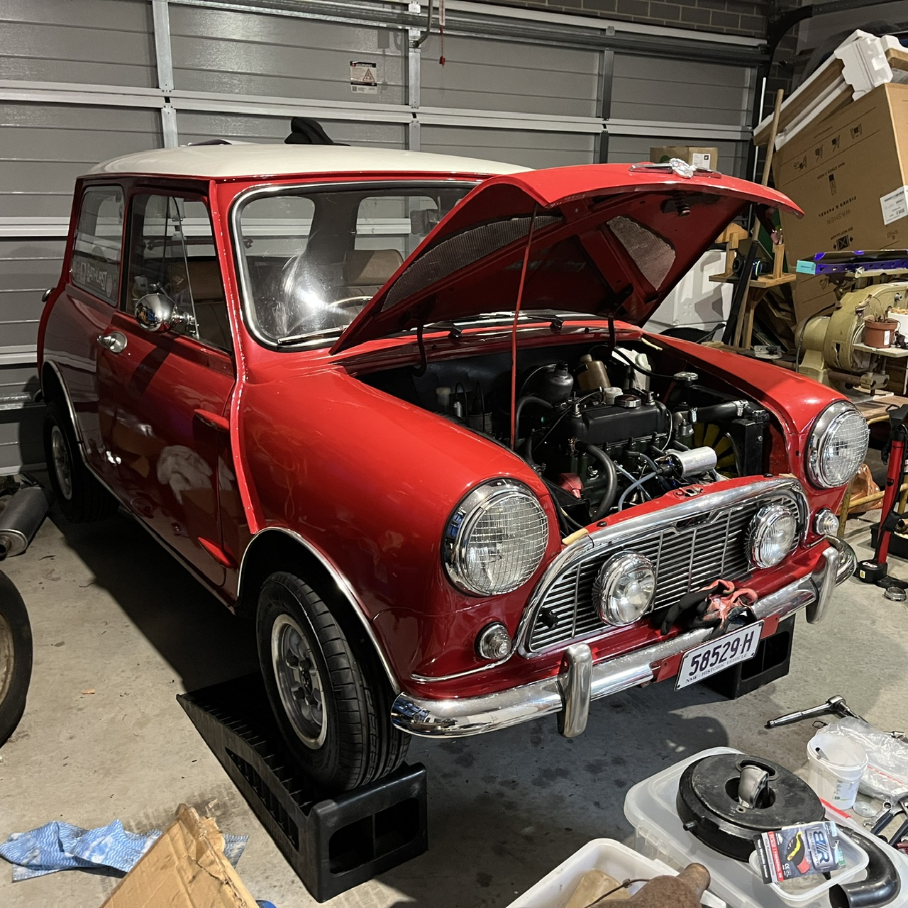

When I replaced the rack a few years ago I completely removed the subframe and engine which was a lot of work, so this time I decided to just lower down the subframe a little bit. I ended up removing the carb, full exhaust, clutch slave, speedo cable, brake line, engine steady, front carpet and steering column prior to dropping the subframe down.
Getting the rack out was a bit frustrating. I could get the u bolt out on the passenger side pretty easily, but the u bolt on the drivers side didn’t have enough room to come all the way out. I had to try the subframe up and down a few times to try and get the right angle so it didn’t hit the subframe.
Getting the new/old rack back was even worse than getting it out. It was a combination of the u bolt, the subframe and just the awkward angle that just made it very difficult. I tried fitting the u bolt from the inside a few times and nipped it up in the vice a few times to get the spread the same. I think it was about 1.5 hours before I got both u bolts through
After that it was a just a case of bolting everything back together, then getting it all up on jack stands for the inevitable “while you’re there” jobs to continue

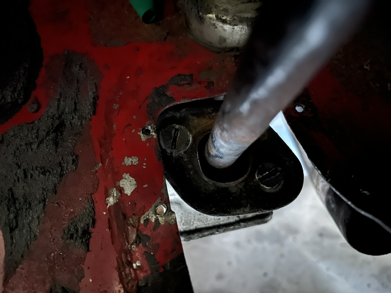

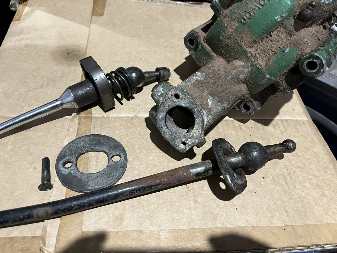

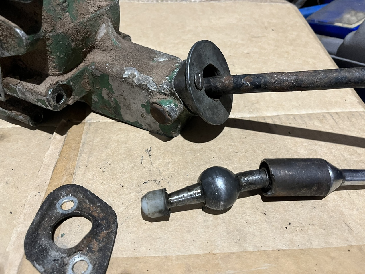

Job #1 was to swap the gear stick in the hope of stopping some vibrations. The standard magic wand setup has a simple metal plate which holds the ball of the shifter into the alloy housing. As this wears it gives some slop and gives metal on metal vibrations. I had a spare remote shifter in the garage with the spring and nylon seat, which also has a spacer to suit. I tried this on a spare magic wand diff cover and it all seemed to fit
It all seems to bolt up OK, and it feels positive shifting though the gears. Hopefully once it’s on the road it’ll drive nicely and stop some of the vibrations
Job #2 was to replace the handbrake cables and levers in the drums. I’ve never had a nice feeling handbrake setup, I’d previously replaced the internal handbrake lever and the shoes, set the adjustment but it didn’t work as well as other minis. Getting the handbrake cables out meant also removing the rear wheels, drums, shoes, followed by the seats, seatbelts, carpet. The new drum levers had slightly longer levers which might give a better ratio on the shoes. The new cables were installed too and were given a preliminary adjustment

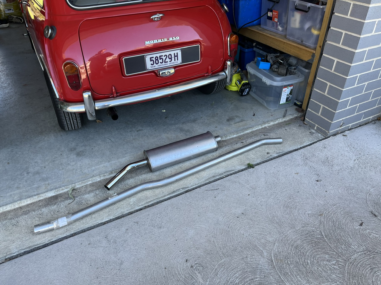

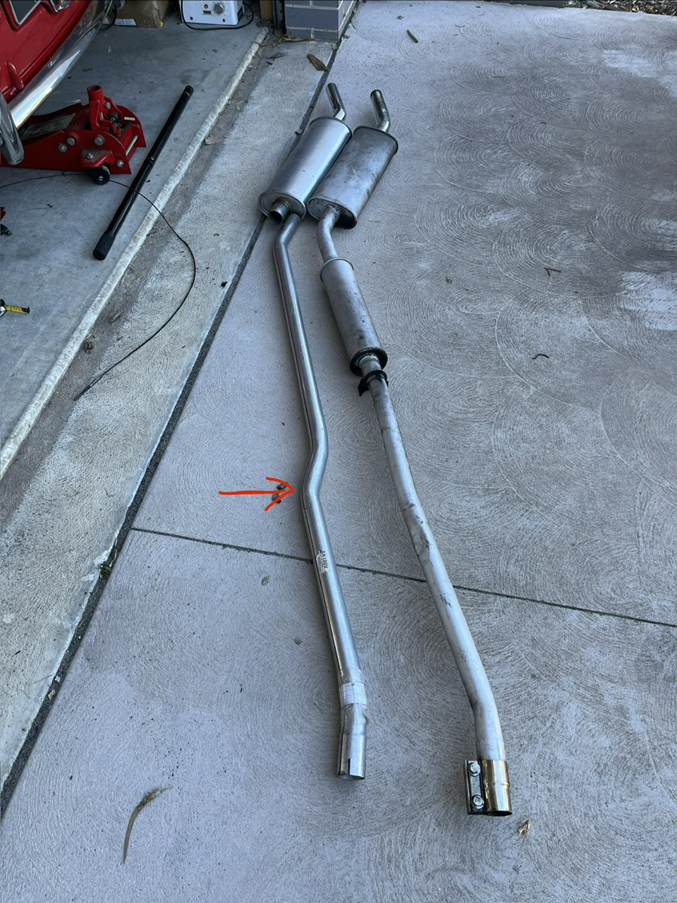

Job #3 was to try a different exhaust. I’ve had the twin box RC40 for about 10 years and while it works well it’s not very loud and I can’t hear it from inside the car. I’ve got a single box RC40 exhaust to try..
I tried fitting the single box exhaust and unfortunately it didn’t fit. The extra kink in the pipe to clear the remote/rod change means it goes straight into the floor starter button. I put the old twin box exhaust back on for now
Job #4 was swapping the abutment plate on the carb so I could install an air box. I found this metal single SU airbox a few months ago, but I needed to track down the abutment plate and some wing nuts.

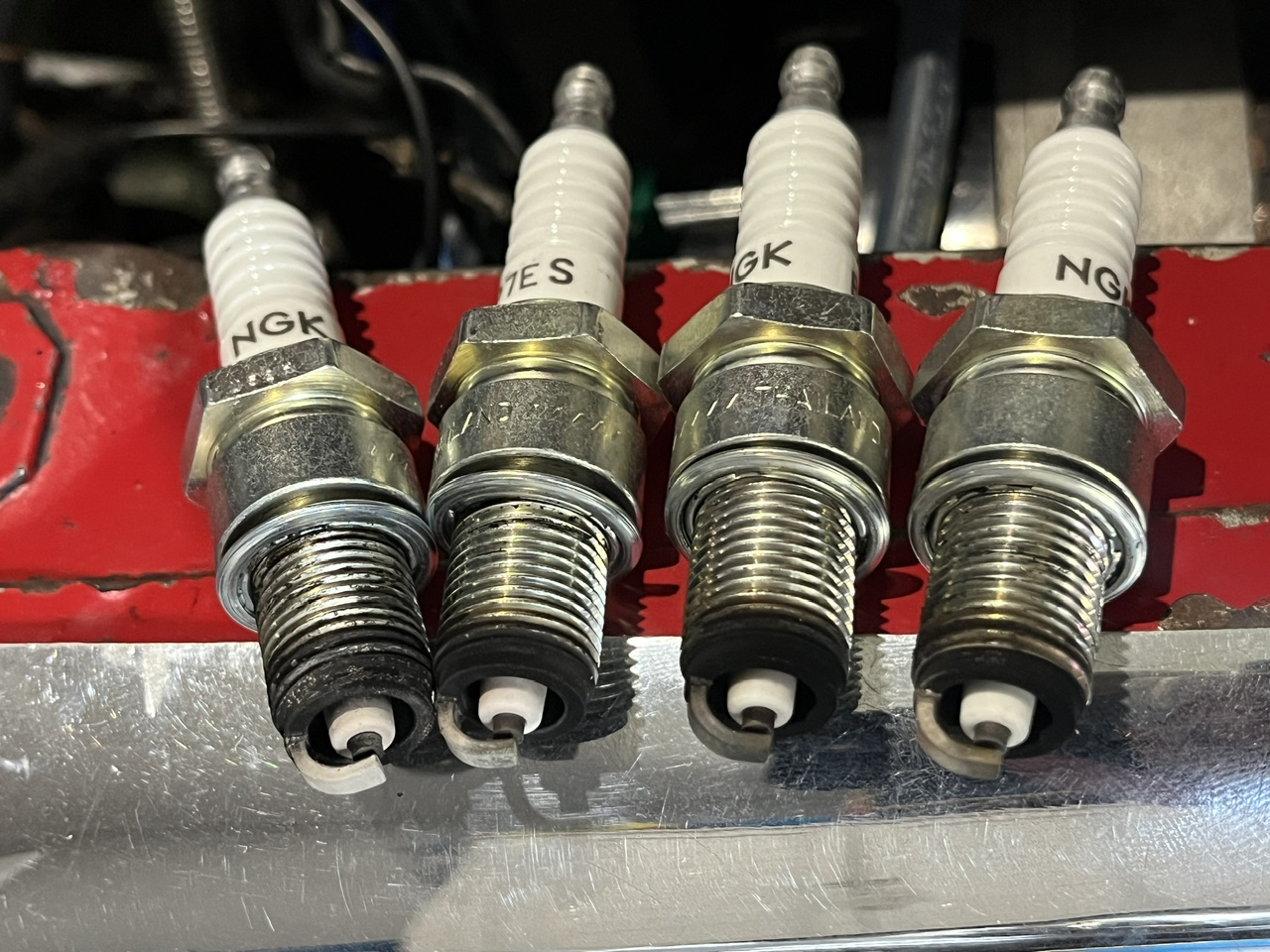

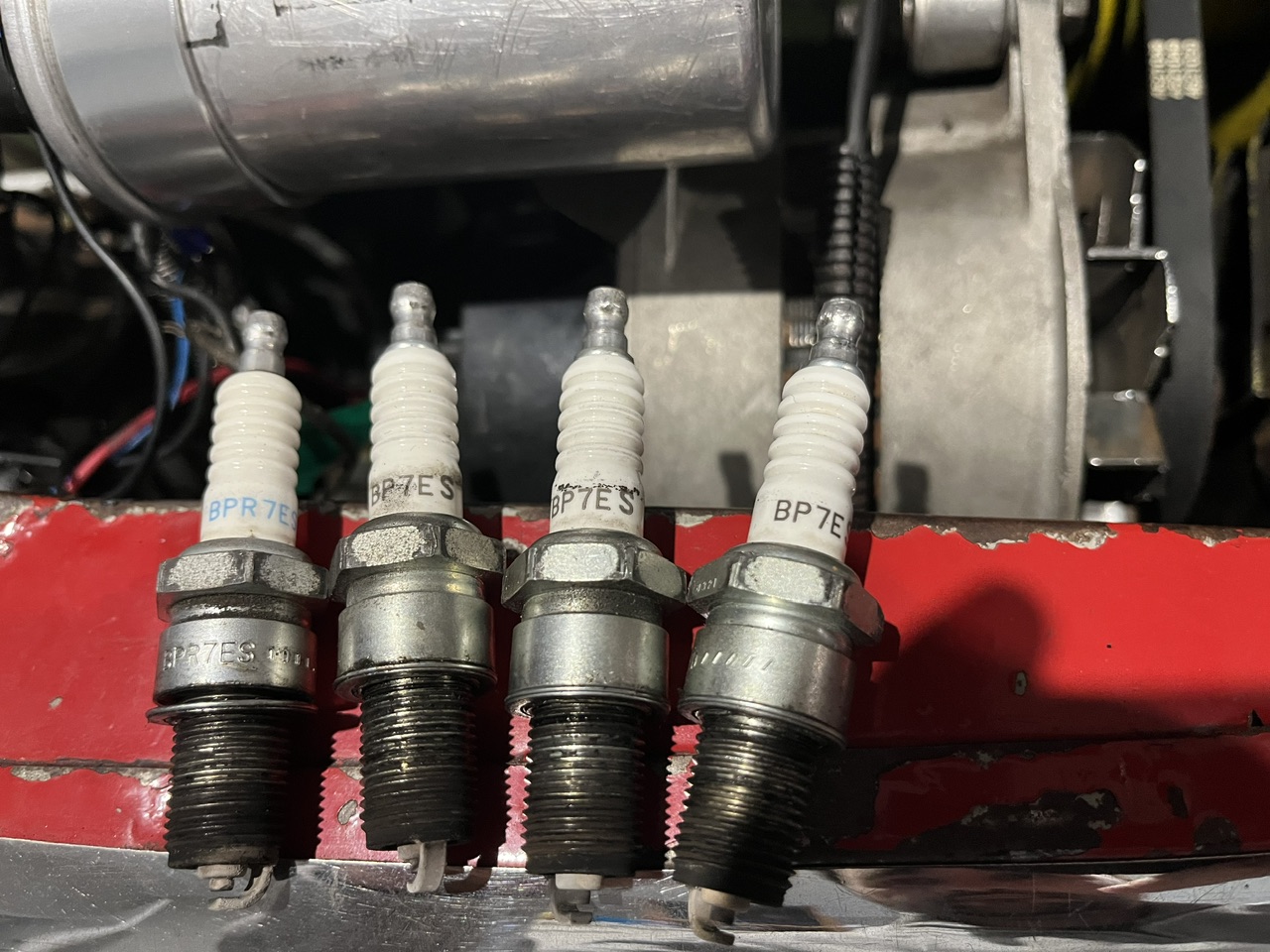

I also noticed for some reason I had a mismatched set of spark plugs (one resistor and the rest non-resistor) so that was an easy fix
The BP7ES plugs are still running great in the 1100, due to the high compression ratio.

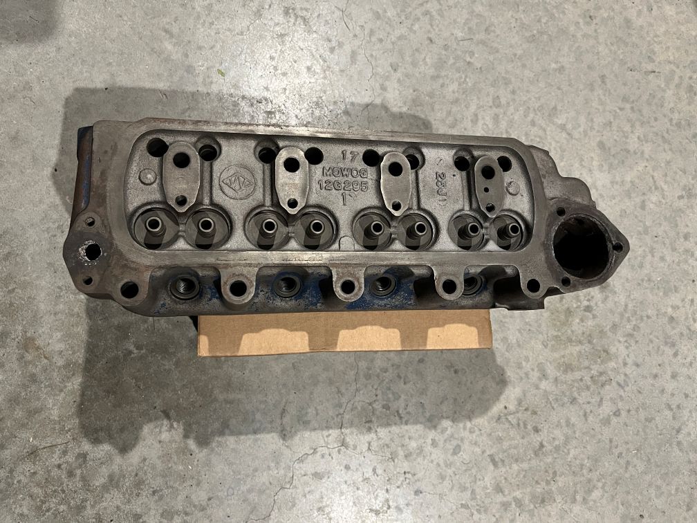

I was lucky enough to finally find a 12G295 head at the right time. It’d had some work in the past and has bigger 1275 valves in it (33.3mm intake and turned down 26.9mm exhaust valves). It’s been to the machine shop to remove a stubborn stud and had a trip through the parts washer to clean off all the old paint. It needs a coat of paint and a final clean before reassembly. With the larger chambers on this head compared to the current 12G202 head it’ll bring the compression ratio down a bit more and hopefully be a bit more reliable. I think once it’s swapped over I’ll send the current head out to be opened up to a larger chamber size as it’s got better valves and unleaded seats
12G202 & 1100 as assembled with one head gasket = 11.5:1
12G202 & 1100 currently with two head gaskets = 10.6:1
12G295 & 1100 with one head gasket = 10.3:1
After all that I took it for a few laps around the block and the steering feels so much better now, no weird binding or tight spots. It will need a final alignment for the toe and another round of brake bleeding and it should be all fixed (for now)
