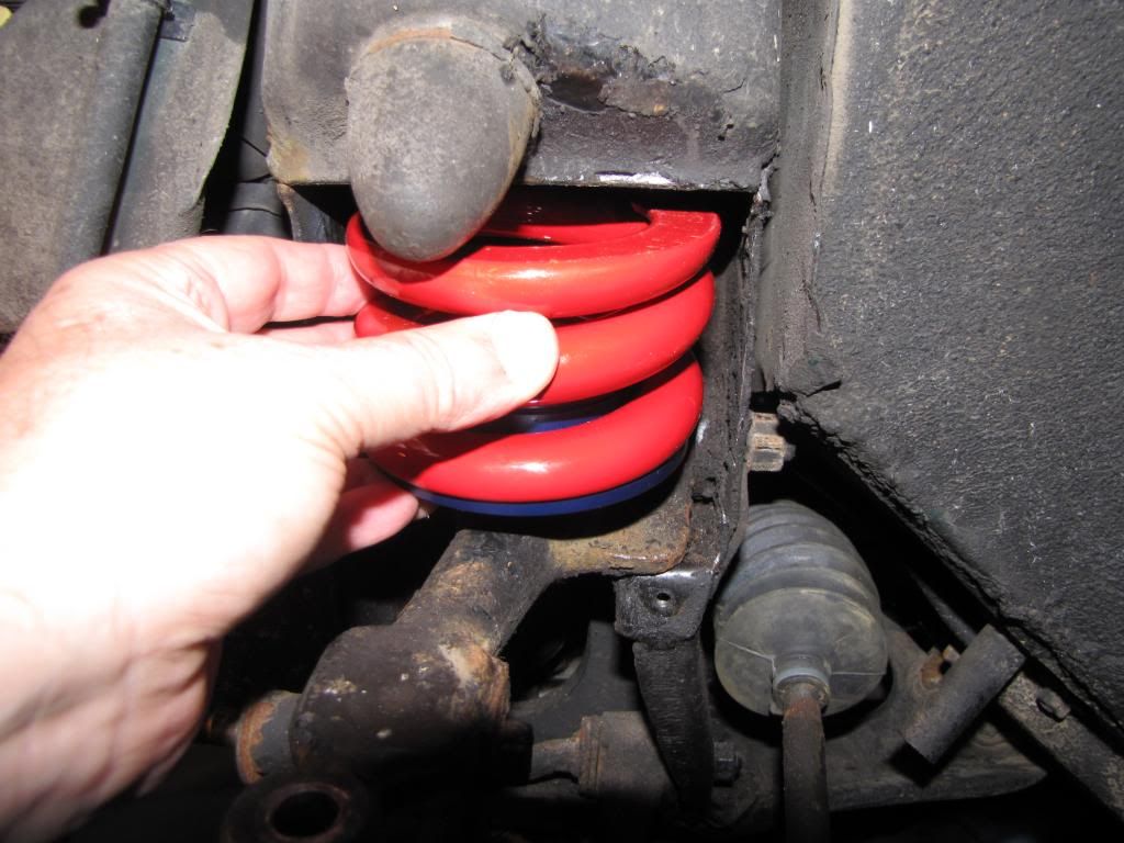

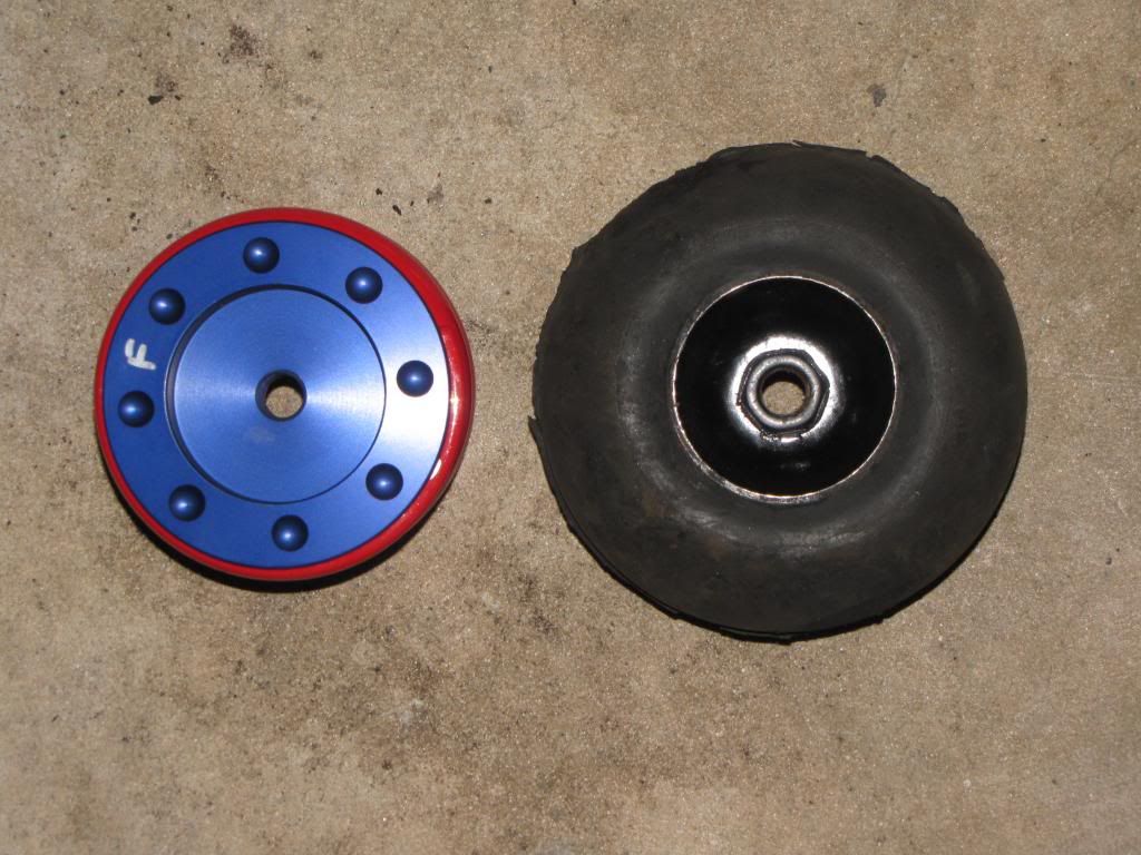

This might give you some insight how to do it. It is From the FAQ's section. The only thing not covered is the removal of the front cones that might require removing the upper suspension arms.
http://www.theminifo...-fitting-guide/
However, the coil springs are much smaller than the cones and they will fit easily with the suspension arms in place.
The hard trick is to pull the old cone out. It requires cutting two flat spots on the outer metal retainer of the cone to "reduce the diameter" and apply plenty of grease inside of the subframe to be able to "lever" out the cone. I used a Dremel tool to cut the flats.
