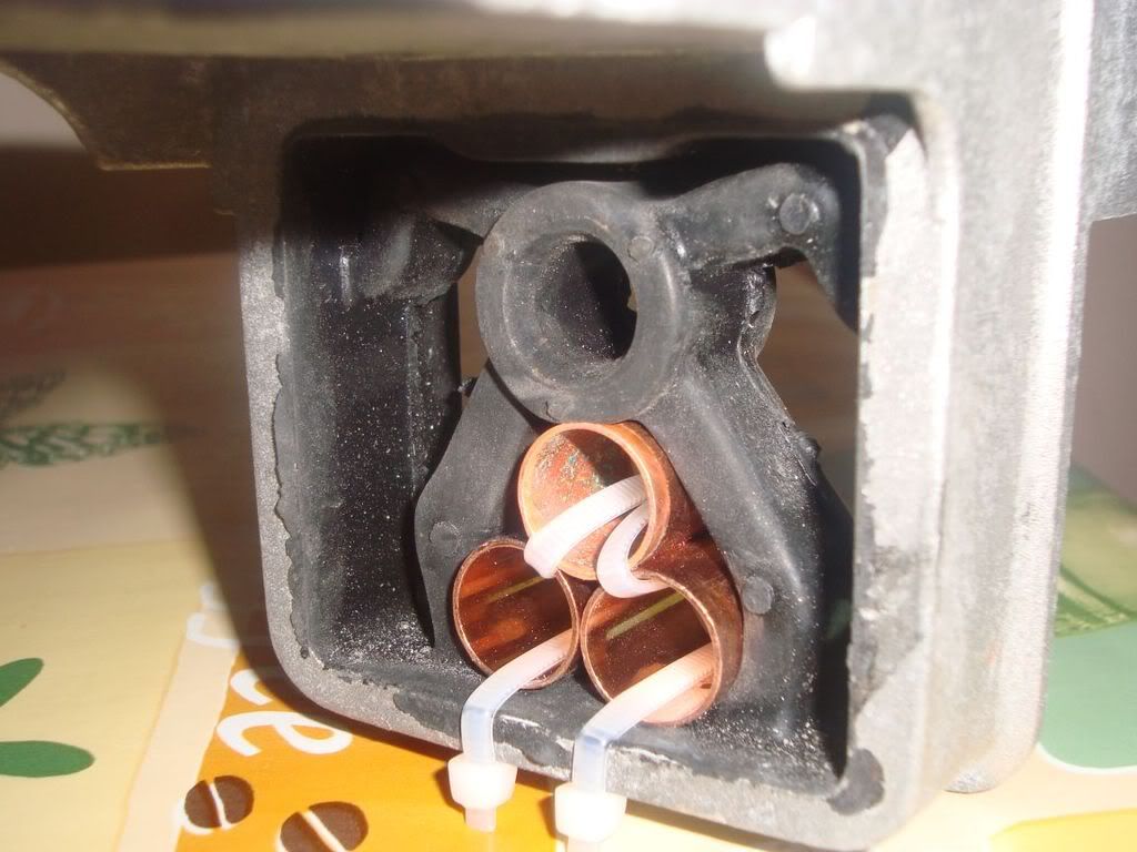

Done front discs and pads, swapped front and rear wheels around, fixed OSR caliper not working properly, fitted new exhaust mounts *had to mod them aswell*
The exhaust mounts are rubbish, so I bought cheap ones and found a common mod to them to stop them breaking straight away.
Similar to this, but not as OTT and using a more flexible pipe in the gap.
