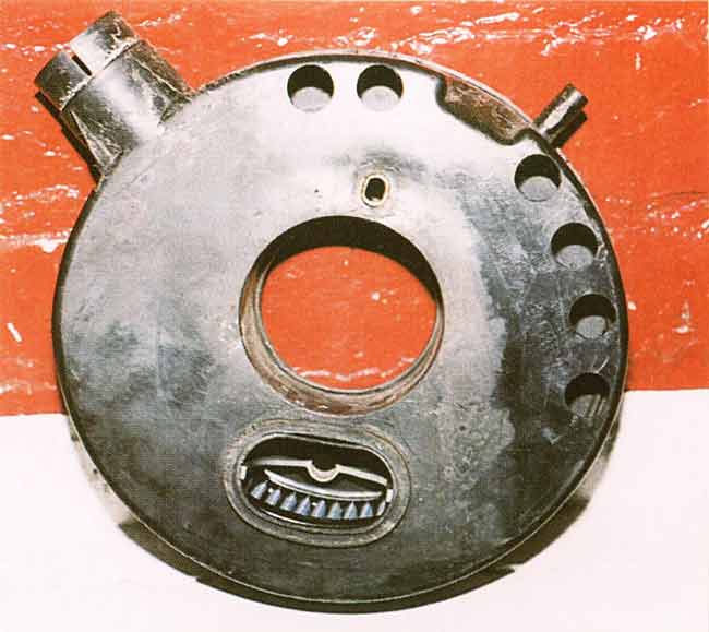

  Changing it for a twin box RC40 or Maniflow would help a little but you wouldn't really notice.  If that's already an RC40 on there you would just need to add the extra box in place of the forward pipe, I'm not sure what exhausts Mini Sport use i their kits.  Really you need to find out what has been done and how healthy it is now before going further.  Replace that cone air filter with a standard air box with a K&N in it and some extra holes around the outside, then check the needle is suitable for that and have a little tune.

Thanks Dan,
Do you have any pics of that air box assembly with extra holes you're talking about?
