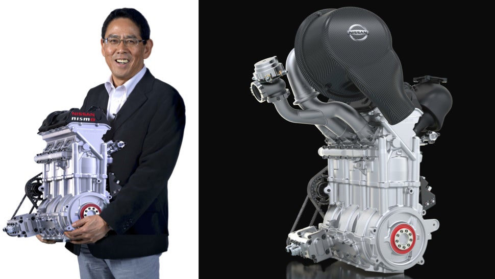

#43 RedRallyMini
RedRallyMini
  • 309 posts
  • Location: Brugge
Posted 27 January 2014 - 06:07 PM
Put this engine in your mini (400hp nismo engine): http://jalopnik.com/...dium=socialflow
