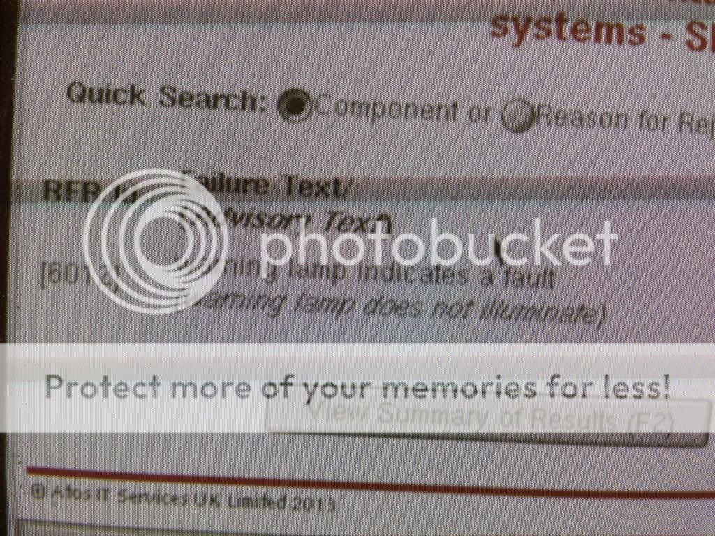

Your warning light for the airbag has to work if you car had an airbag fitted from the factory.
According to samsfern (who is a MOT Tester) on this thread, you are wrong.  It will only fail if the light is on.  If the light never comes on during its test procedure (bulb removed...), there is no option available on the system to fail the car - only advise:
7F802840-6304-496E-8451-E5A46349A5AF-282
