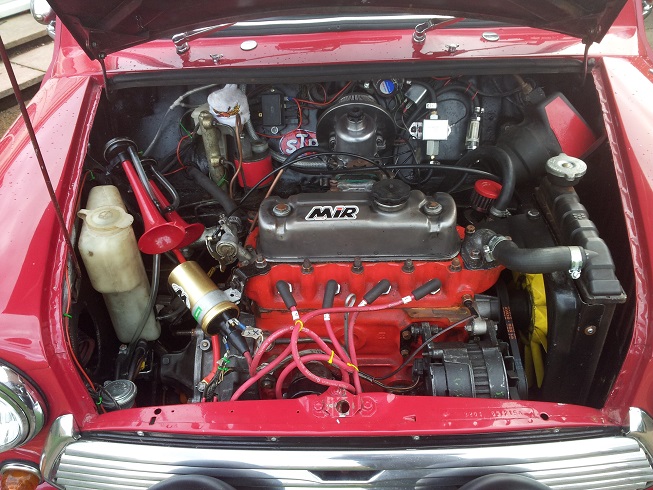

The previous owner of the mini has installed a Facet Fuel pump in the engine bay high up on the bulkhead (about the same height as the fuse box)
Is this ok or can this be causing fuel issues? (when disconnected from the carb the pipe is hardly pushing any fuel out)
Also fuel pipe is going everywhere.... It comes up into a glass filter mounted vertical on the bulk head, Loops around to the bottom of the pump, then to the fuel pressure regulator and then loops above the carb and into the side as you can see in this picture to the right of the carb -
https://gm1.ggpht.co...=w1254-h496-l75

Ok, so that needs sorted then...
Heres the pic again attached on here
