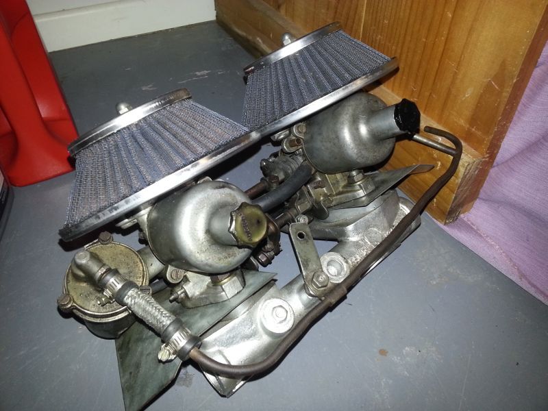

Ive recently got my hands on a 1340cc motor courtesy of one of my friends friend leaving the country. Came with it two carbs - twin SU's and a Weber 45 both complete with manifold etc. See pics.
Based on my uncles (a old school mechanic) instructions ive started bolting on the weber which he believs is superior to the SUs. Since my lack of techincal knowledge ive got the dilemma of which to install and so ive come to the experts!

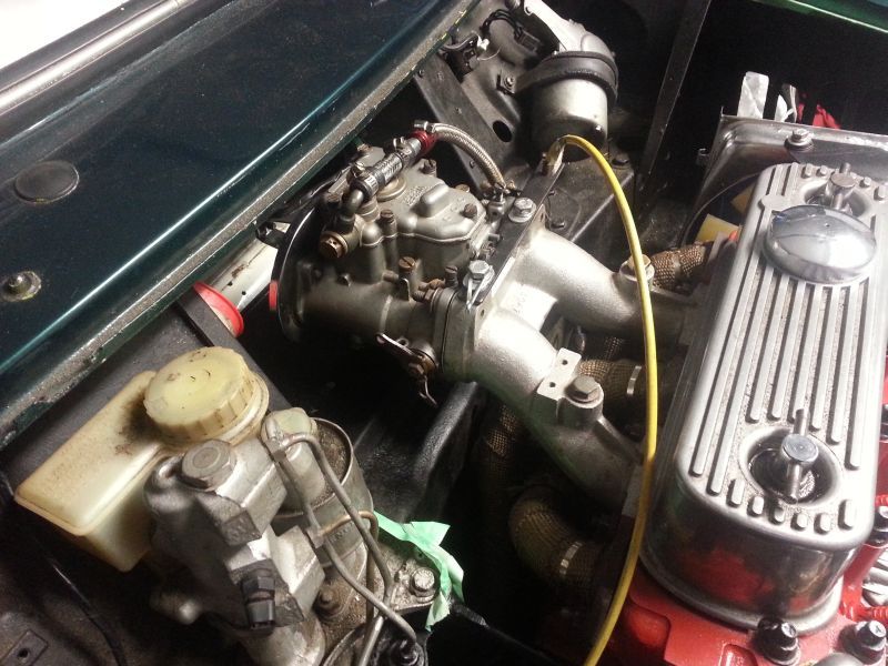

Not too sure about delis but the weber ive got doesnt seem to have any purposely built vacuum take off that I can see with my limited knowledge!! Ive been doing a bit of online reading and have seen that "Dellorto UK" do sell a takeoff bit as an accesory but not to sure where to fit - manifold or carb and if suit weber?
http://www.dellorto....artsectionID=59
Midget and Healey forums suggest either take off from manifold or replacing with dizzy without vacuum takeoff? Not too sure tho for my application
There is an exisiting bolt on each leg of the manifold which i could possibly remove and use as a takeoff spot?

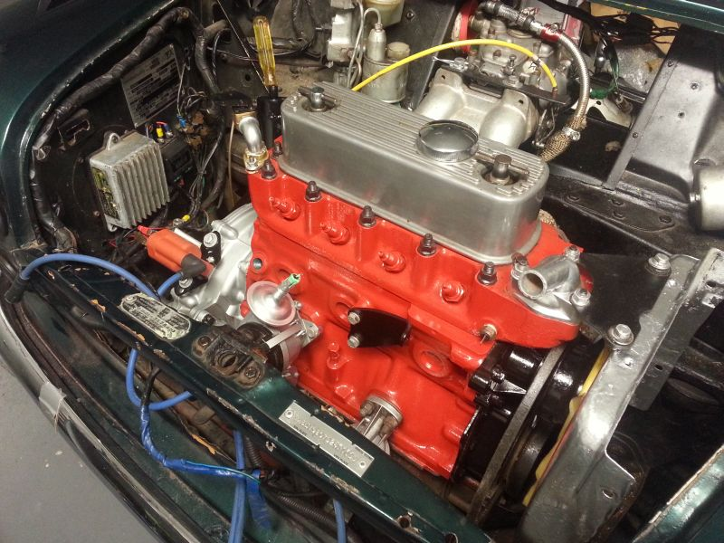

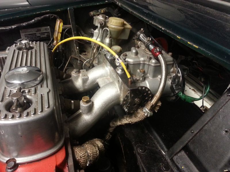

You need to provide some more info about the engine, as a rule of thumb power modifications need to work in harmony with an end game in mind. From the pics that looks like an 11 stud head so what work has been done on the head i.e valve sizes, compression ratio, rockers etc. What camshaft, pistons are you running etc the more info provided will generate more feedback.
45 webers are very noisy (which some people like) and are suited to highly modified set-ups. To answer your question re vac advance, change the dizzy for an Aldon Yellow but again you need to consider any mods with respect to the overall engine design and balance. The down side could be you push all the power up the rev range creating a car thats very hard (and annoying) to drive around town.

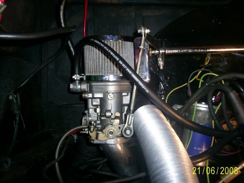

these are the twin deli 36's on my VW engine to help show where the van take off needs to be fitted
you can see the take off port just above the manifold on the same line as the throttle spindle and butterfly
this is the right hand bank carb on my engine and you can just see the vac take off blocked off, the 2 bit's sticking out that look like air take off's are balancing ports

I have a 45 weber on my 1330 and I love it. You can remove one of the bolts on the manifold and get something to adapt it for the vacuum from a plumbing shop. You can just blank the vacuum off if you want to but I find it
better attached. You don't need a facet fuel pump to run the carb either, keep the mechanical one it will supply the carb no problem and you don't have any safety issues that you would with a facet. I manage 116bhp without a
facet. You will need a fuel regulator set at 4psi, they are cheap and a doddle to fit. Go with the Weber mate,

You need vacuum advance on any road car, unless its a full race engine in which case it will have a totally different distributor curve to suit. Regards to extra grunt from a weber, setup correctly there will be little difference between a pair of SUs of 1 1/2" (yours in the picture by the way are 1 1/4s and would restrict th bhp on a well sorted 1330) and a weber 45 except at the very top end of the rev range. Check Vizards book on the graph and its only a few bhp were talking about.
So back to your question it depends on what the spec is of your engine, if its built to 1275s spec and about the same BHP (75) then the SU 1 1/4s will be ok and fitting the weber will do little, if on the other hand your motor is built and your expecting 100bhp then the weber would not be restrictive like the little SUs
The vac take off is quite important as if its sited in the inlet manifold then its subject to a higher vacuum then if its sited slightly behind the butterfly as per SUs and in Bungles Dellortos above. They started fitting later cars with the vacuum takeoff in the manifold for emission reasons as at a given rev it produced more vacuum advance which was a attempt to clean up emmission readings. The problem with it being in the manifold is induction pulsing which upsets idle and the sportier the engine the worse it becomes. Your problem is the Weber was sold as a racing carburettor and is not drilled for a ported vacuum take off, which is only there to aid economy.

I'd be inclined to try a vacuum take off in the manifold rather that try and drill a port in the webers body Patrick, and then see if it pinks on the transition from cruse to power initially, I searched the web and they all advise against drilling the weber body. whats the spec of your engine by the way and what distributor do you have now?
Edited by KernowCooper, 21 April 2014 - 09:03 PM.

taking the vac from the manifold wont work
take for example your going down hill with your foot off the throttle, a vac port on the manifold will see a lot of vacuum as the pistons try and suck air in but the butterfly is closed
where as a vac port on the carb in the same situation will see little vacuum as the throttle butter fly is blocking it
now as you reach the bottom of the hill and start to put your foot down a vac port on the manifold will see the  vacuum drop a little as air can now be sucked in
where as a vac port on the carb in the same situation will see the vacuum increase as the throttle butterfly isn't blocking the vac port and more air is being sucked into the engine
