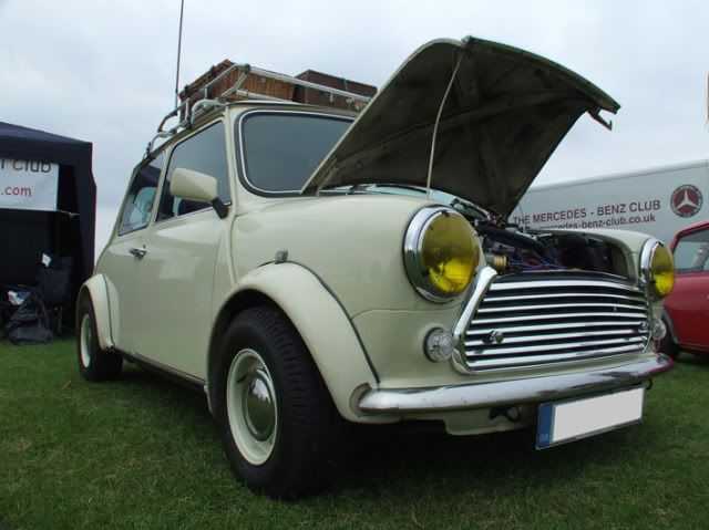

Not my images or cars but might provide inspiration ;)

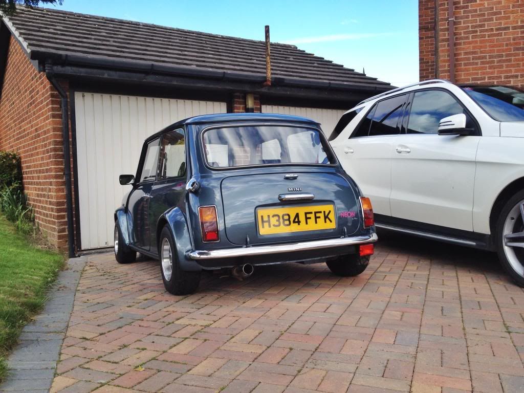

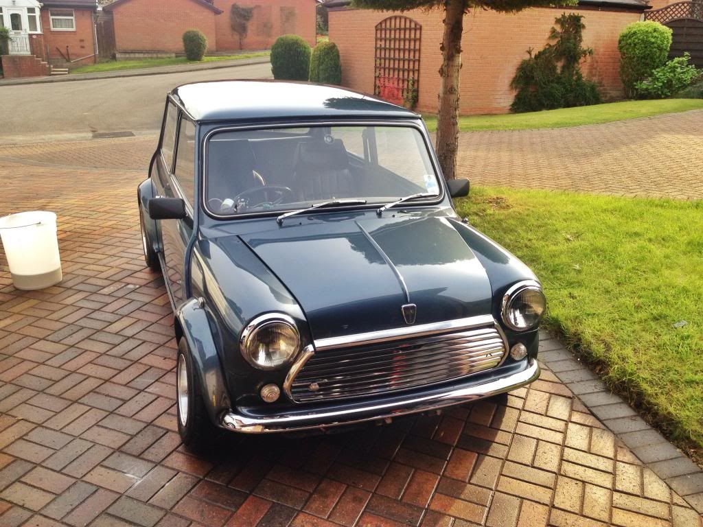

How mine sits on 10x6 at the moment and soon to be 10x7
6FBBEE2B-CC82-4EC7-90D8-415FD66615AF_zps
114B100B-4651-4249-A658-EA560B88638A_zps
B3F0CE07-CE0E-410C-B11F-3BE1C44EE43D_zps
