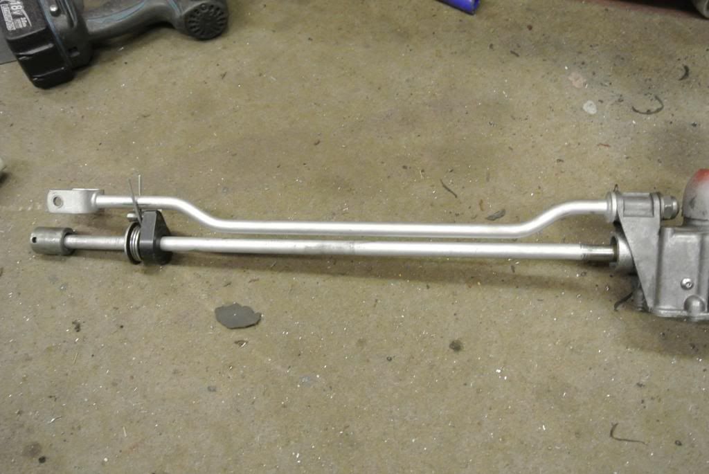

anyone have a picture of the bias barrel in place?
Thanks,
Rod
#6 Tupers
Tupers
  • 4,174 posts
  • Location: Devon
Posted 28 June 2014 - 07:48 PM
#7 rodandtom
rodandtom
  • 998 posts
  • Location: Dover
Posted 28 June 2014 - 07:59 PM
Bloody hell! I thought it went inside the linkage box where the gear stick comes in to! No wonder I was having trouble fitting it :-)
Thanks,
Rod
