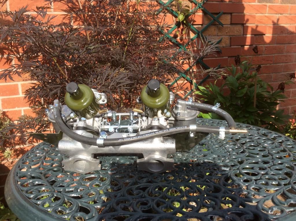

Plus you may find the black plastic spacers are about 2mm thicker than the ally ones giving you just enough clearance for the linkages to move....;0)
Cheers james
I've already got the plastic ones !!

Or in your case going off your first picture.... The left hand side flat lid has 2 brass tubes..... The one going to the left ( in the picture ) connect to your fuel pipe , then just connect a pipe from the other to the other
Cheers James
I think I just sort of repeated what you said :)
