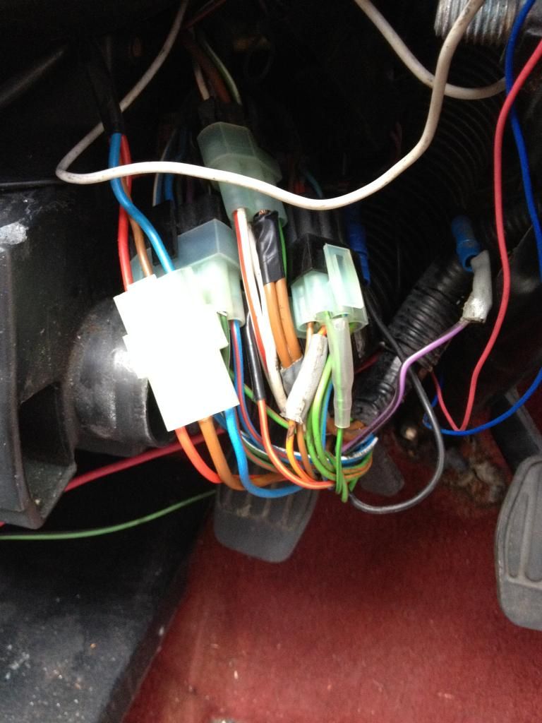

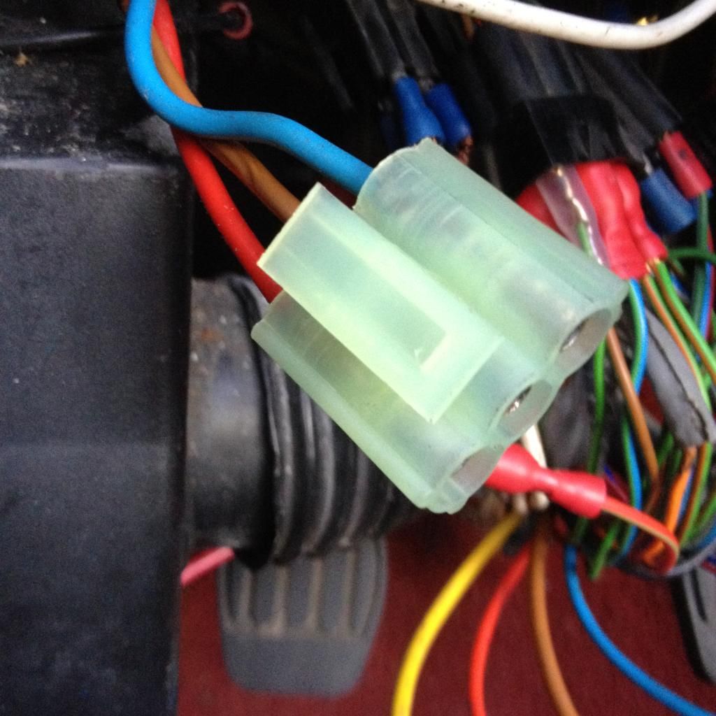

Quick bump... turns out my crimpers already had the bit for doing uninsulated terminals. I was getting mixed results so in the end I've been using long nose pliers and a dab of solder.
My mini has an MPi column and I've been replacing the plugs at the bottom as it didn't come with any!
I havn't got the finished photos, but here are some in-progress ones!
This is what I had, I know, it's appalling!
As I don't need my headlamp switch anymore, I've added a plug where the switch receiver was.
All plugged up!
I've now moved all this behind the dash and such so it isn't on display as well as getting rid of some PO wiring.
In other news, my fan cut in on its own for the first time this weekend after I replaced all the wiring!
Just need to replace my radio loom now.
