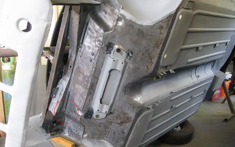

Hi everyone, currently replacing my accelerator cable thought it would be a simple job, but turned out to be a pain, the old outer sleeve that fits into the bulkhead has snapped off managed to get it out but the whole thing came with it, so now have a hole in the bulkhead and nothing to retain the new outer sleeve of the cable. Has anyone come across this before and what did you do to solve it as there is no off the shelf replacment, I was going to drill out the old rusty sleeve and re-weld the retaining grommit bit back in. I have a photo I found to show which bit I am on about (sorry if this is someones hope you dont mind me using it)

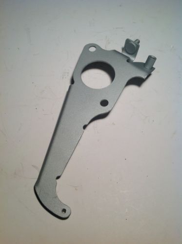

I came up with a genius idea for a replacement though as you cannot buy them.
you will need one of these which can be picked up cheap.
T2eC16FHJGwFFZe6u8YBSVEkfRpYQ60_12_zps2b
Then you need to carefully cut the top where the other end of the throttle cable is retained, and remove the collar from there. This can then be welded onto the bulkhead inn place of the missing one.
Hope this helps you.
Ben

Thanks alot Ben so is that a abutment bracket for HS4?
#4 Ben_O
Ben_O
    Mill Road Garage
  • Paint Doctor
  • 9,794 posts
  • Location: Isle of Wight
Posted 01 August 2014 - 10:51 AM
yeah,
Here is on on bay of e http://www.ebay.co.u...=item1c43dce8fa
