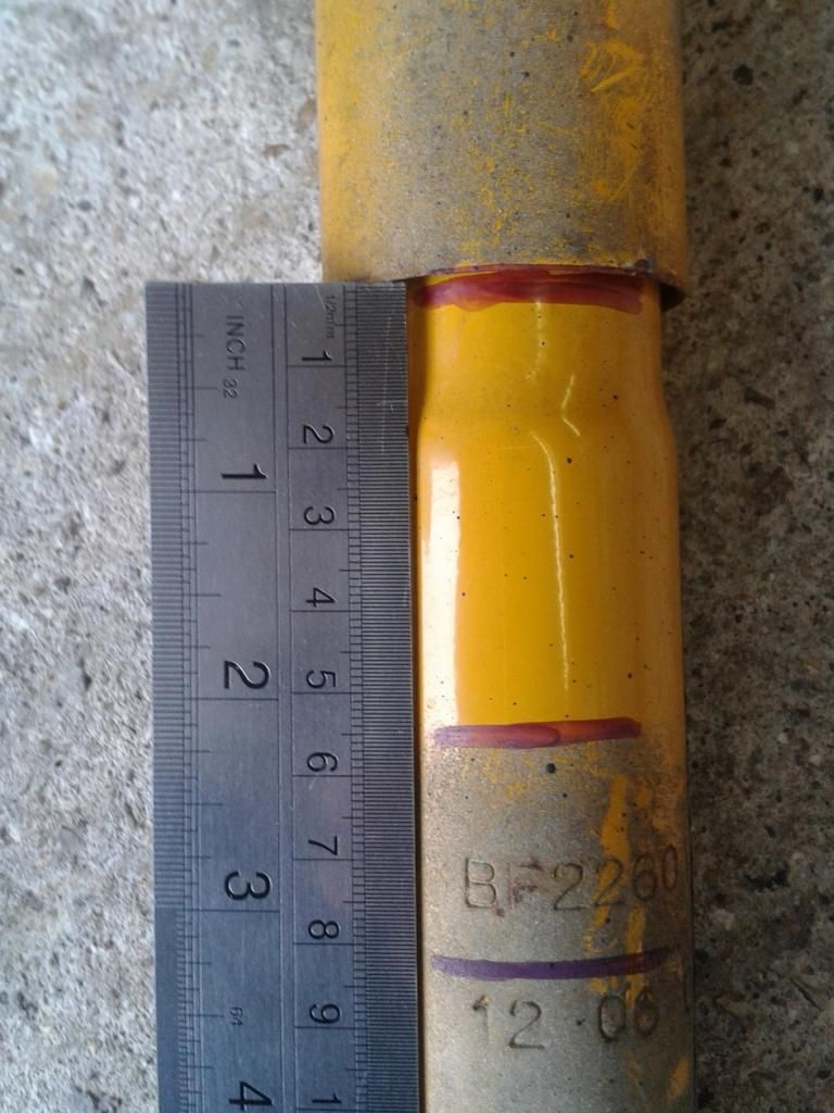

Not required really. If you get a standard height shock absorber and compress it it has a LOT of travel. When i was having a discussion with one of the chaps at mini spares he said that a standard shock will be fine for lowering up to 20mm. I lowered far more than that and still didn't bottom out the shock.
Edit:
I've got some standard hight Gmax shocks in the garage, i'll nip out later and grab some pics for you and post them up of it compressed and open.
Edited by Yams, 01 September 2014 - 10:54 AM.

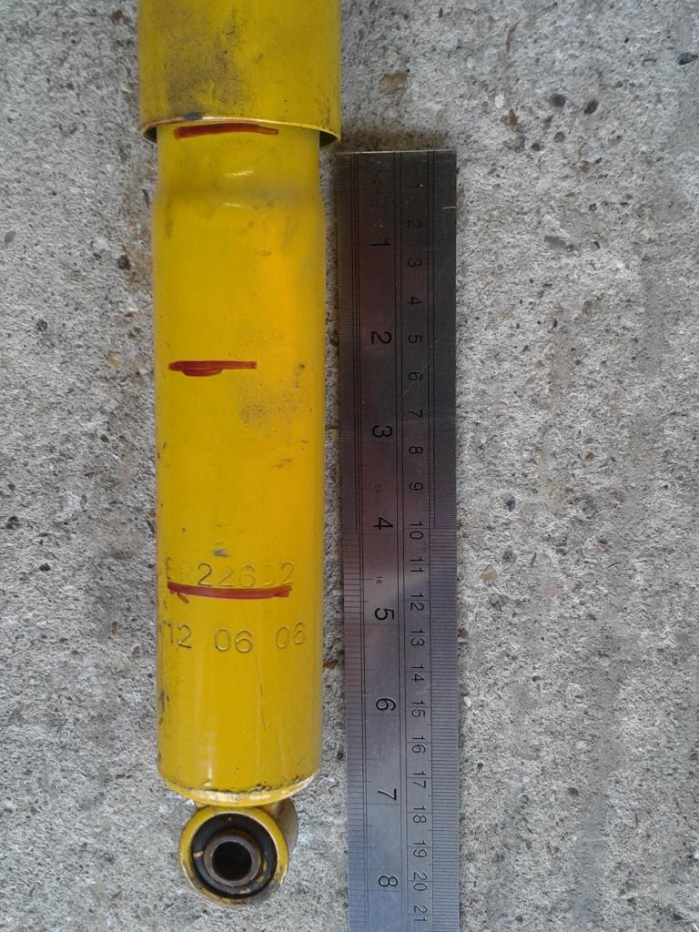

Ok this should give you an indication of the travel. The top line is obviously the shock opened all the way, the middle is the hight i ran, the bottom line is where the shock absorber bottoms out.
front shock
Rear shock
Plenty of room for suspension travel in my opinion, my ride hight was around 50mm lower than standard and the shock never bottomed out.
