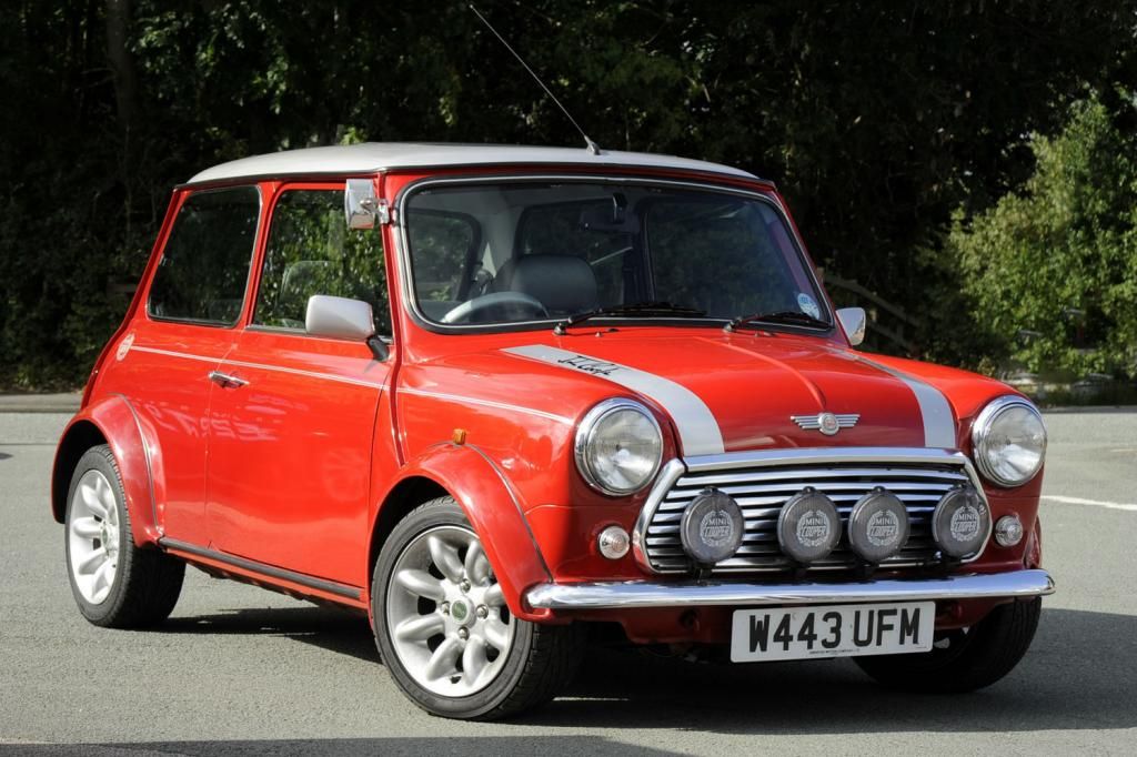

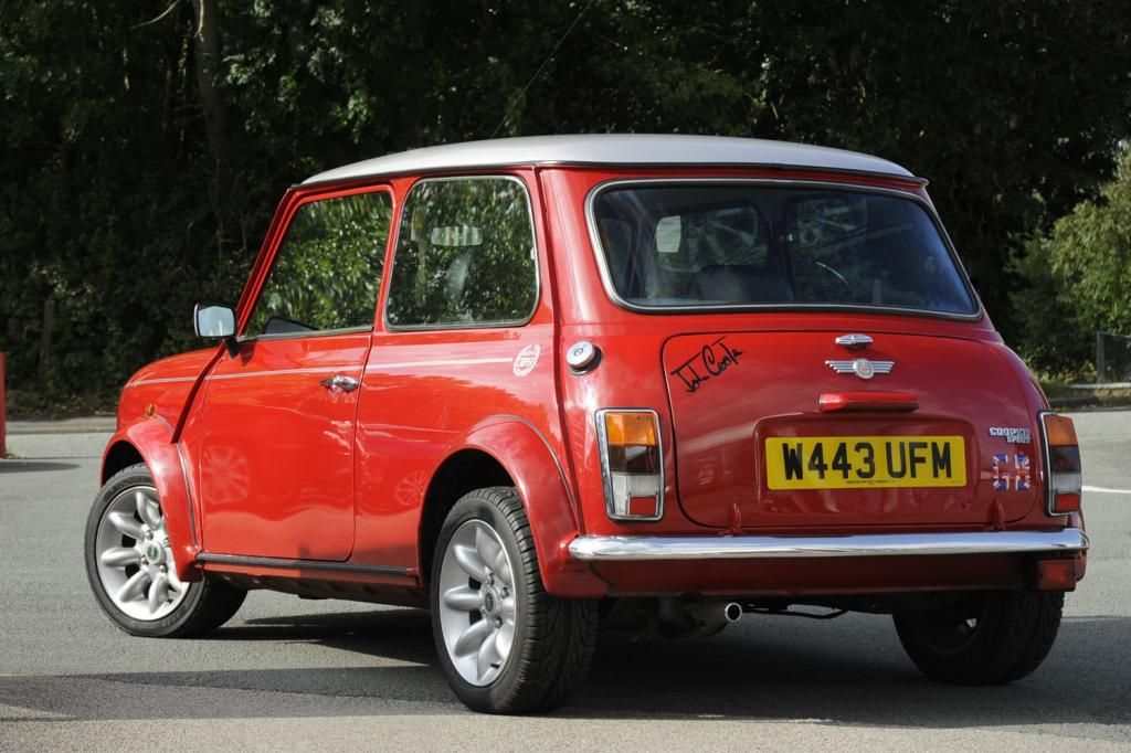

Hi All
I am considering buying a car and wanted to know if anyone new any history about it. Its for sale at a local garage and i had a quick look last night when the garage was closed. It looks quite good from my untrained eye but is it priced about right? Its a 2000 W reg car with 39k miles. The bottom of the drivers door has started to rust under the paint and theres a tiny patch starting near the passenger side drivers lamp. The roof gutter has a tiny patch of rust just above the centre of the rear windscreen. It has new sills and the inner arches looked immaculate and freshly sealed.
I plan on going back to the garage this afternoon to have a look under the boot and bonnet etc. Ive read guides on here so have a rough idea what to look at. Is there anything i should be worried about that others can tell from this ebay advert?

That looks really clean, although I would go over it with a fine tooth comb as they say. Lift carpets and check for rust everywhere. These later cars fall apart quite quickly. That said, on the face of it, it doesnt llok bad at all.

I have zoomed in as much as I can on my pc, its looks like it may have cover sill on. If you see this post before you go and view, take a photo of the sills and post on here.

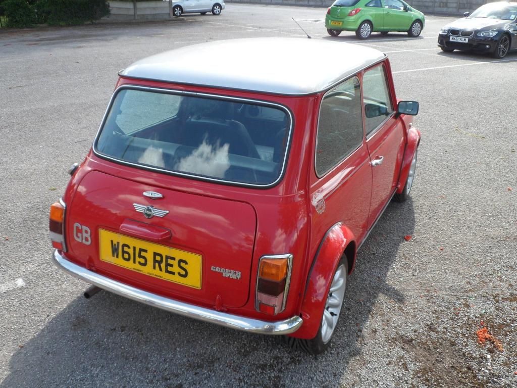

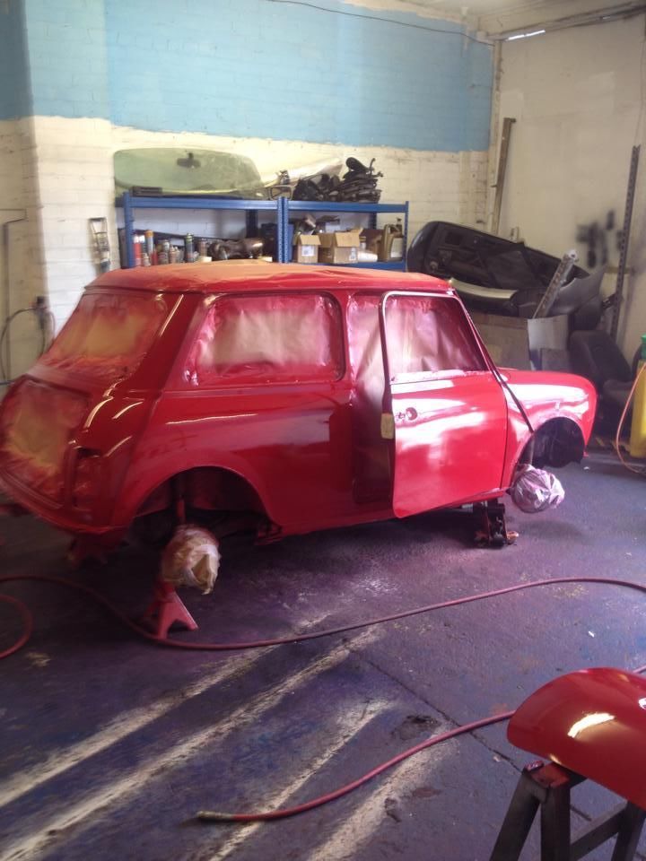

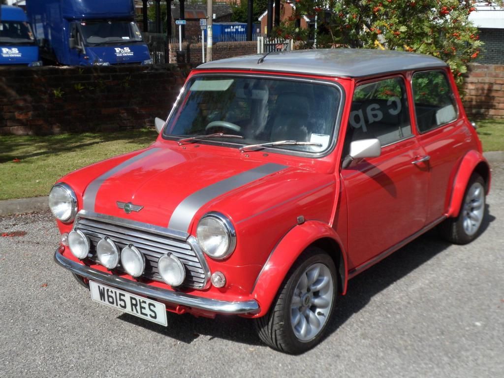

Looking at the ebay ones the prices vary massively dependant on condition. This one has full service history with decent miles but i appreciate condition is more important than mileage. I thought it was priced fairly for a cooper sport if i could get it down a bit and i'm happy with the hidden areas. This one finishes soon on ebay and has had some rust treated and full respray. Has anyone any experience of the mersey mini centre? Theres no mention of service history with this one.

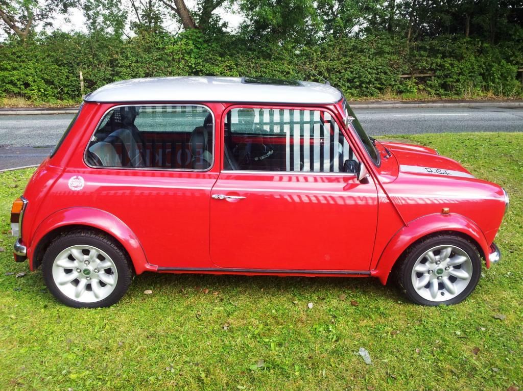

That paint job doesnt look very good to me , and that second picture shows the end of the sill has been poorly finished off with the welding visible , with what looks like  a missed bit or hole to let the rain in !!
 Ebay is not particulary good , as all the cars are high pricied , not in any small part due to one company selling about 30 on there for high prices , leading you to believe thats how much you have to pay . Also due to the prices of minis nowadays , they are in the ' give it a quick blow over and flog it category ' , of tarting up and flogging .
 That first car would worry me , that its had some rust repairs - Were they done correctely ? Are they oversills with the originals underneath still rotting? Were they just replaced beacuse they were obviously gone ,  and to  sell it before it needs alot more serious rust replacing ?

the one in the top picture i would say is repaired on the front with filler or we need better res pictures, but i cant see the vertical line in the panel that should be below the headlamps

See this for pictures - http://www.minifinit...ic.php?p=888787 - but basically the raised squares on the correct type of sill are open at the lower edge. Oversills have the squares but they are fully enclosed, and more seriously the oversill goes down further under the car. The result is a weaker box section, and the likelihood of a rust sandwich forming. Not insoluble but could be expensive and tricky, and suggests shortcuts elsewhere.

Thanks for that it clears up any doubt nicely as they aren't over sills.

The boot floor is immaculate and not been plated, no sign of rust under the bonnet but managed find a touch of flakey rusted paint right in the corner of the scuttle panel where it meets the wings. I pulled the carpets up and everythings in excellent condition. Theres a small plate in the footwell next to where the new sill has been welded in on the drivers side. Worryingly there was a bit of damp under the carpet on top of the new sills so i need to find where this moisture is coming from and treat it, i think the valeter may of been a bit keen with the pressure washer. Theres no knocks or bangs on the test drive, the 4 speed box feels tight, it brakes straight and the engine started easily from cold and sounded sweet.
