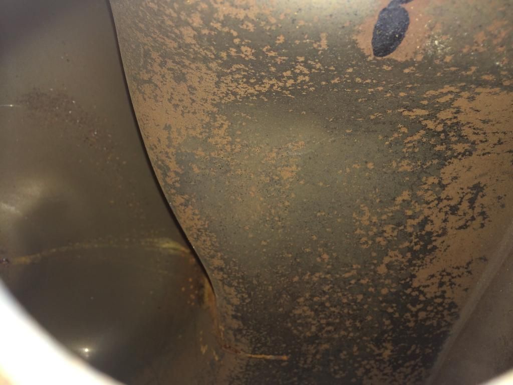

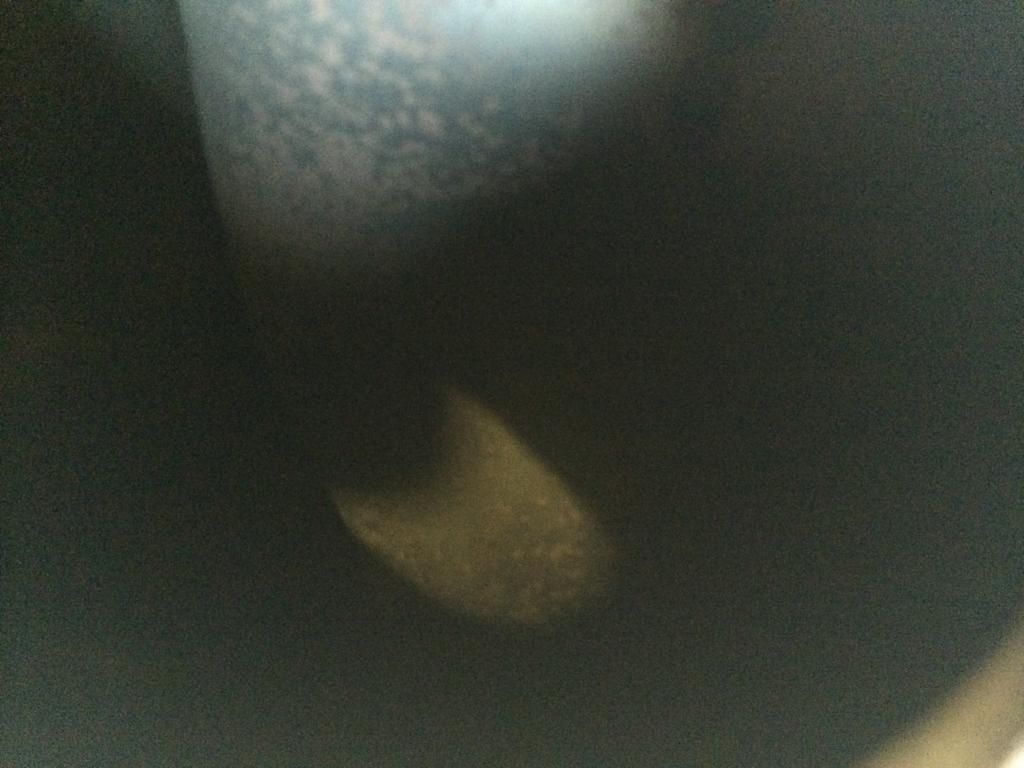

here is some pictures for you all is it savable? the inside has slight surface rust.
also can this be taken of or is it fixed constant? what does it do?
thanks tom

I looked at the additional pictures in your photobucket folder.  That appears to be an early (pre-1965) tank.  Is the car also of that age and what about the gauges?  I ask because your decision about fixing the tank will depend in large part on how original you want the car to be and what components you have for the fuel sending unit and fuel gauge.  I will explain more (if you wish) once I know what you have for a gauge and sending unit and what your intentions are for the car.

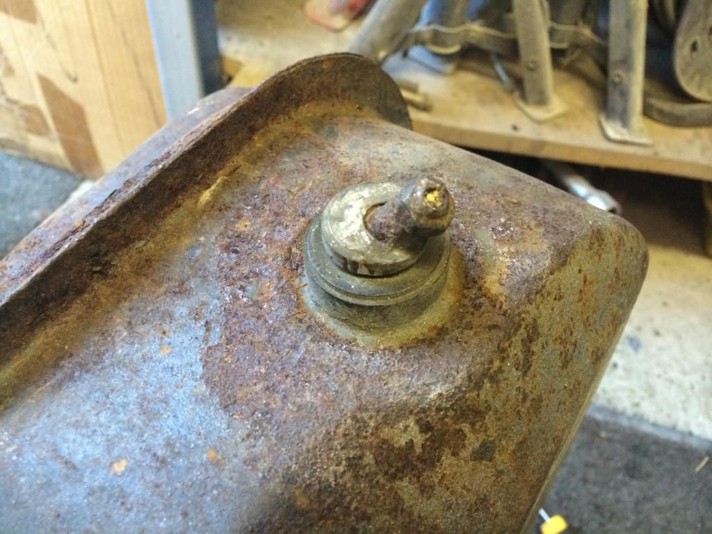

cheers all hoping to get it sent of next week sometime. what is that pipe thing underneath the tank tho? do they unscrew or are they fixed? thanks tom

Early mk1 cars had a drain fitted. I think this is it. Was a screw plug, with a tube on with a corresponding rubber bung in the boot floor. Reckon that's what this is, with the pipe bent (and rusty) and the rubber bung attached.
Not really required? So if you remove it and weld a patch over the hole it won't be seen when installed.

thanks for that dont suppose you no if i can buy a new one to fit on the end? and if i cant shall i just leave it as it is and try and clean it up? thanks tom

Hi tom.... I would just strip the paint off , I used a 2k scratch resistant paint on mine then polished it up.... To be honest the inside doesn't look that bad buddy.... For piece of mind you could always line the tank and frost restorations in Rochdale do these as I've done many a monkey bike tank with great results
